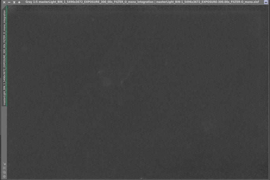

I recently collected some data on the Squid nebula and am underwhelmed with the result so I'm wondering if I'm doing something wrong. Here's the specs and the result: ZWO FF65, ASI183MM Pro, ZWO 7nm Oxygen filter 78x 300 second subs (6.5 hours), 120 gain, Bortle 5, no moon Very basic & quick processing to see what the signal was like: Graxpert, BlurX, StarX, STF stretch I've had a chat with some friends and the following suggestions came up. I'm not convinced that any of this would be beneficial though: Use a camera with bigger pixels like the 533 or 2600 as the pixels will collect more photons Use a 2x Binning Someone also suggested that unity gain for the IMX183 is 400 - I'm fairly sure this is incorrect & unity gain for this camera is 120. I do understand that this target is incredibly dim and I have no problem spending 50+ hours on such a target, especially when using a fairly small aperture scope but I want to make sure I'm not making any mistakes in data acquisition before I devote so much time to it. Thanks in advance for any help or advice!  |

Craig Dixon: I do understand that this target is incredibly dim and I have no problem spending 50+ hours on such a target, especially when using a fairly small aperture scope but I want to make sure I'm not making any mistakes in data acquisition before I devote so much time to it. *You have far too small pixels for the aperture you're using. 1.2"/px is something I'd go with this subject with a 6" not a 2.55"! And I can easily pick it up with a L-ENH filter in my B6/7 skies in 4 hours.

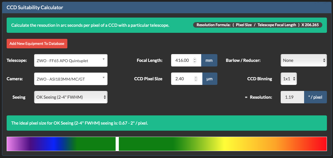

And I can easily pick it up with a L-ENH filter in my B6/7 skies in 4 hours. Would you mind expanding on this please? Here's what I get from CCD suitability calculator:  I do have a 533MC Pro but this is paired with my Skywatcher 190MN
Craig Dixon: Use a camera with bigger pixels like the 533 or 2600 as the pixels will collect more photons Use a 2x Binning Someone also suggested that unity gain for the IMX183 is 400 - Bigger pixels will, of course, collect more photons, but simply because they have larger area. They don't change the number of photons incident per unit area which is purely dictated by the f number. So, binning will have the same effect. Also, there is nothing special about unity gain. Using a gain of 400 is absurdly high and unnecessarily cuts FWC for little benefit. From the graphs, gains of 100-150 are probably going to give you all the read noise benefit you could get. I suspect your fundamental issue is just time.

I do have a 533MC Pro but this is paired with my Skywatcher 190MN In your conditions and with such a small aperture for the given focal length you need a LOT more time and long integrations to budge it above the sky noise in any significant manner and I suspect you haven't got that much time, especially now, given the usual constraints of the UK weather.
Run some graxpert ai version 3 denoise on it.

Craig Dixon: Use a 2x Binning Binning 2 should help and won't compromise resolution; those pixels are already vey tiny - gain 120 should be good and try 600 sec subs if you're able?
CMOS binning is no binning at all.
Thanks for the advice from everyone. There are a few conflicting opinions though so I'll start at the beginning and with what I feel is probably the most fundamental: Am I using an incorrect camera for the scope? I have two setups so two possible combinations for each:
Cameras: 183MM Pro and 533MC Pro Scopes: ZWO FF65 and Skywatcher 190MN
Currently I have the 190MN with the 533MC Pro and the FF65 with the 183MM Pro. Would I be better off swapping these setups?
600 seconds shouldn't be a problem with the FF65 as it's on an AM3, which tracks very well.
Both cameras give approximately the same FOV for each scope (but with very different image scales). The IMX533 one will collect ~2.5x more light per pixel (minus the light loss due to the RGB on-chip organic filters, around 10% to 15%). The 190MN will collect around 7.5x more light than the 65FF (inclusive of verious light losses here). Since the target is very dim the best choice would be the 190MN with the IMX533 but its FOV wouldn't be large enought to capture enough of the surrounding nebula. My take is that the next best option given the absolute field constraints is to put the IMX533 on the 65FF with the catch that you need to use a NB filter. The L-ENH would do because it's very good in the OIII band which you want to enphasize even at the price of some resolution loss.
