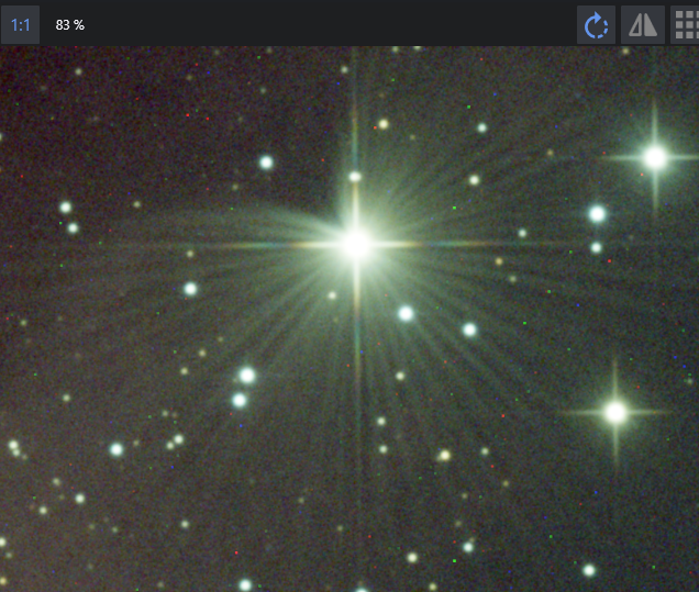

Hello, After removing the clips on the primary miror of my 300 F/4 I got rid of the 3 shadows at 120° but I have now noticed this, only on the brightest star of this image! 300s with ASI533MC Quattro 300P/F4, no miror clip... Any idea what the issue is? Thanks, Cedric  |
Could be caused by a turned down edge of the mirror. If you can, install an aperture mask of maybe 1/2” to test and see if it goes away.
Before you go masking the mirror and reducing aperture why not do a simple star test. Here's a page that shows you how. The turned edge case is at the bottom of the page.
Does the focuser drawtube obstruct the light path when in focus? This shadow could be from this as well.
Fitting a primary mirror mask will hide much of the halo you have around this bright star, and might hide the shadow you have here now. The 3 shadows you saw before getting rid of the clips were there because that part of the mirror was hidden, so the turned down edge effect was hidden at those points. Using the same logic a primary mirror mask that reduces the aperture so that all of the edge is covered by the same amount the clips were covering would clean up much of that halo. Definitely recommend fitting one.
Thank you all for the good advices. The focuser drawtube doesn't obstruct the light path at all. I will try adding a miror mask and see if it fixes the problem.
Let see if I can find a model that fits my miror.
Clear skies, Cédric
Bright stars can also show artifacts if your focus is slightly off, especially in fast scopes like your F/4. You might want to check and fine-tune your focus to see if that helps.
Again, It's very unlikely that a turned edge is the cause. It really looks like a diffraction effect. You could get this from a rough edge, or one that wasn't smooth before the coating was applied. Yes, a mask would fix this if it has a clean edge. Just remember that most of the light collecting area of a mirror is near the outer edge. You could easily reduce your area by a significant percentage with what looks like a narrow mask. If you do apply a mask make sure it has a smooth edge and intrudes into the mirror area as little as possible.
