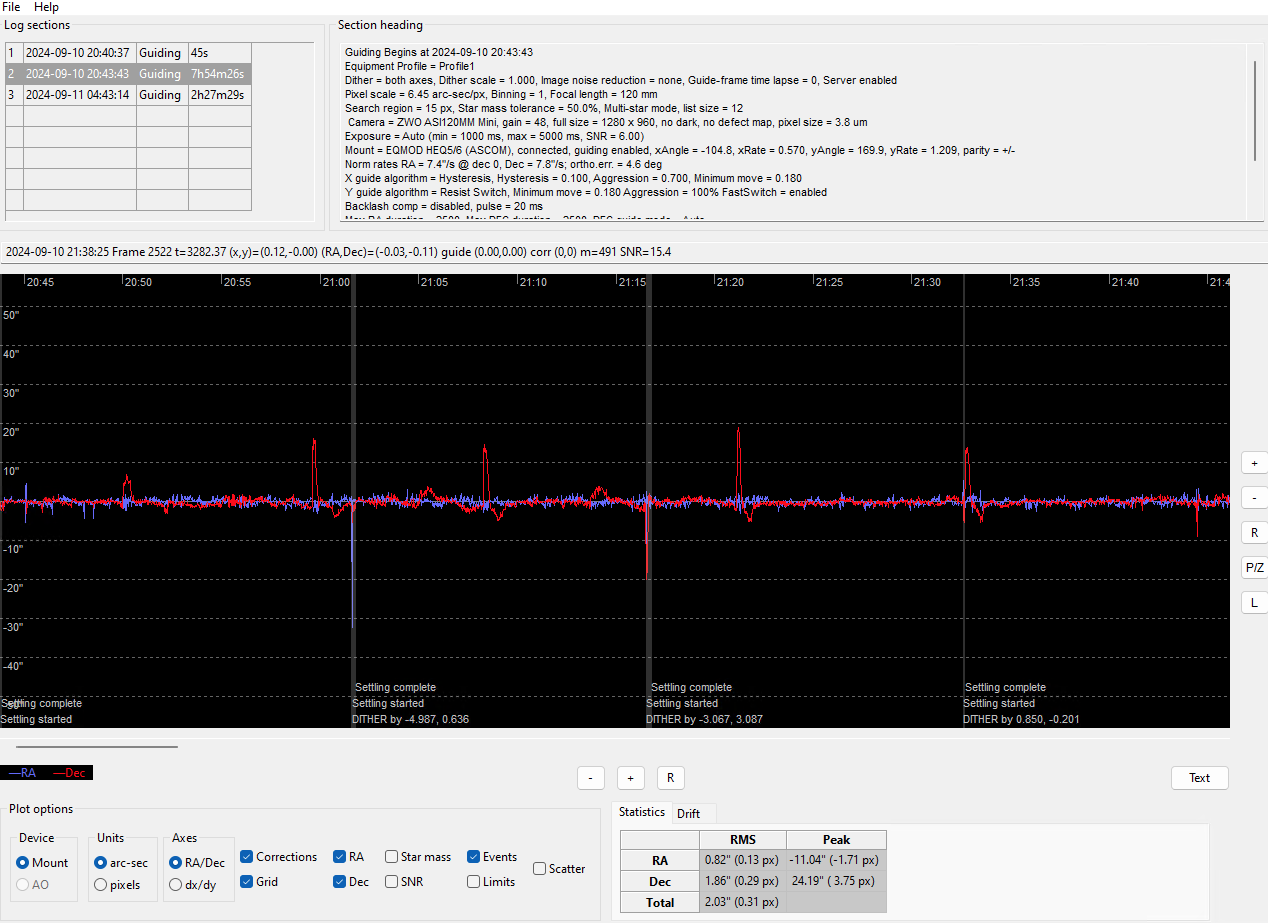

I've been given a belt modded EQ5 Pro mount and am trying to get up and running with a second setup. The attached screenshot shows the guide log from last night. Guiding was mostly good but I was getting these regular massive spikes throughout the night (Some are on dither points but others aren't). As a result, I had to delete a lot of subs due to double stars, as though the mount had jerked half way through a sub. There was no wind last night and the mount was very stable and well polar aligned.
Had anyone experienced this before? I'm not sure where to start looking.

Cable snags or slippage come to mind. Additionally, damage to a gear is possible. If you transport if with the clutches locked you can damage the gears. Even putting the scope on roughly can make marks on the gears. I'm not sure which spikes are dithering, but if it's periodic, then it might be gear-related. Maybe others a lot more knowledgeable will chime in.

You said regular – do some math, see if it really is regular, like a worm period multiple.  Also compare to a log of imaging, does it follow any event like a filter change (especially if using an OAG and using filter offsets without a stop/start guide).   Other possibilities include wildlife - a bird (e.g. owl) stopping by.  I've literally had a tree frog jump onto, and then off the OTA and you get a blip.  Cable snags and such have been mentioned, I had one of those "armored" USB cables (plastic rippled wrapper) and found it left a little vibration every time one of those ripples was pulled over a spot on the mount.
Those are pretty big and always in DEC (right?).   DEC sudden excursions won't be caused by tracking errors, it generally requires something intervene and move the axis.  I guess it could be the mount responding badly to a small DEC move and making a giant one, but I'd look first for external causes.
On a second thought it looks like cable snag, tension builds in for a while (with quasi periodicity) and then it shifts and then it repeats again. Happened to me a long while ago. Now I always check that the cables are free to move wherever the scope is pointing.

That's the declination trace, it won't be anything related to the worm period simply because the dec motor doesn't have one – it isn't always running. Cable snags seem the most likely culprit.

I do find it interesting there isn't much RA impact at the same time.  That's kind of a wimpy mount for a cable tug to have that much DEC impact without affecting RA at all.  It makes me wonder if something is literally sliding/moving as the OTA's angle changes. Notice that's over 7 hours of time.  If it's something with freedom to move (very slightly) only in DEC.
Was the DEC axis very well balanced?  A related possibility is if as the angle changed the effective tension on the DEC axis overall changed and there's a tiny bit of give somewhere that occasionally slips?    or related, if there's a big temperature change over that time, dissimilar metals in (say) a dovetail plate and long OTA might result in periodic slipping in rings as one grows faster than the other (ok, that's grasping a bit at straws, but when dealing in arc seconds everything is made of rubber -- that's the saying right).

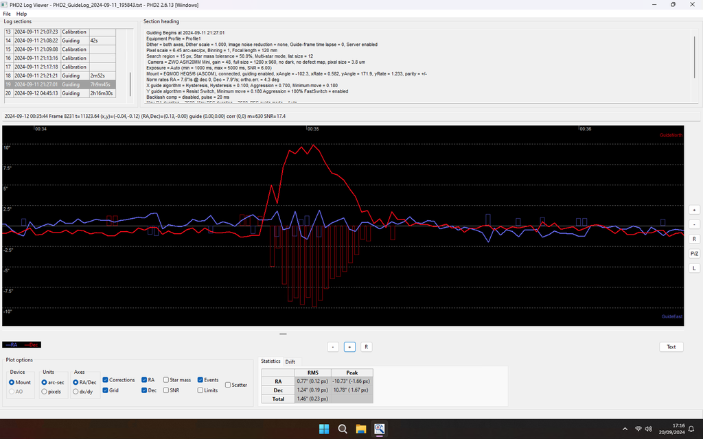

This is a close up look of what a typical spike looks like. The dec axis quickly moves off, the mount tries to connect but can't. I'm wondering if it's backlashScreenshot 2024-09-20 at 17.16.28.png

It looks like a textbook case of static friction (stiction) to me. PHD2 is commanding a series of North corrections that don't seem to have effect, then all of a sudden the cumulative result takes effect, and PHD2 takes some time to bring it back under control  with a series of South corrections. This series doesn't result in an overcorrection because static friction is already broken, so PHD2 only needs to take up the slack due to backlash.

Backlash is usually shown by repeated pulses being unable to correct an excursion, so I get what you are saying, but the problem with that theory is that the excursion itself seemed so sudden and large.  I don't see how backlash per se could be the cause, though having backlash comp disabled may be the reason it took so long to recover (for a belt drive without encoders I expect you have substantial backlash innate in the system).
It's certainly worth turning on compensation (unless it's off for a reason?) and running guide assistant to give it a starting point.
But I still think it likely there's something loose in the direction of the Y axis that periodically slips (or something akin to that).  Keep in mind 10" is probably so small if you were watching carefully when it happened  you couldn't see it by eye.  It's large as an error, but small as a physical motion.  The fact that the RA axis keeps on tracking well (if that's true in all these cases) seems to exclude some external impulse (wind, something bumping the mount, etc.).  I would still think it's something in the drive itself (where that last pulse instead of a slight motion did a very large one), or something loose where when you hit a certain balance or weight distribution it just slips or flexes a bit.
 I just read @Franchesco's note.  I'd agree (e.g. where I said "instead of a slight motion did a very large one"), except that it wasn't really trying hard to move in DEC before hand.  It may be worth looking carefully at each one, see what the last few intervals of DEC looked like before the spike.

It may be worth looking at what happened before the beginning of the portion of log shown, if Craig can. Have many North guiding command accumulated, without apparent effect? That would've built up the elastic energy that then released suddenly.
Dithering in the presence of backlash also shows in this way, but Craig said there's no dithering here.
