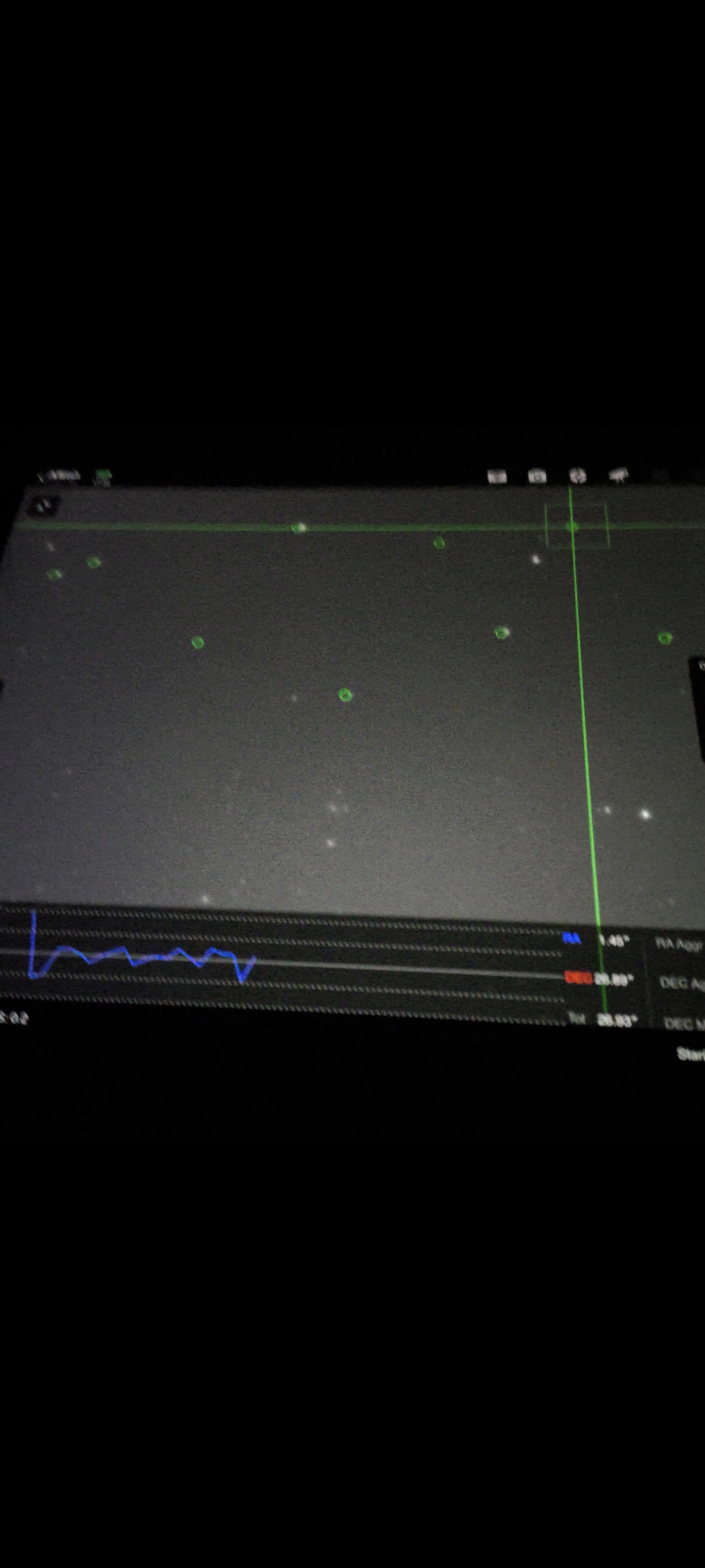

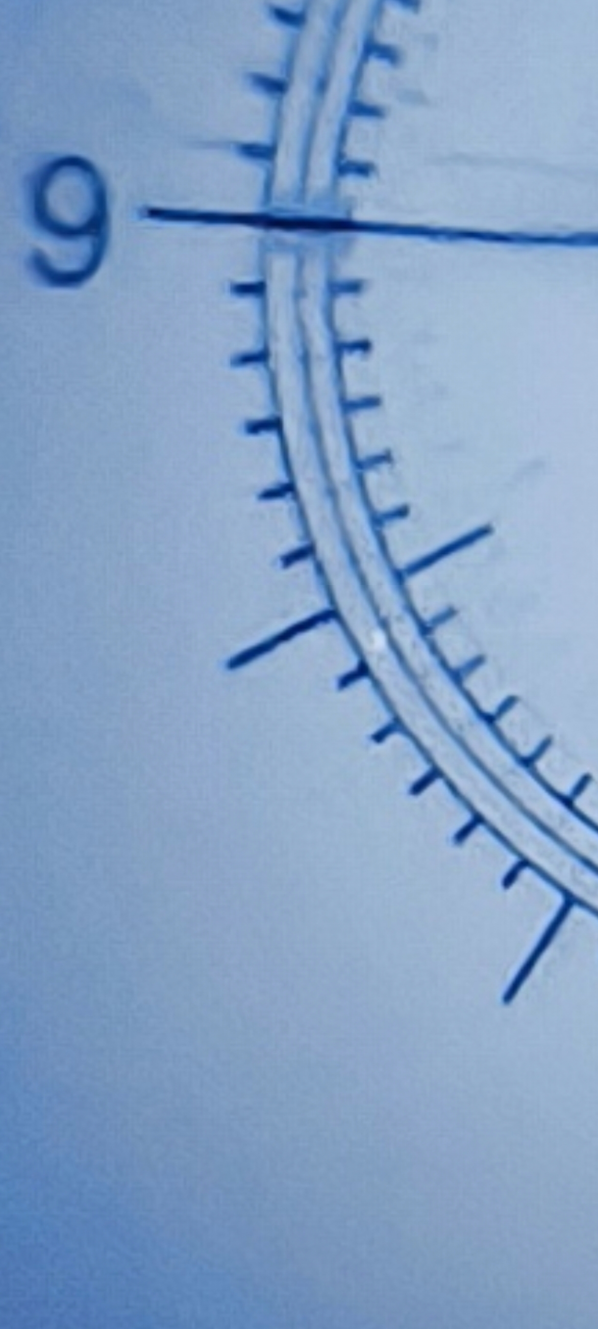

Hey everyone, after several attempts to figure out why I keep getting star trails and what's wrong with my alignment, I’ve decided to ask for help here. I’m trying to polar align my EQM-35 mount using ASIAIR. First, I manually aligned it using the polar scope, placing Polaris exactly where the polar clock indicated. After that, I checked the polar alignment with ASIAIR, and the RA/DEC error showed:RA: 00:30:00DEC: 00:05:00 I have no idea how this happened. Anyway, I tried using ASIAIR for polar alignment. When I moved the mount left or right, the up/down axis would also change—and vice versa. Eventually, I managed to complete the polar alignment, with ASIAIR showing:RA: 00:00:05DEC: 00:00:10 But when I slewed the mount back to the home position and checked the polar alignment again, the error values had changed to:RA: 00:30:00DEC: 00:10:00 Next, I slewed to a target and started guiding using my guide scope. After calibration, the guiding started, but I noticed the following: RA: Initially climbed to 10° and then stabilized between 1.0 and 1.3.DEC: Climbed to 50–60°, then stabilized around 1.8. Sometimes, the DEC would suddenly drop to 10–30° for a few seconds before returning to normal.I’m confused about what might be causing these alignment and guiding issues. Any advice would be greatly appreciated
Screenshot_2024-12-19-16-57-18-215_com.astrotools.polarclock.jpgScreenshot_2024-12-21-13-37-29-657_com.miui.gallery.jpg

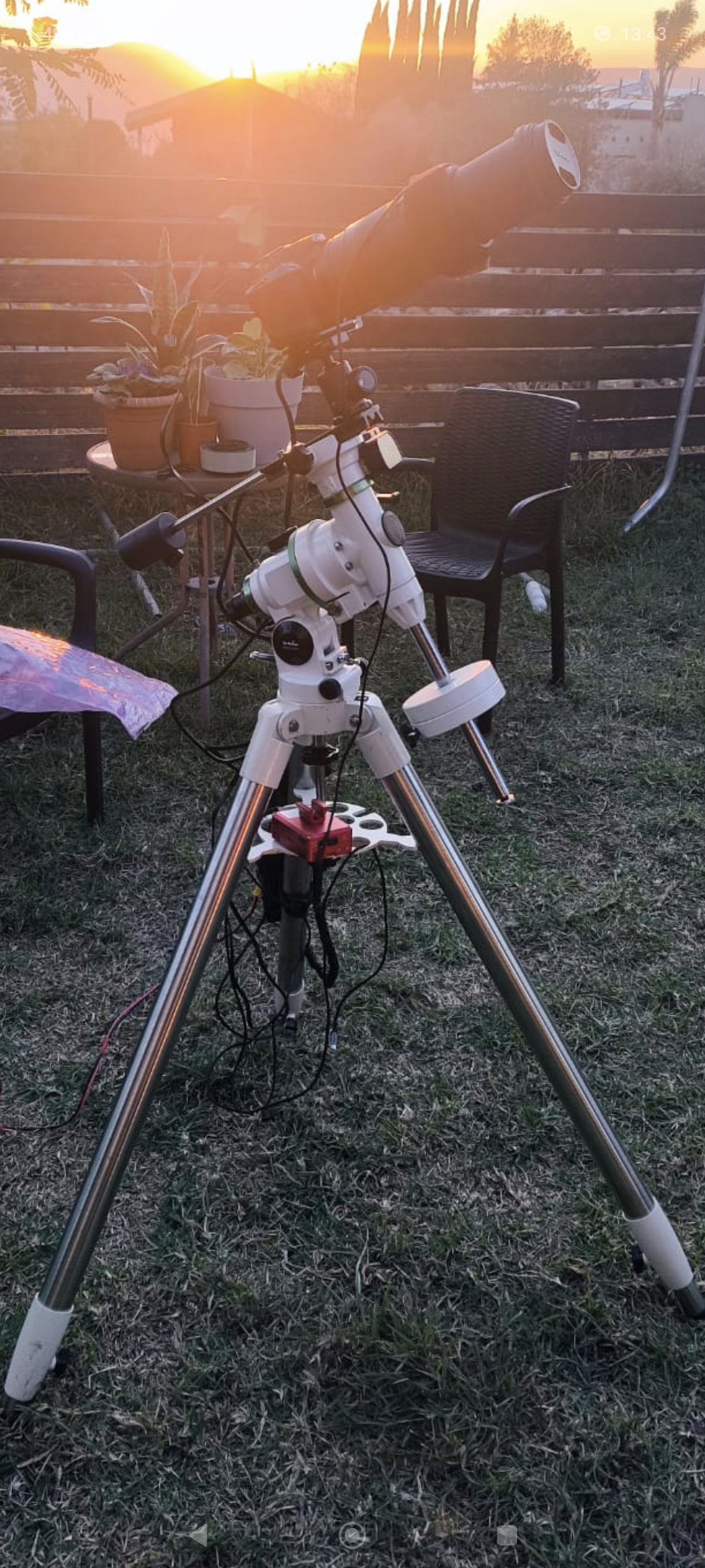

That is my rig
