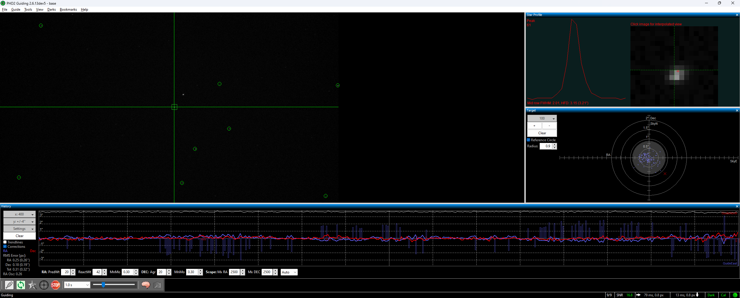

Was out trying this last night  and not having much success. Found that so far defaults 1.0 sec calibration worked best.  Ran into the following from Pegasus that gives a detailed recommenation of phd2 settings for calibration and guiding exactly for strain wave mounts.
https://pegasusastro.com/nyx-101-guiding-recommendations/
Had a go at Predictive PEC as per their instructions and found it promising. But seeing was not good at all and regardless what I tried there was a good deal of Texas throughout the night.  One thing I noticed, for those of you who use Predictive pec, is that if leaving the auto period update check box on, my initial 288 value for my newer AM5 steadliy got reduced over say 20 minutes of guiding all the way down to about 75, and then started to rise slowly again before I decided to stop and read some more before continuing with that algorithm. Dont really know how to interpret this behaviour yet... seemed like PHD2 was getting confused with my mounts particular period.
