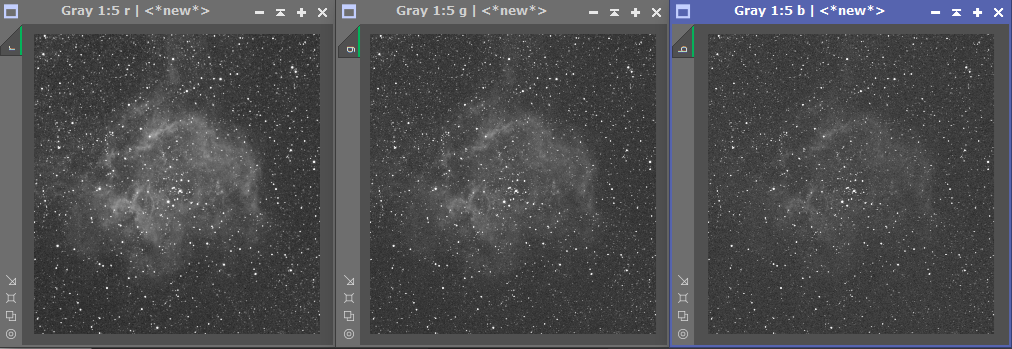

If you want more blue in nebulae, always do an unlinked stretch. Either L-Ultimate or Enhance capture a lot of blue, but if you stretch linked you won’t see it

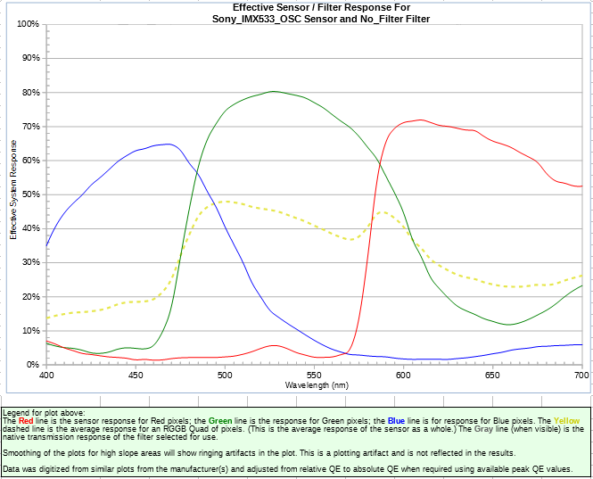

That's just not correct. Any narrowband filter can be used for OSC, whether it's dual or single. Choosing a dual band, you can make use of the OSC Bayer array (mind the channel mixing!), and if you use a single narrow band filter you should consider that you probably can only utilize one of the 3 color channels. I would strongly suggest to get a single SII filter and not mixed SII filter.

It's complicated 😬 The Dual narrowband filters for OSC are great, but they don't give you true narrow band due to the overlapping transmission regions of the color filter array. SII and Ha from the red channel will always bleed into the Oiii signal in the green and blue channel and vice versa.  And mixing the Oiii signal from 2 filters with different bandwidth is a whole different story. Different SNR and contrast and different mixing with SII and Ha. In the end, both ways will work, but come at different advantages and disadvantages. If you take the SII single narrow band filter you can later use it for a mono camera and at least your SII data is clean  For reference, these are the RGB channels for the Rosette Nebula with my Sii filter

In all the threads i read on the subject, it seems that ha and sII with mono filters will get poor amount of signal on an osc, giving the fact that only 25% of the sensor will capture it (in the red channel). Seems logic, and backed by many threads. Did i miss something ?

I strongly recommend Raul Hussein script for narrowband processing too, its simple and very efficient. A single and dual narrowband filter will give you exactly the same signal on the same OSC sensor for Ha/Sii/Oiii if they have the same bandwidth and if you disregard channel mixing. Using a OSC will not give you 25% of the signal, you will use 25% of the sensor to reconstruct the whole image using the debayer process. This will result in reduced resolution/increased noise compared to using a mono sensor. The signal in those 25% is reduced due to the filter array transmission to 65-80ish% depending on which channel and camera is used.
