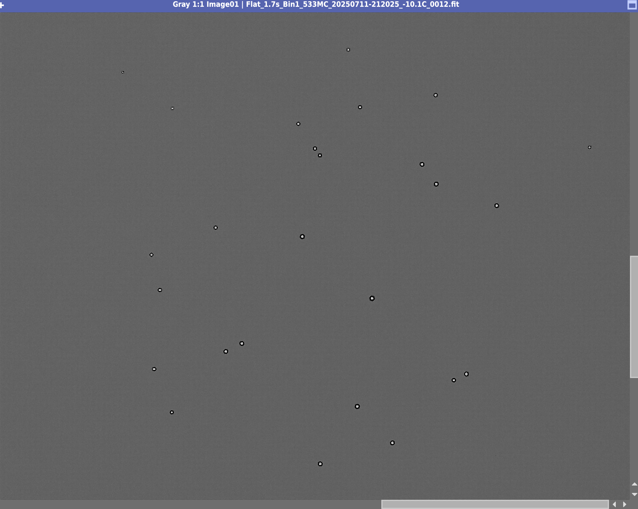

Has anyone seen anything like this before in flat frames? This is a single flat with an STF applied and I have these speckles on one side of the sensor. I've tried a number of different exposure lengths as well as twilight flats and using a flat panel.Screenshot 2025-07-11 at 21.39.58.png
ice crystals, possibly.
Wjdrijfhout 6.78
Looks indeed like condensation on your sensor. If you look closely, you will probably find them on your lights as well. Turn off cooling for a bit, until they're gone. Then turn cooling back on but try to cool down very slowly.

Willem Jan Drijfhout:
Indeed and alternatively, letting the camera stabilize at its cool down temperature for 15-30 minutes before imaging can help with icing.

Look like stars to me
craigdixon1986 3.01
That's it thanks guys. It was dew. problem solved.
