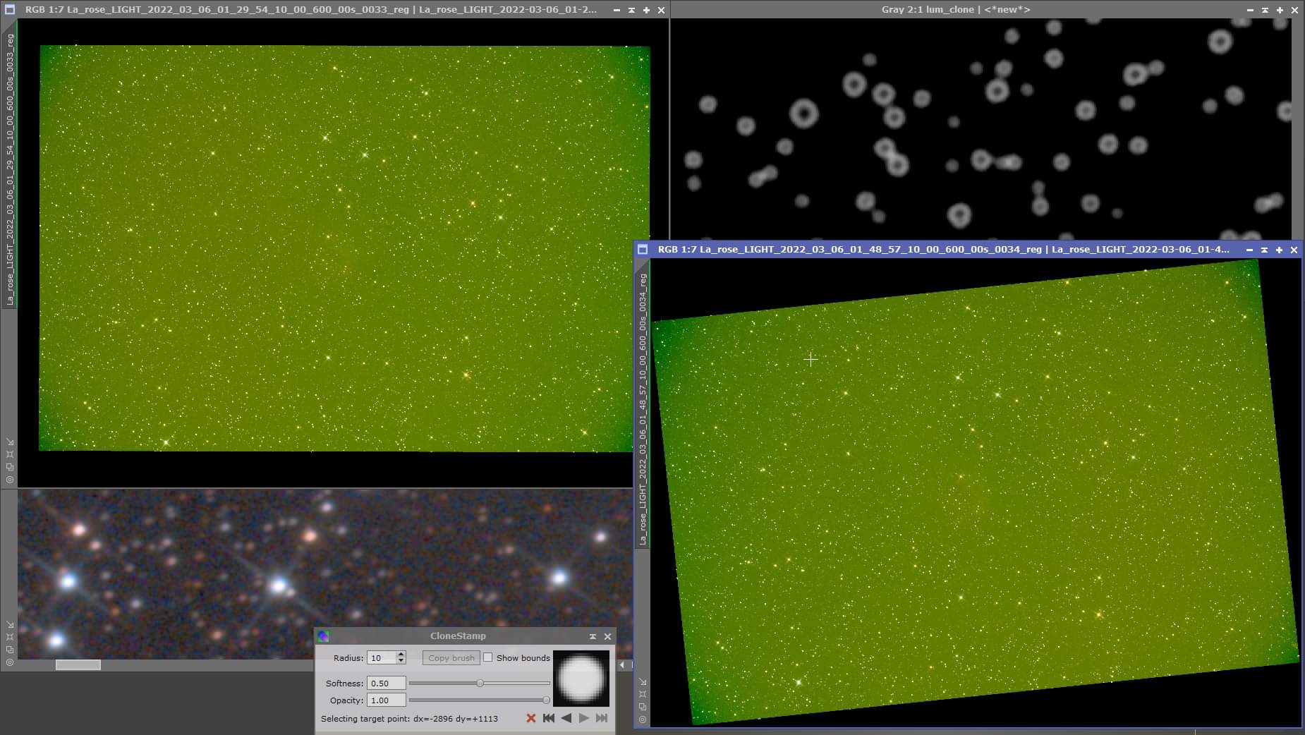

Hi, I know this is an old thread, but I have this issue with 20 hours of Iris Nebula data. Polar alignment was always under 1‘, mostly in the low 10“/20“ during the sessions, the spider vane is a fixed aluminium ring from Backyard Astro, is this possible to fix in post processing? I have BlurXterminator, StarXterminator and PixInsight so I hope this is fixable… 🥲 Because otherwise the data is perfect
Cone error. After registering all the frames use only one subset with uniform spike orientation for the stars and add to the starless version.
minyita 1.81
Mina B.:
Thanks, I‘ll let the nights stack seperately as well then, or do a seperate stack with alright stars! Would be a pity to waste that amount of Data, 20h on Iris in Bortle 3 are quite something

Mina B.:
It doesn't matter if the star removal leaves no trace of the spikes. Just create a stack with your best stars all with the same spike orientation. And use the stars from that stack, rememberin to use it as the reference frame when you add all of them together.
