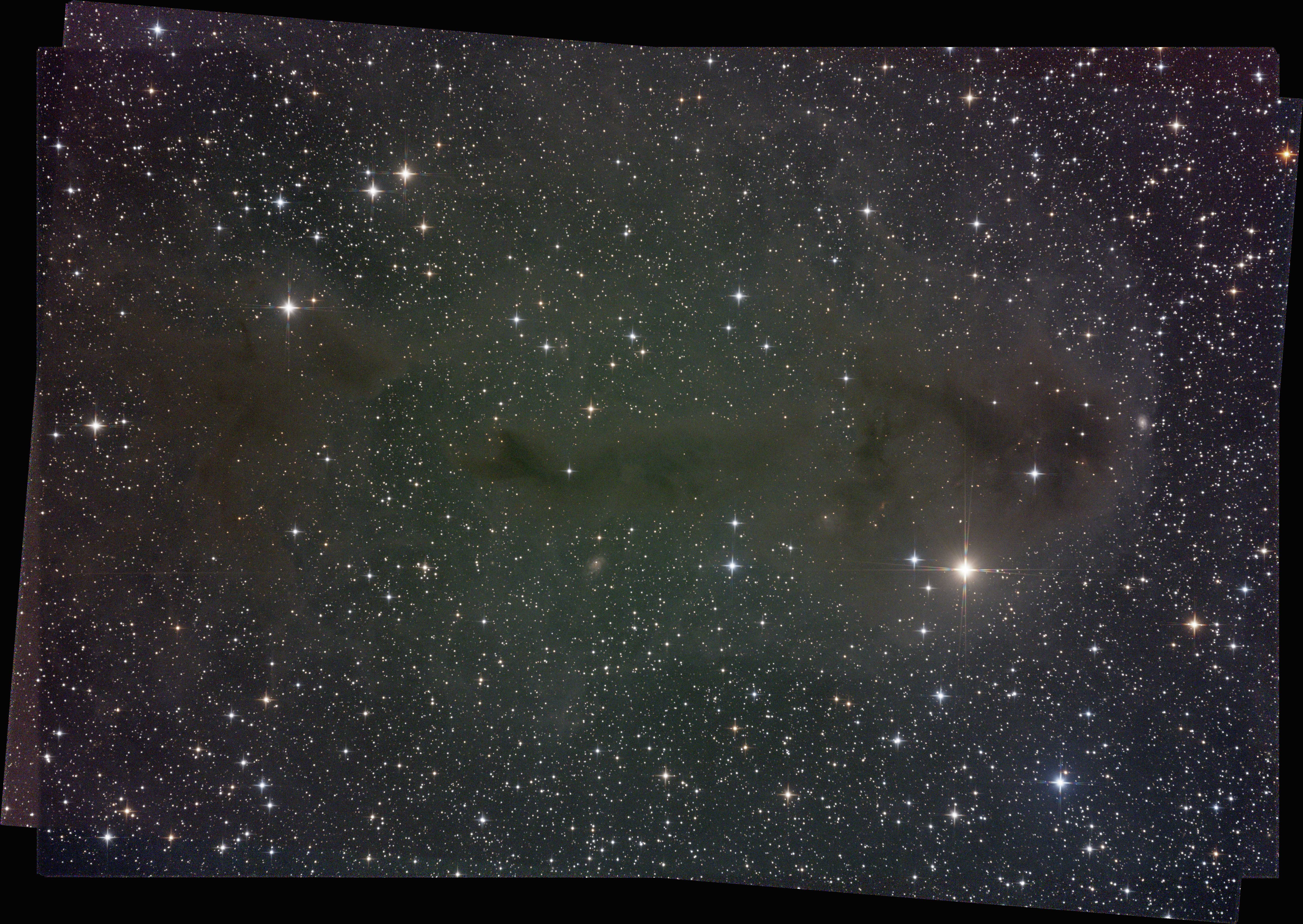

Is this due to the fact that we track in Ra and Ra tracks in a circle? With a larger angle of rotation the effect would be most noticeable at the poles. Polar alignment would contribute but even with perfect alignment you still have that larger rotation.
Have a look at my 3 panel mosaic of the Iris Nebula and notice the diffraction spike angles in the left panel and the right, quite a large rotation and the wider the field the more obvious the angle becomes.
On second thought most likely different to your issue. Wim's response makes sense and cone error might explain my rotation too.

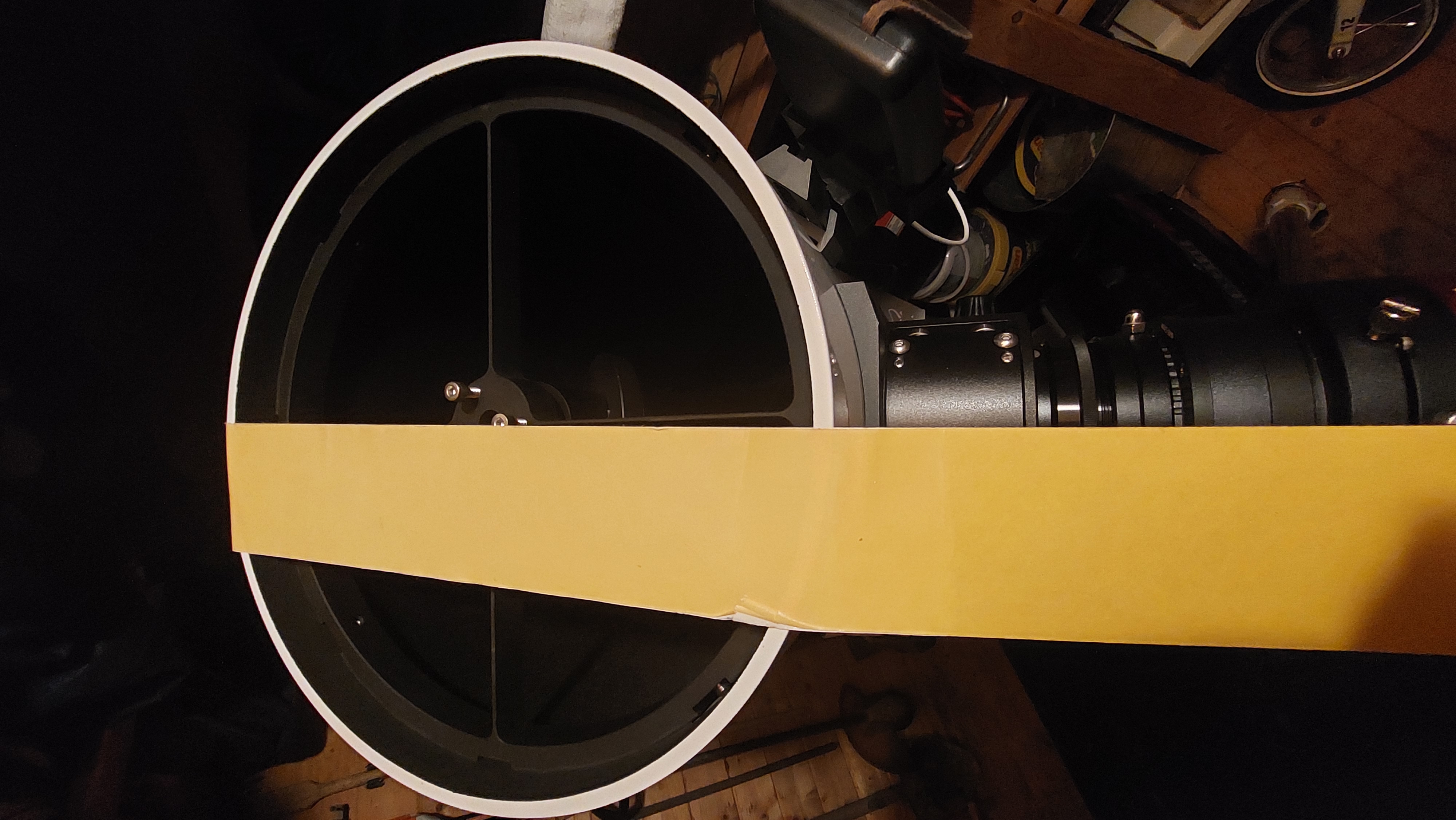

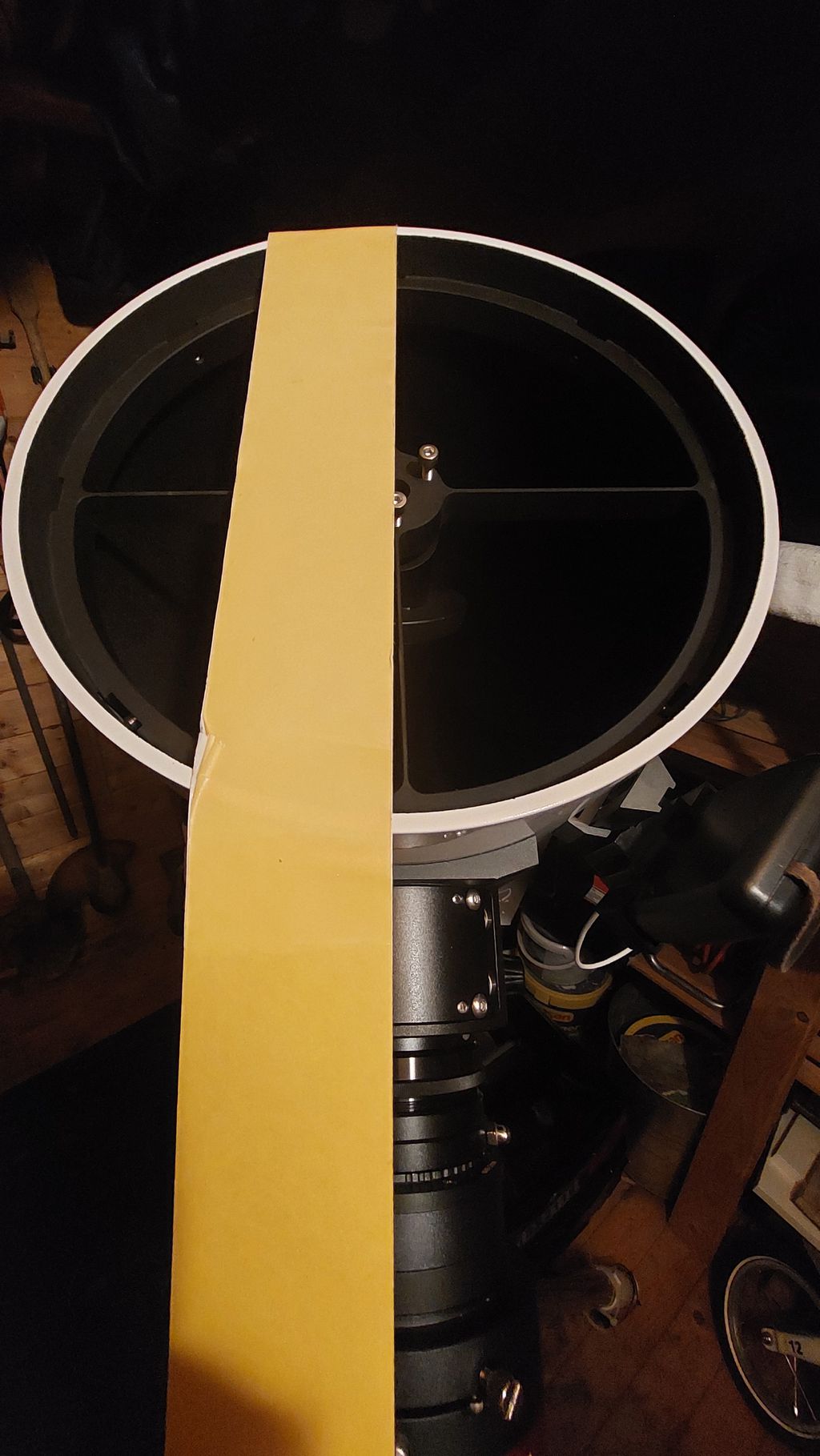

A friend had the exact same problem after a flip, with a rather expensive  brand new truss Newtonian. in his case the solution was to re align the spider vanes. they were moved about 1 degree in rotation.
I've seen the data before and after, that solved it for him  completely.
jhayes_tucson 26.84
Ah…good one Dave.  Yes, the spider vanes also have to be symmetric about a flip!   Again, getting rid of the diffraction pattern is probably the easiest way to fix this problem when working near the pole.  The other "best" solution (that's not cheap or easy) is to get either a L-series or a fork mount to do away with the flip altogether.  I've become so used to my L-series mount that I'm completely frustrated with my new refractor on a Mach2.   The flips and dead spaces in the sky are maddening.  It has the most trouble pointing straight up, which of course is the best place to image!

Has anyone ever considered that the secondary mirror spider could be slightly twisted and asymmetrical. I'm having the same problem right now. with an image field rotation, the effect would have to be continuous and not suddenly with the meridian flip. I would be interested to know what you think of it.
If you have unsymmetrical spider vanes you won't need field rotation to see that.
MarcusJungwirth 3.01
Then I got it right. Thanks
