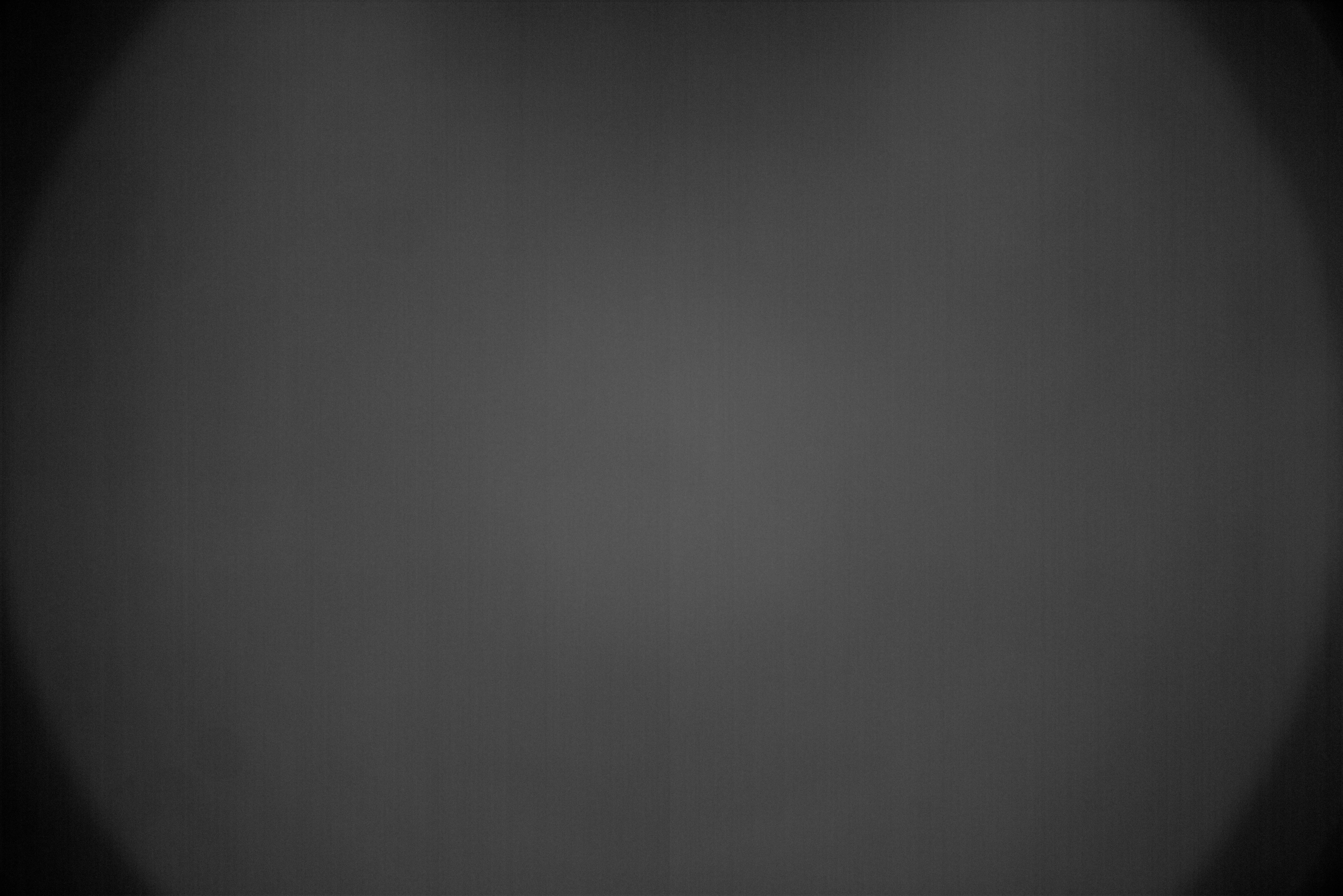

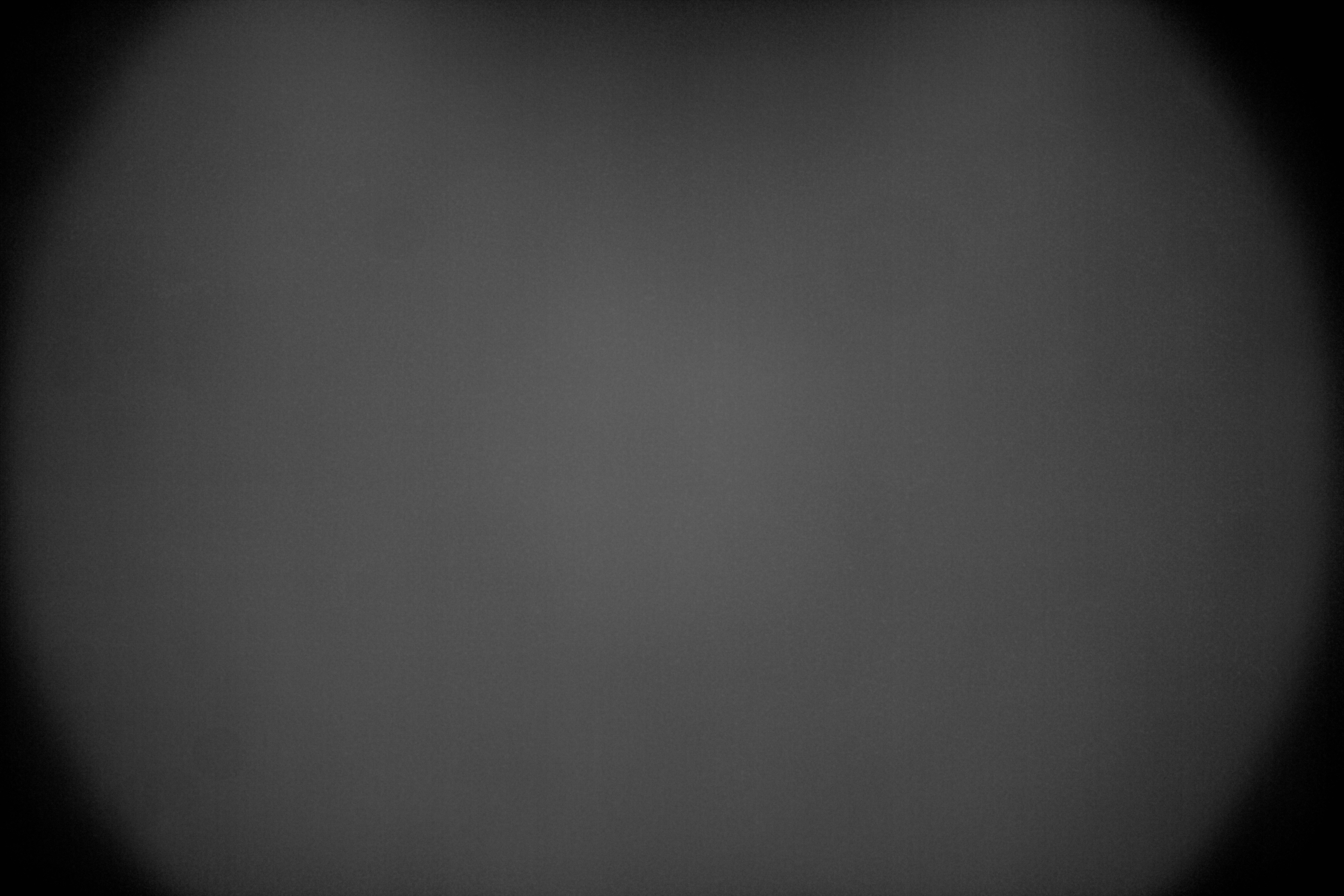

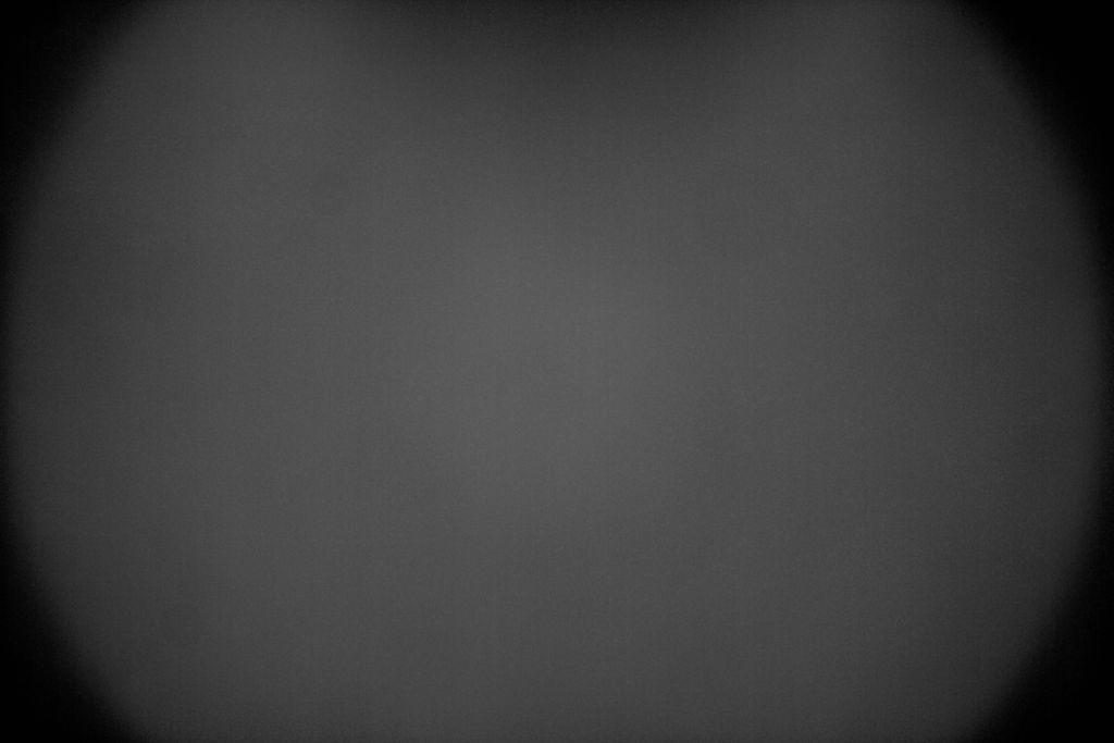

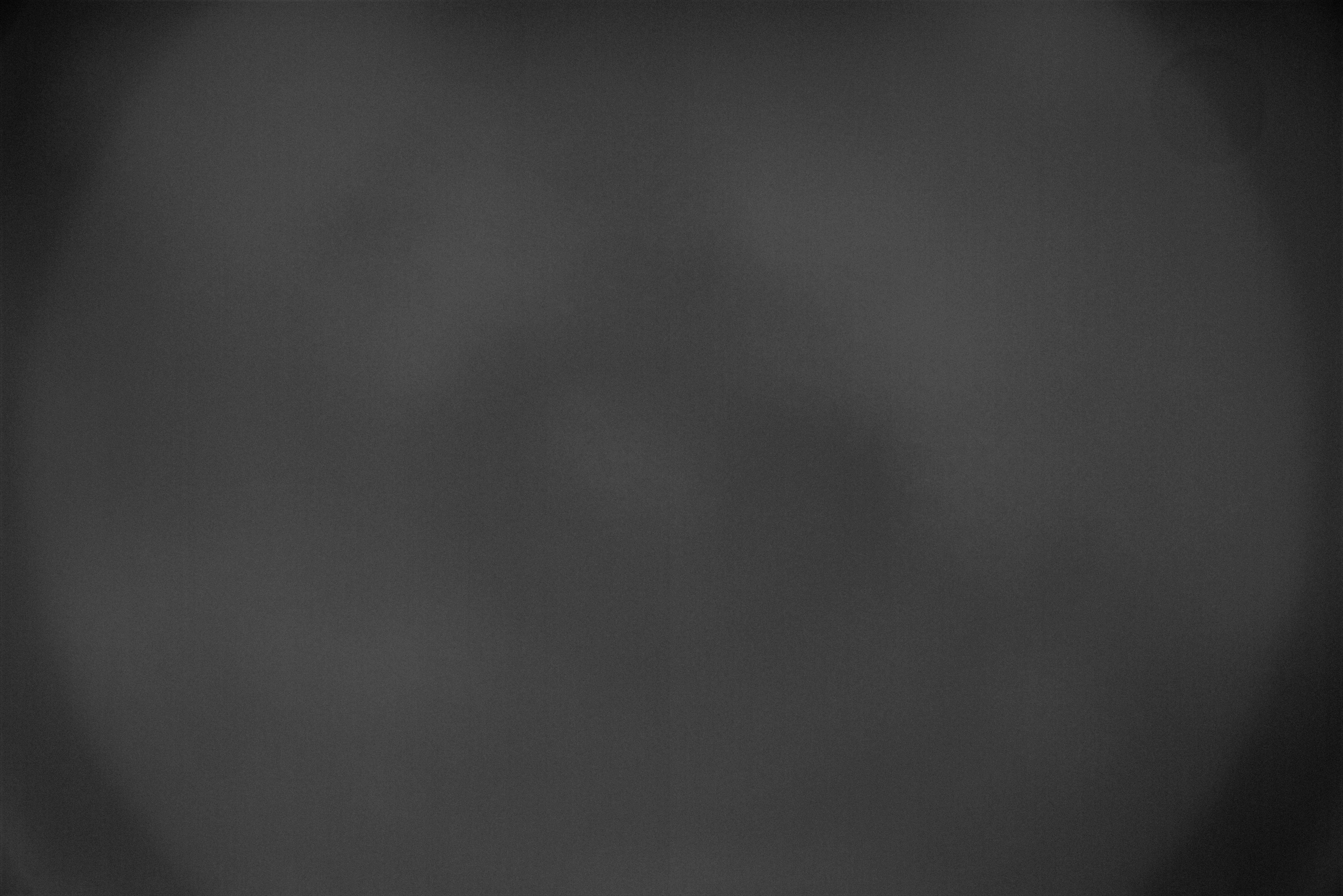

I’m seeing the same pattern on all of my flats: LRGBSHO (see pics below). I’m not talking about the vignetting or the shadow from the OAG prism, but rather the pattern that you can see in the Ha photo. The “smudge” is most prominent in Ha and Sii, but I can see hints of it in the other filters as well. (See pics for example flat images - L, H, O in order)
Equipment:
QHY600M
Chroma LRGBSHO 50mm filters
SVX102T telescope with flattener
QHY OAG
Gerd Neumann Aurora Flat Field light panel
I did the following troubleshooting process…
1. Rotated camera to r/o something in the telescope / flattener - Same pattern on flats
2. Cleaned  front of sensor AR window (thinking it was a smudge on the glass) - no change
3. Reversed Ha and Sii filter sides (the 2 filters where the “smudge” is most notable) (front -> back) in the wheel - no change
4. Moved Flat Field panel to different spots - same pattern
5. Tried a standard LED tracing panel and repeated taking Flats - same “smudge” pattern
The only remaining possibility that I can think of is that there is either a smudge on the inside of the AR glass window, or on the sensor itself.
Before I try to open up the camera and try to clean the inside of the AR window and/or the sensor (which really scares me), I’m checking in with the Astrobin community for help / guidance.

I was thinking about ignoring it (in hope of it calibrating out), but I was imaging around Gamma Cygni last night and noted a prominent (irregular) diffraction pattern around the star, that disappeared after a meridian flip. So I think the “smudge” was causing a reflection pattern around the star, and after the meridian flip the star was now projecting onto a different part of the sensor (where there is no smudge). This leads me to think that I need to address the issue, as I doubt the diffraction pattern will calibrate out.

I took the camera off the telescope and ran a flat with the panel over the camera. The smudge is not present on this flat, with the telescope removed from the equation!
So it looks like it’s a reflection from the telescope. I’m really happy I didn’t try to clean the sensor!

There is no smudge when the ASI2600MM is connected. Ha flat looks good. No smudge.
So the smudge only occurs with the combination of the QHY600M and the SVX102T. I could try connecting the QHY600M to a different telescope and see how that looks.
I’m going to run FBPP on last night’s subframes and flats and let you know how that turns out.
Speleodoc 1.20
Update:
I tried the QHY600M with an ASKAR FRA400… same, exact smudge.
So, my QHY600M shows the same flat pattern with the SVX102T and the FRA400. No smudge when not connected to a telescope.
GOOD NEWS  IS THAT I JUST RAN FBPP AND IT CALIBRATED OUT NICELY!!! 😃
So, it may be a moot point now, but I’m wondering how / why the smudge pattern shows up when connected to a telescope, but not when the flat panel is placed on the imaging train when disconnected from a telescope? I’m also wondering if anyone else with a QHY600M notices this issue?
