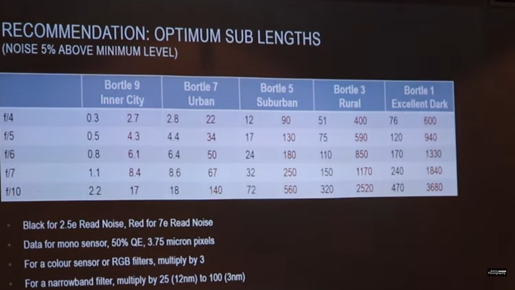

ScottBadger 7.63
In this presentation by Dr. Robin Glover (Sharpcap), https://www.youtube.com/watch?v=3RH93UvP358, at about the 50min mark he shows an exposure length vs f-ratio chart for different Bortle values at a given read noise. The shown exposures lengths are for luminance, but it's noted that exposure for RGB filters is x3 and NB, x25.
Cheers,
Scott
kevinkiller 2.11
F7, Bortle 7:  8.4 * 100 = 840 seconds!
okay, that’s probably about 3x swamp factor.
But look at F7, Bortle 1:  1840 * 100 = 184,000 seconds!!
That’s 51.1 HOURS per exposure!!!
F4 would be : 600 * 100 = 60,000 seconds or 16.666 Hours per exposure!
F2 isn’t on the chart but damn it looks like the only viable option for a B1 remote observatory.
 I’ve got to sell my C8 and get a C14 Hyperstar or RASA 36  if I want to shoot narrow band from a dark site.
gonna have to sell my house and live in a tent next to my telescope to afford that setup.
in the meantime I’ve got to start taking my 900 second dark library… that’s going to take about a week.

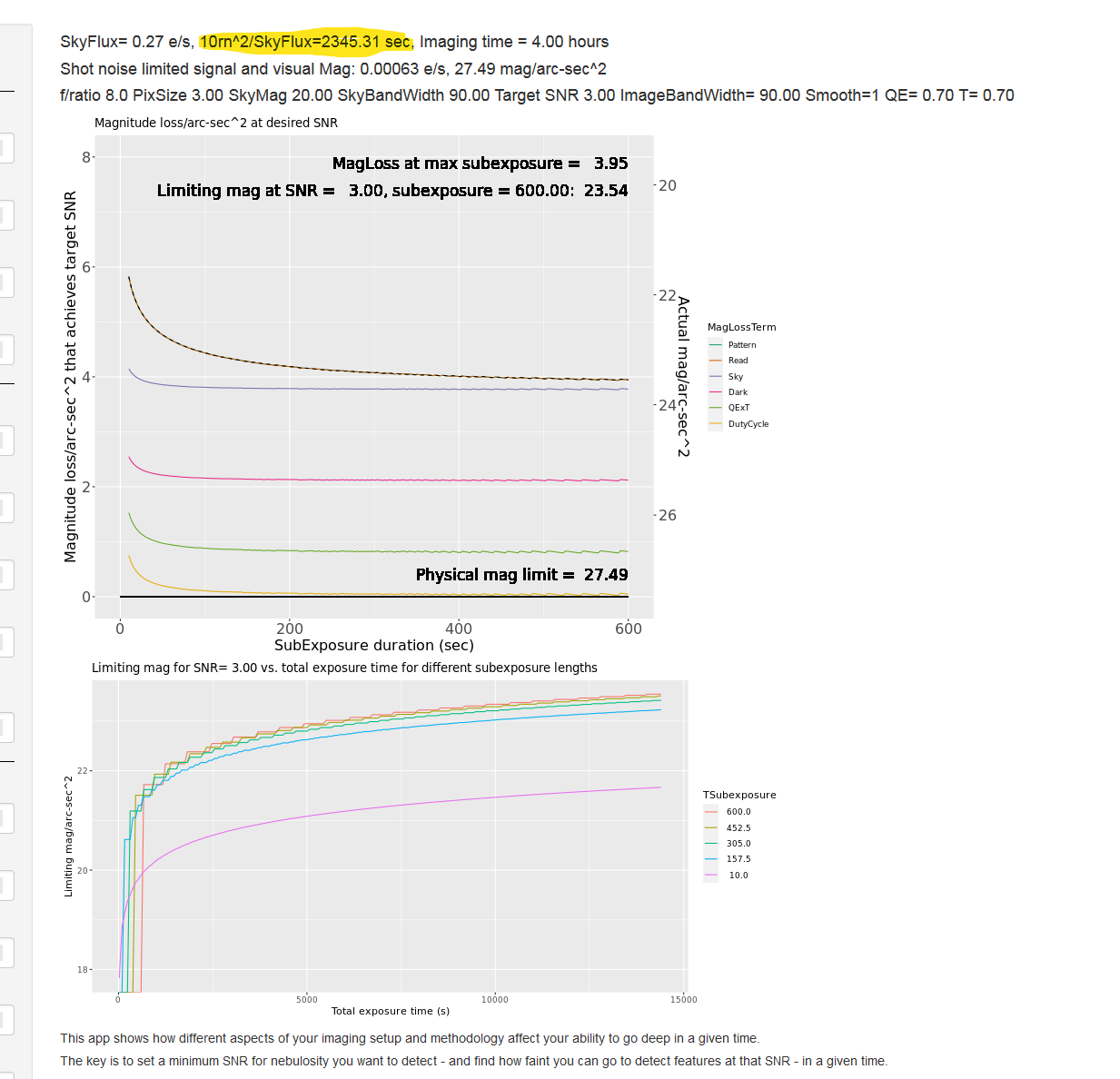

Emission 2.11
To get a rough ballpark figure I use a calculator for that: https://smallstarspot.com/shiny/StackSNR/
There you can calculate how deep you can go for a given time, additionally to that it calculates the swamp factor for you.
ScottBadger 7.63
John Stone:
Note that 1840s is for a sensor with 7e read noise. If your camera is 1.5e read noise, you're a little below 240 for luminance, or 24,000s for NB. Still, an unreasonably long exposure though..... fwiw, while pretty close to the chart for Lums and color, I shoot Ha at 800s, not 32,000s, and it seems to work fine.

kevinkiller 2.11
Tobiasz:
Can you explain the chart?  Where is the swamp factor?
Emission 2.11
John Stone:
Tobiasz:
Thats your 10 times swamp factor value depending on your imaging setup and sky flux:
Regarding the chart there is an explanation on the website:
"This app shows how different aspects of your imaging setup and methodology affect your ability to go deep in a given time.The key is to set a minimum SNR for nebulosity you want to detect - and find how faint you can go to detect features at that SNR - in a given time.If you have a perfect imaging system, then the SNR at each pixel will be determined by the shot noise in the image itself. This app calculates the minimum signal required - and its magnitude/arc-sec^2 - based on f/ratio and pixel size.Then other noise terms are added in - along with the loss of imaging time due to delays between exposures.You enter the camera parameters and the target SNR for the faintest detail - along with the total time of the imaging session - and this app will plot how much signal you are losing, in mag/arc-sec^2, compared to a perfect system with no noise."

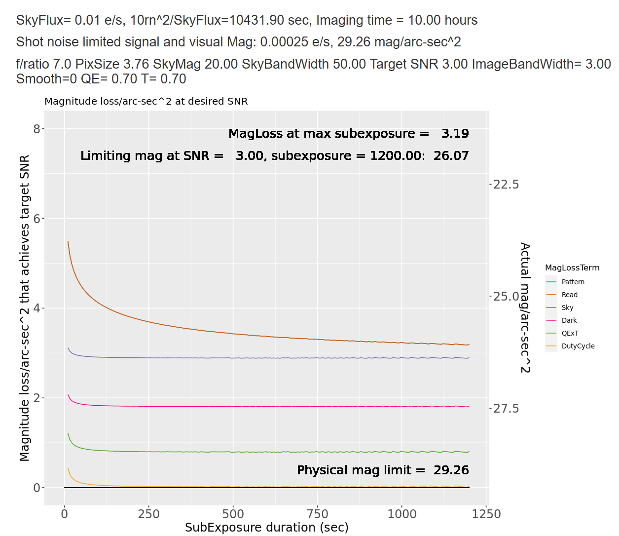

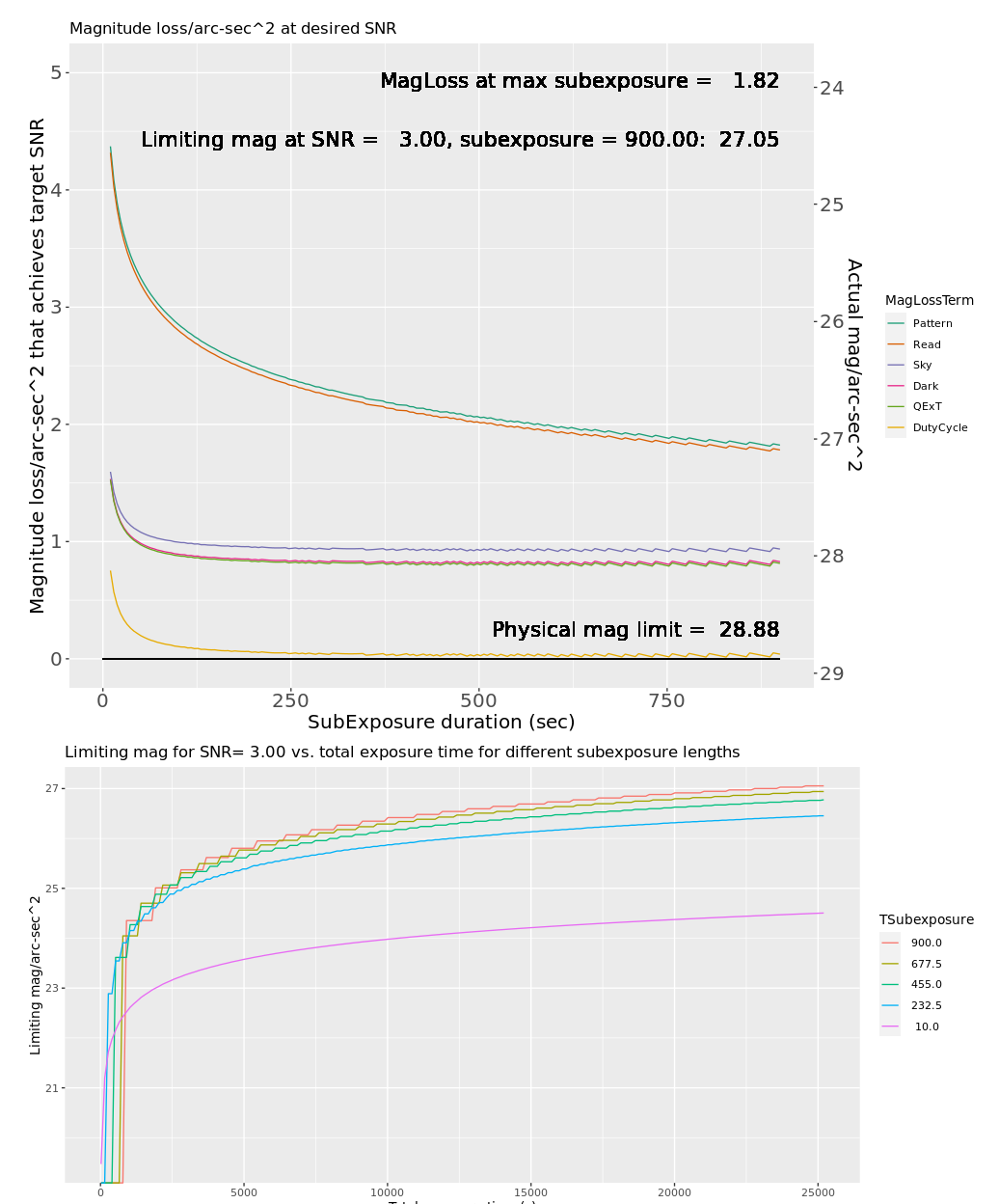

Thanks for the interest in my SNR tool.  I think it can help with this thread so I'll go through what I think is the situation for the OP's conditions - but I'm not sure of some of the numbers.  There appears to be a related thread in CN on the same topic - so I'll use what I think are the best numbers.
The situation is f/7 with 3.76um pixels, 3.12e read noise (due to gain setting being a bit low) and a sky background flux, combined with dark current, resulting in 14e in 900s, or 0.016 e/s total background signal.
I'm not a fan of defining thresholds or "optimal" settings for something like subexposure time because, in terms of the noise model, longer is always better and shorter is worse.  The real question is how much difference going from 300s to 600 or 900 might actually make.  And the way I characterize the difference is in terms of how much deeper you can stretch the image - in terms of magnitude per arc-sec squared - to achieve a given minimum SNR target.
The minimum SNR target is entirely up to the user in terms of how much they want to stretch and reveal background noise.  For technical measurements a min SNR of perhaps 10 is common - but when imaging faint structure you can see details with SNR as low as 1.  So I use a target of 3 for these assessments.
First a check on the sky background value.  I image with 3nm filters from light pollution of around 18.5 mag/arc-sec^ and at f/10 with 3.78um pixels my background is around 0.028 e/s.  If I scale this by the f/ratio factor of (10/7)^2 I get 0.056 e/s if I were at f/7.  The OP's value of 0.016 is about 3 times smaller, or about 1.5 mags darker - corresponding to a dark sky of around 20 mag/arc-sec^2.  This is all just rough estimates but as long as the OP's sky is very dark at around that level, it serves as a sanity check on what looks like a fairly small sky background signal.
Assuming 10 hour total imaging time and dead time between exposures of 5s, the resulting magnitude limit for SNR=3 improves with subexposure time according to the following plot:
The plot is all relative to the physical limit of a perfect imaging system with no loss and limited only by shot noise, operating at f/7 with 3.76um pixels.  That is the very best you can do, and the vertical axis represents loss relative to that limit.  At 1200s exposures you are losing about 3.2 mag, while at 600 you are losing about 3.4.  So you can concretely say that going from 600 to 1200 will gain you 0.2 mag - if you can do it.  So this isn't showing things as an "increase in SNR" - it's showing an increase in limiting magnitude - which is more meaningful.
The different lines in the plot show different terms being added in the noise model - and the big jump from the upper bluish line to the final orange line is due entirely to read noise - so you can see the big role it plays.  If the gain were turned up a bit so the read noise dropped to about 1.4 it would help a lot.  But this gives an idea of just how much benefit you get from longer exposure.  There is no point where suddenly you are doing about as well as you can.  And it also serves as a sanity check on the sky background flux.
Frank

Hi -
My main point is not to rely on such factors because there is no clear "knee" in the plot.  The expression I used is what I thought was the standard convention - but I won't vouch for any of them.
If you want the "swamp factor" to refer to the ratio of noise terms, then it would be sqrt(background)/rn.  If you want the background noise to be X times the read noise - that is the expression to use.
But 10x the read noise is huge and in terms of the total noise, the read noise is a negligible contribution.  That's why sqrt(10) as a factor is more reasonable - hence the choice I made to leave it outside the ^2.
If you had no read noise the total noise would be sqrt(b) where b is the background.  If the read noise is 1/sqrt(10) times the background noise, then the total noise is sqrt(b + b/10) or sqrt(b)*sqrt(1.1) = 1.05 sqrt(b).  Hence the read noise is only adding 5% - which is fairly negligible.
But there is nothing magic about 10 or sqrt(10) or 5%.  You can image well with read noise even equaling the background noise as long as you expose enough.  So I would just look at the sky background relative to the read noise and say - Oh - I should use at least 5m exposures for this.  Whereas for RGB imaging you might say - the background is huge so I don't need long exposures - but I might as well use 5m anyway.
Ideally the exposures would be long enough that read noise is at least less than sky background noise.  If the two things are equal, read noise is increasing the noise by 40%.  If read noise is about 3x smaller than background noise, it is raising it by 5%.  You can image anywhere in that range and beyond as long as you expose enough.
For your example the read noise is high compared to sky background unless you use very long exposures - but fortunately you are able to change gain so the read noise is much lower.  If the resulting "swamp time" is still too long to be practical - at least strive for read noise to be less than background noise.
Another way to look at this is to view it as a "good problem to have."  It's hard to go long enough to swamp the read noise - but that's because you have such low background noise in the first place.  The 3nm is doing its job - and you are in great shape.
Frank
