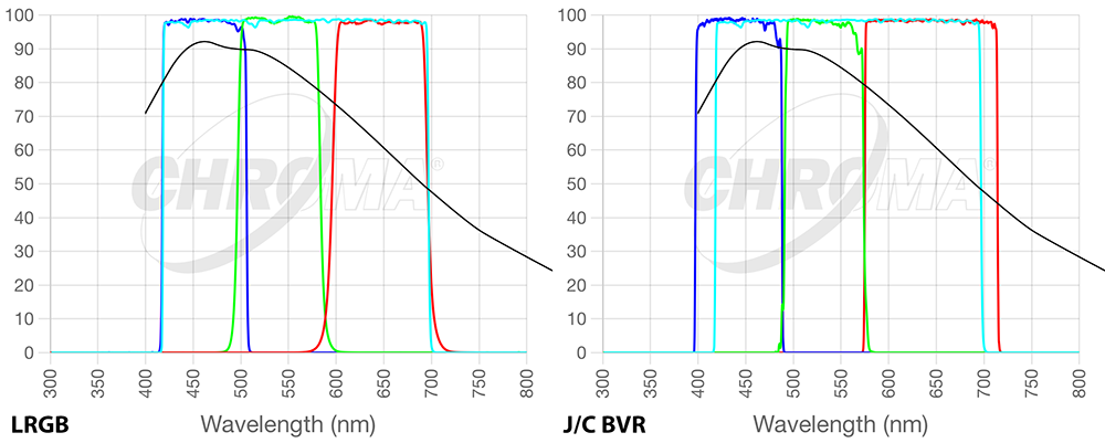

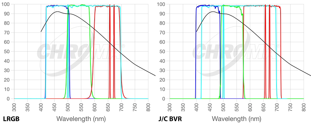

Comparing the spectral bandpass, these are my observations (note that the black curve is the QE curve of IMX455/461 sensors, and the cyan line is the Luminance filter):
+ The BVR filters have slightly wider bandpasses in the red and blue regions.
+ There is very little overlap between each of the bands with BVR unlike RGB and the falloff is rather steep.
+ There isn't ~20nm band gap between green and red, which IIRC is there to filter out light light pollution from sodium-vapor lamps, and not really useful from a remote Bortle 1 site.
- The only negative I can think of is that the luminance filter doesn't have as perfect of a match, but creating a superlum with L, B, V and R should mitigate that issue.
And when considering overlap with narrowband filters for continuum subtraction, there is possibly a slight advantage to the BVR filters in that Oiii bandpass falls squarely within the V filter bandpass, while with RGB, both G and B oddly share the overlap in their falloff regions.

jhayes_tucson 26.84
HI Ani,
You've raised a very interesting point here.  One thing that jumps out at me is that the bandpass for the BVR red filter will help a little to make up for the fall off in sensitivity of the IMX455 sensor at longer wavelengths.   I also like the lower overlap between the B and G filters and your point about continuum subtraction is a good one.  If it were me, I'd definitely choose the BVR filter set.  And if you go in that direction, I'll be looking carefully at your results.  Heck, I may have to change out the filters on my scope.

Regarding the B and G filter overlap, it is actually quite intentional to have both the filter exactly overlap with the OIII emission line, as this will allow both channels to capture some sweet extra data. For this reason, RGB will have slightly worse color accuracy. Also, the overlap is often designed so that at least one of the filters, if not both, will capture the OIII signal at close to maximum transmission, so continuum subtraction is rarely an issue with RGB filters.
The BVR filters do have an advantage over the RGB filters in the R and G overlap, as RGB filters are often made with a little gap in between, to combat sodium-vapor street lighting, which emits at 589nm. So J/C BVR will be able to squeeze out a bit more signal there, and also in the slightly broader B and R bandpasses.
It's hard to say what will give the best results, as it will depend a lot on the target - I suspect RGB will have better SNR at a small cost of color accuracy for emission nebulae, while J/C BVR probably has ever so slightly better SNR on pure broadband targets.
All in all, I don't think you will see any big difference between the two options, and most of it will probably be a matter of preference.

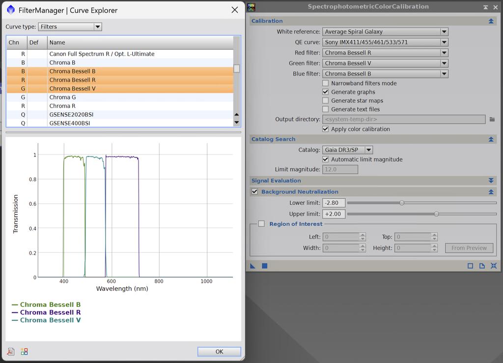

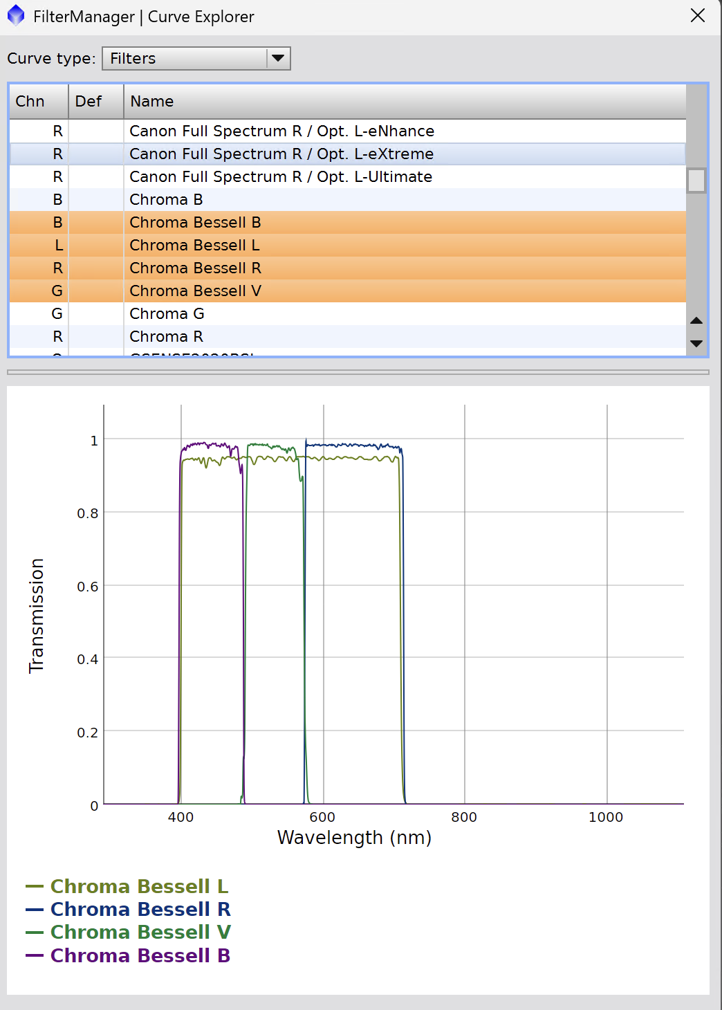

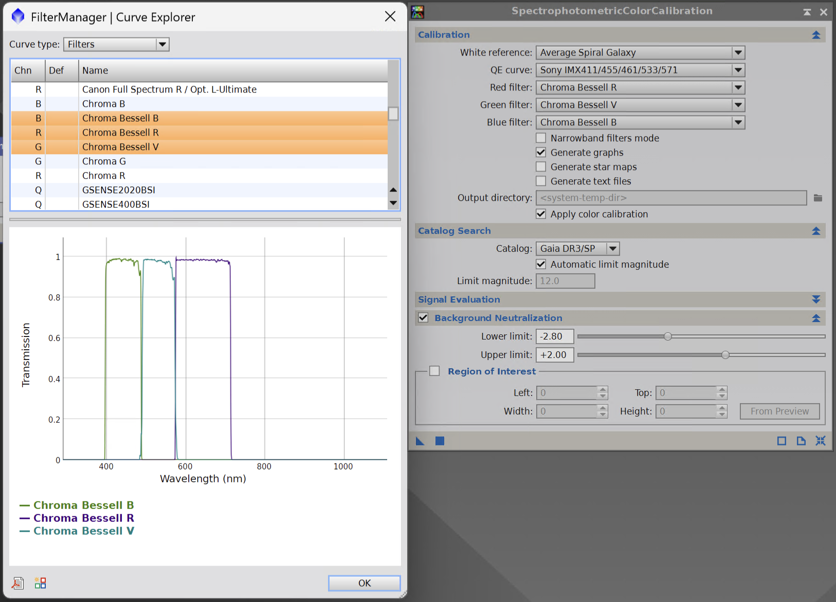

I also downloaded the spectral data files for each of the BVR filters, but since PixInsight doesn't have a native way to directly import these and doesn't include these filters by default, I wrote a quick C# app convert them to the .csv file format that PixInsight expects. With this, I was able to import the spectral response graphs for use with the SpectrophotometricCalibration (SPCC) tool. Of course, I don't have any data to try if this works just yet, but @Wei-Hao Wang, if you have data that you are willing to share, I am happy to test it out.
@Mark McComiskey, you'd have to map each of the 6 filters to their closest R/G/B equivalents. Probably something like matching the integrated area under the QE curve across the bandpass as close as possible to the R/G/B equivalents might work reasonably well. Many of the high-end renderers used to use spectra instead of just RGB triplets, so you'd get 7 colors to work with, which eventually would get tone mapped into RGB using the photometric response curves of the human eye.

The CDK scopes have refractive field optics so be aware that the color correction may not extend very far outside of the normal Lum filter bandwidth limits.  If the longitudinal color correction changes quite a bit in the red (for example), it won't matter so much when you shoot through the red filter because you can correct for it with a focus offset.  However, it might lead to halos--either blue -or- red with the lum filter if you go too far outside the well corrected range of the optical system.  So, you might want to check with PW just to get their take on using a lum filter with more bandwidth.  It might be fine but it would be a bummer to have a special filter made and then discover that you get unacceptable halos with it.  Having more bandwidth with the lum filter has some advantages but unless you are running a RC, be careful about the color correction.
@John Hayes, thanks for bringing this up, this is a good point to verify with PlaneWave indeed. I did shoot an email to Bill Dean asking him to see if there would be issues with the refractive corrective optics on the CDK20. Now that being said, don't people sometimes use "Clear" filters with these telescopes instead of "Luminance" filters where the bandpass is between 300nm and 1200nm without issues?
