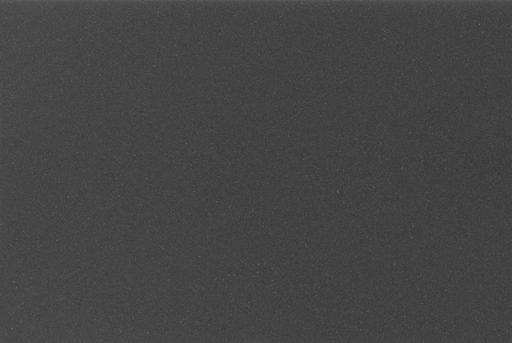

I was testing dark current of my RisingCam IMX571 camera a couple years back and left the camera running for a total of 27 hours with an hour per exposure also to see if there are "hits" on the sensor.  The image is downsized a little bit and saved as a lower quality JPEG to fit the 5mb limit here, but loads of streaks can still be seen in the image. The image was stacked using maximum value combination so that they are easier to see, and was also just stretched to make them visible (less than 2 electrons per hour at -10c). In the raw data i measure these streaks ranging from a few dozen to a couple hundred electrons. And i also occasionally see these in my subs, as well as the reject high image that Siril saves if the option was ticked. Camera was in my 6th floor apartment at the time, so plenty of concrete all around. As far as i know there is no way to tell if some of these are cosmic rays, but it is possible. Most likely they are from local sources of background radiation, but still an interesting test.
