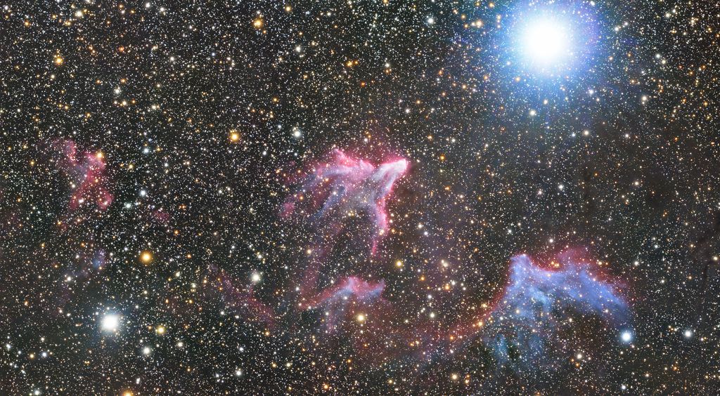

Here's an image with UV/IR only. It's just below 14 hours with a OSC camera but a fairly large aperture telescope, so if you have anything smaller you would probably expect to need more and accept less resolution of course. Another example here with pure OSC/UVIR and dual band, a total of apprx 14 hours with a smaller aperture telescope. Despite the differences in aperture i think these are good examples of what you might achieve in the end.
Despite the differences in aperture i think these are good examples of what you might achieve in the end. The second one perfectly match my hopes in terms of blending broad and Ha in precise areas. I got now 14h of pretty detailed Ha, the same amount in broad will do the trick. Fingers crossed. Thanks to have found this one, i must have miss it during my extensive scrolling  Next episode in some weeks i guess !

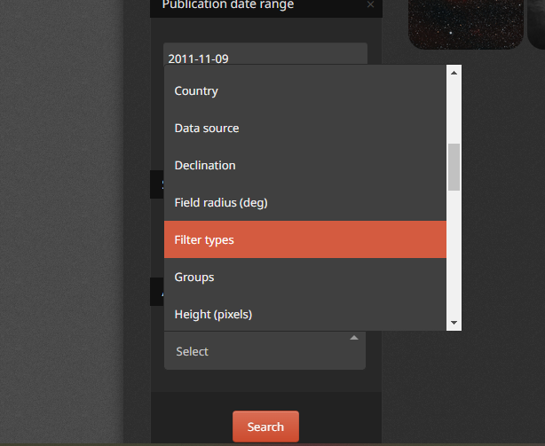

The add filter option in the explore section is quite handy in order to search for specific images with comparable gear   |
Yes i'm curious about how a long broad integration should looks, since i wont be able to shoot mine for a week because...clouds. Thanks ! I looked on my phone and found a pic where I only processed the broadband data. As you can see the grey and blue regions are coming out nice. But my picture wont match the resolution of the examples given by Jan, because I only shot IC63 with an 80mm refractor and IMX585 with 2.9 micron pixels. Integration time at this point was 22h RGB with OSC. Processing was only quick and dirty to see if I need additional Dualband data. Next step: I need a bigger telescope, lol!  |
 I know, i know.... Sadly i'm struggling to become a paid member due to the payment system failing to recognize my visa, so as a free one, i can't use those filters in my searches, to my great disapointment !
Next step: I need a bigger telescope, lol! Shooting with the 585 too and a 72mm, now i can perfectly see what should come out of my next broad nights, many thanks Tobiasz, 20h+ seems to be a sweet spot.
Funny that you mention that. I have the same problem, my US debit card won't work for this site, probably because the processor is overseas. I don't use credit cards so it's an issue.
Could not resist to do a quick try on all my data, here the very temporary result. With a ton more of broadband data, the fuzzyness and lack of fine details will hopefuly disappear, but i'm already satisfied with this early quicky. https://astrob.in/lzmcq1/0/Regards
