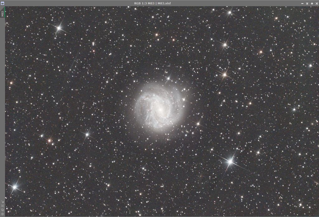

I would agree with Andrea. I looked at all your files (flat, light, dark flat, dark) and they all look like I would expect. A couple of dust bunnies and vignetting in the flat (normal) and amp glow in the dark (also normal). I think you did your stacking in DSS, so wondering if you have altered your settings in there somehow to cause the problem. I used to use DSS and StarTools and quite frequently ended up with results like your first image. Right now I'm just using Pixinsight for everything and am finding the whole process a lot more satisfying. I also had a quick go at your integration frame in Pixinsight and ended up with something similar to (although not as good as) Andrea.  |

* I used ABE with a very large number of small sample sqaures to extract the background; I tried DBE first on it, but found ABE did a better job in this instance. * I also have the 200PDS/4/3" sensor combo and do not have the circle issue. I do, however have some pretty significant vignetting, but that is easily corrected with flats.
I used 6 iterations of DBE with 55 samples per row, initial sample weight 0.25, increasing to 0.35 for the subsequent iterations. Correction set to subtraction all the times. I can send you the corrected light frame, processed and unprocessed, if you need them. I strongly advise you to ditch DSS and use PI for ALL your processing. It is going to be well worth your while.
