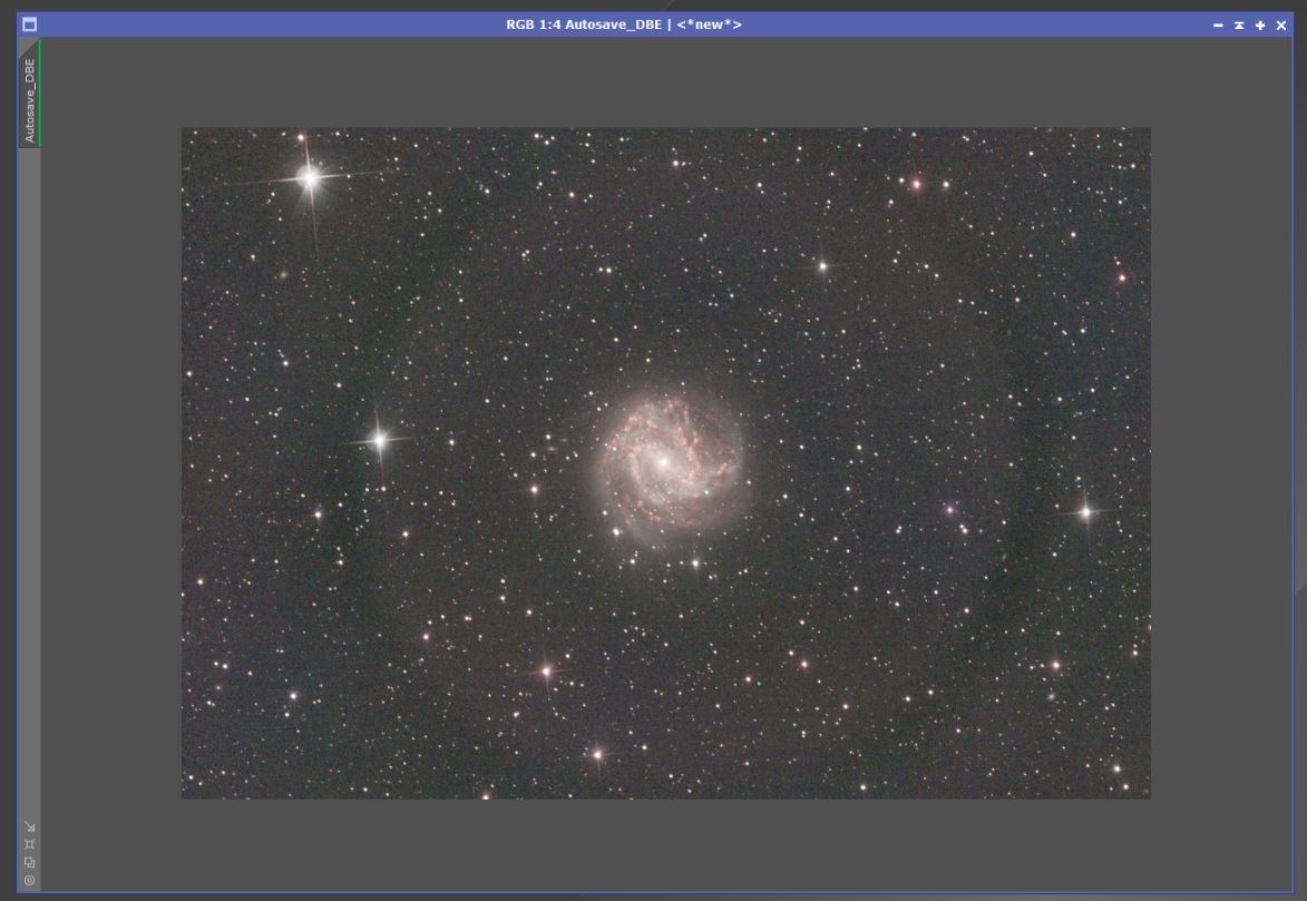

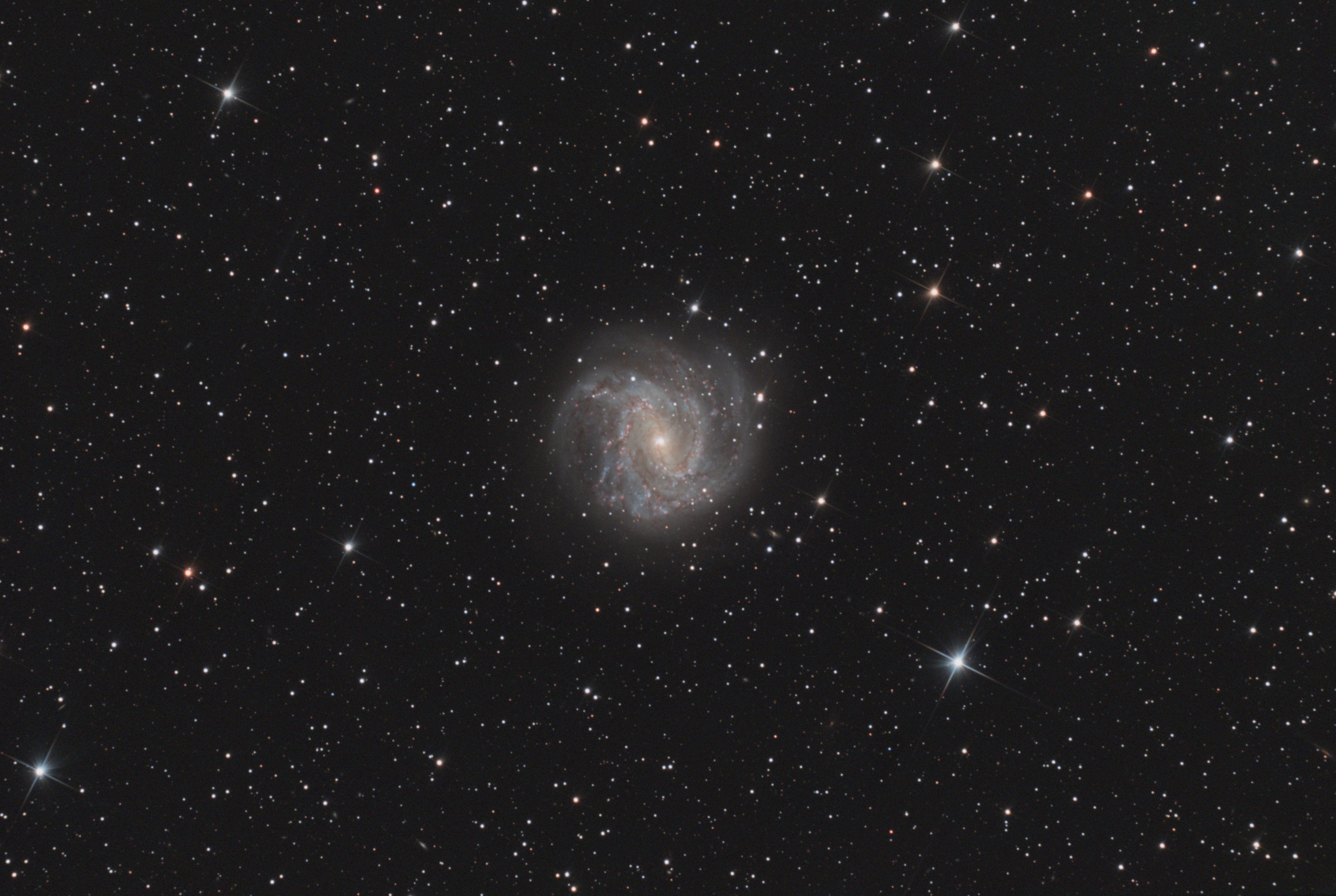

After processing the final image I'm leaning toward an issue with processing rather than fundamentally wrong flat-fielding. Here is the stretched final image once cleaned up in PI. What program was used to process it?:
Incidentally, the bluish streak on the upper left quadrant is an odd ghost reflection from the MPCC. You might also want to check collimation, especially centering of the secondary, as there is significant flaring in the brighter stars.
And, finally, unprocessed but auto-stretched in PI:

I would agree with Andrea.  I looked at all your files (flat, light, dark flat, dark) and they all look like I would expect.  A couple of dust bunnies and vignetting in the flat (normal) and amp glow in the dark (also normal).  I think you did your stacking in DSS, so wondering if you have altered your settings in there somehow to cause the problem.
I used to use DSS and StarTools and quite frequently ended up with results like your first image.  Right now I'm just using Pixinsight for everything and am finding the whole process a lot more satisfying.
I also had a quick go at your integration frame in Pixinsight and ended up with something similar to (although not as good as) Andrea.

I used 6 iterations of DBE with 55 samples per row, initial sample weight 0.25, increasing to 0.35 for the subsequent iterations. Correction set to subtraction all the times. I can send you the corrected light frame, processed and unprocessed, if you need them. I strongly advise you to ditch DSS and use PI for ALL your processing. It is going to be well worth your while.
