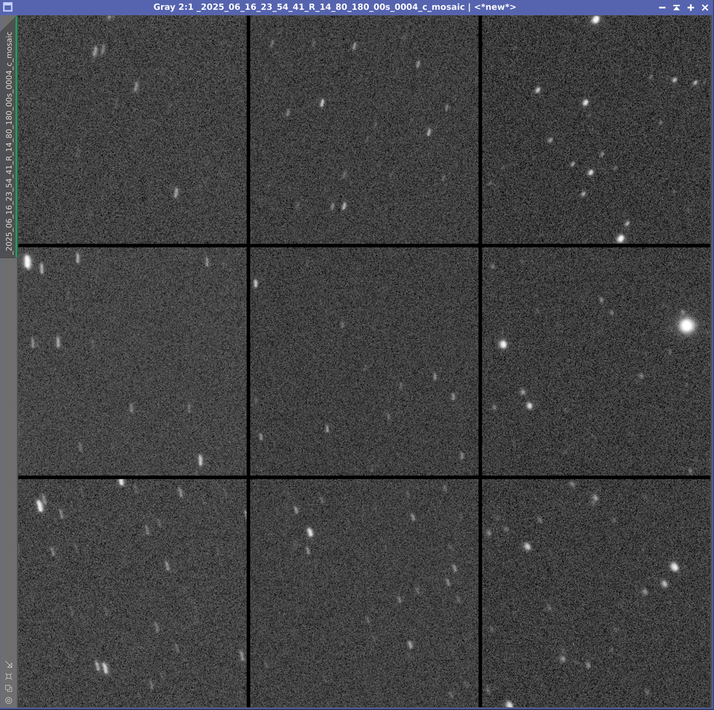

Unfortunately the real night here starts only at 23:00, so it's quite though to do all normal tweaking of the setup. After the normal setup (polar alignment - using PHD2 drift alignment, guiding - PHD2 - calibration, focusing, ...) I started acquisition and quickly noticed the image/flatness is not good. The pattern was quite obvious (see below)
I am using the petzval Takahashi FSQ106edx so I don't think it's the back-focus issue. Initially I thought it might be the tilt of the imaging train (I am having ZWO OAG, ZWO FW and ZWO asi294mm connected), but now I am thinking it might be incorrect guiding.
Another info: January this year I had accident with my mount that I partially fixed, but I still have some issues when doing meridian flip, that is also the reason I am suspecting the guiding / polar alignment (I did it facing west but then slew to the east side). Guiding numbers were quite OK (0.5-0.6" RMS) but I know this doesn't mean anything for the star shapes.
I would also like to mention that usually in the same assembly I have image with stars being nice in all corners.
As the night comes so late, I'd like to be ready with all the ideas for tonight, so I'd really appreciate any ideas/feedback from the forum. I will try of course with shorter shots to try to get eliminate guiding, I will also try to rotate image to see the effect. But of course any other ideas will be appreciated
All filters (R, G and B) shows the same pattern, below image is 180 seconds R acquisition.

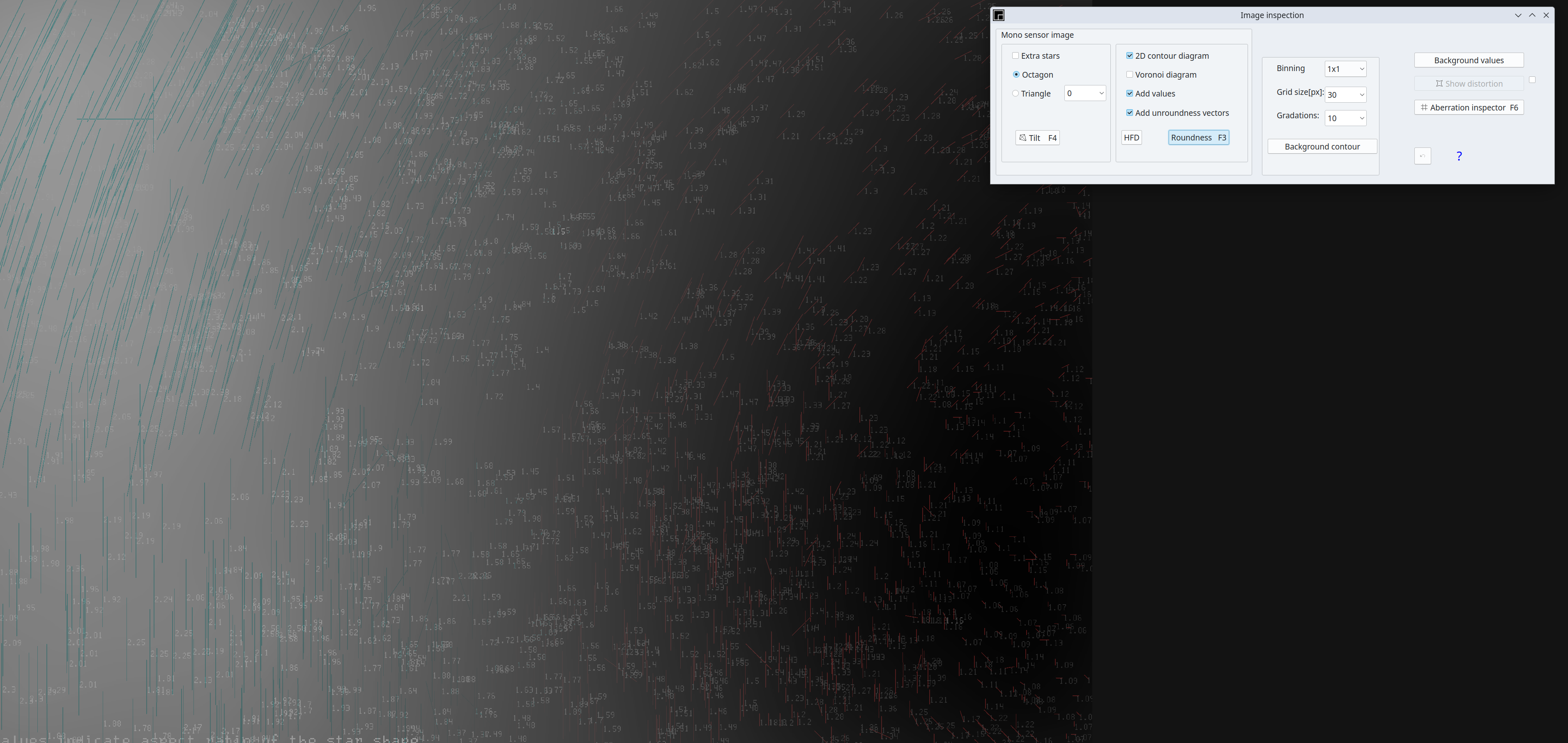

Aberration inspector from PixInsight:
ASTAP shows the pattern of the stars quite obviously the pattern how the stars are prolong - it seems the 'center' is right-middle and the stars are 'circulating' around - this is also why I started to think it could be polar alignment / guiding issue:
Very bad PA, you have image rotation and that cannot be fixed by any kind of guiding. Don't do (ever) PHD PA. Get SharpCap and use its polar alignment routine instead. (you will have to buy the Pro version I think but it is very cheap). This can't fail unless you have serious hardware issues with the mount (sagging tripod, creeping altitude bolts and such). And don't complain too much about the short night, cause you are lucky seeing from here. Here there isn't any till the 27th of July and nautical twilight starts at 23:45 and ends at 2:15!

Very bad PA, you have image rotation and that cannot be fixed by any kind a guiding. Don't do (ever) PHD PA. Get SharpCap and use its polar alignment routine instead. (you will have to buy the Pro version I think but it is very cheap). This can't fail unless you have serious hardware issues with the mount (sagging tripod, creeping altitude bolts and such). And don't complain too much about the short night, cause you are lucky seeing from here. Here there isn't any till the 27th of July and nautical twilight starts at 23:45 and ends at 2:15!
Thanks Andrea,
You confirmed my suspicion about PA, i just phrased it incorrectly in original post. I will try out the SharpCap for PA.

+1 for very bad PA, we can see the field rotation in the images you provided.
If you don't want to spend money on Sharpcap, the Nina pluggin "Three Point Polar Alignment" works great too.

The reason that I ask is that I did some quick math on the image streaks.  The focus of rotation does look to be somewhere near the right frame edge, as you have mentioned.  A little trigonometry indicates that the length of the star streaks appears to be the amount of sky rotation over 2.5-3 minutes, around that focal point of your image.  So, for example, if you were acquiring images around Polaris/NP, it is almost as if the mount was not tracking at all.
It just seems odd that a bad PA would show that kind of rotation if not imaging near the NP.

If the target were more distance from the pole, the severity of the rotation couldn't be explained only by bad PA.  But the Seahorse is 'way up there' and I suppose I could buy in to the PA issue.  Of course, the other posters here have significant experience, much more than I.  Would a bad PA really cause that kind of variation in star streaks, such that it clearly rotates around a point with a rotation point located within the frame?
AstroReghe 1.20
@Jure Menart  i suggest you to use sharp cap pro for PA, i had a PA with this program in my observatory and now i am below 10 arcsec error. with my encodeer mount i don't need autoguide.
Ricccardo
Mark Fox:
Thanks for the clarification, Jure.
Yes.
