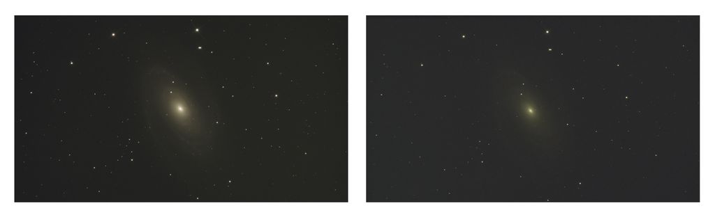

I've done some test imaging comparing going naked verses using a uv/ir cut. You can see the result here:
https://app.astrobin.com/i/0789ya
It's clear that you are throwing away a lot of energy by cutting off at 400 and 700nm.

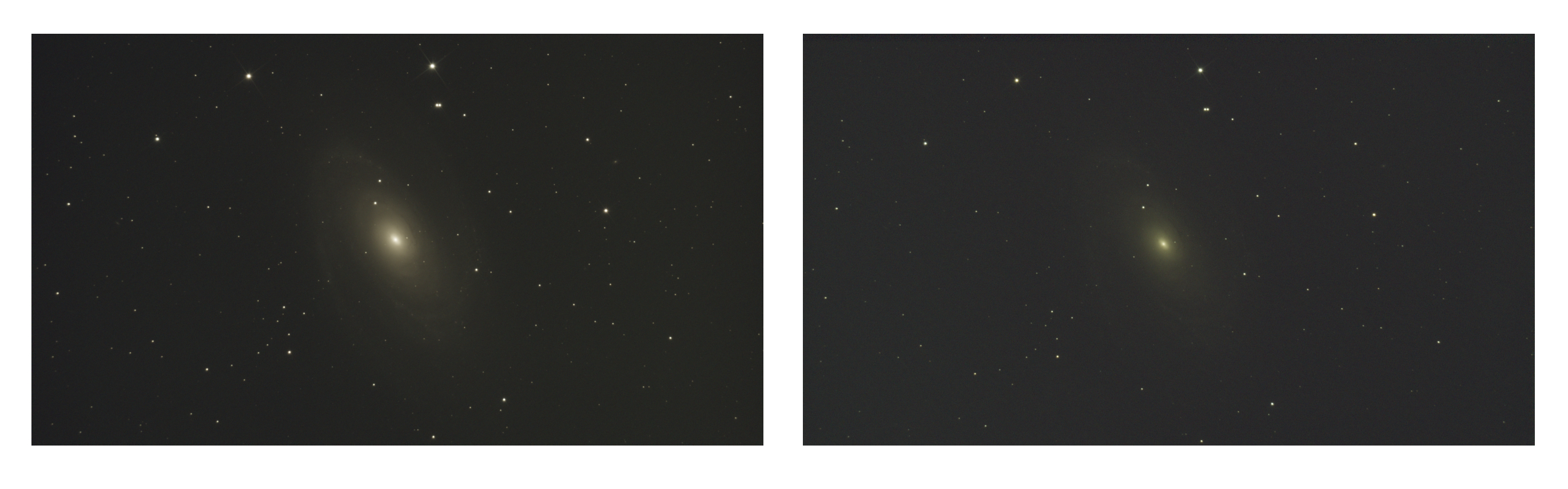

Sorry, I had just removed it from my gallery.
No filter is on the left. The difference was obvious even during capture. The 585 does have pretty good sensitivity beyond 700nm so results will very depending on the system and sensor.
Very interesting and encouraging!

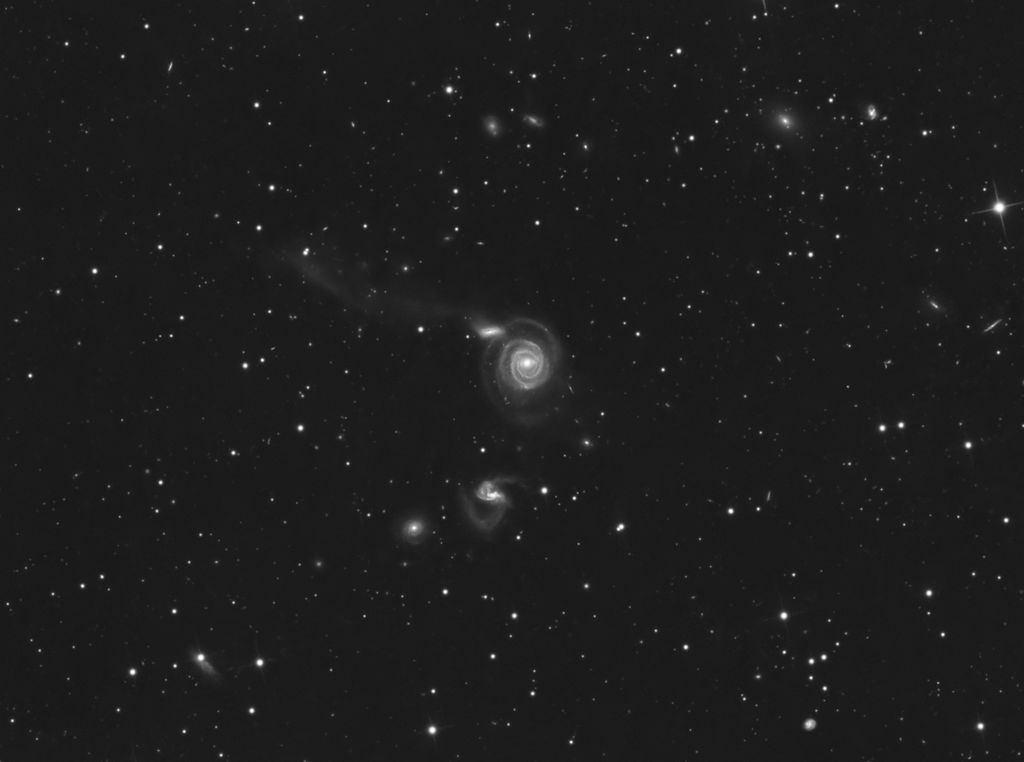

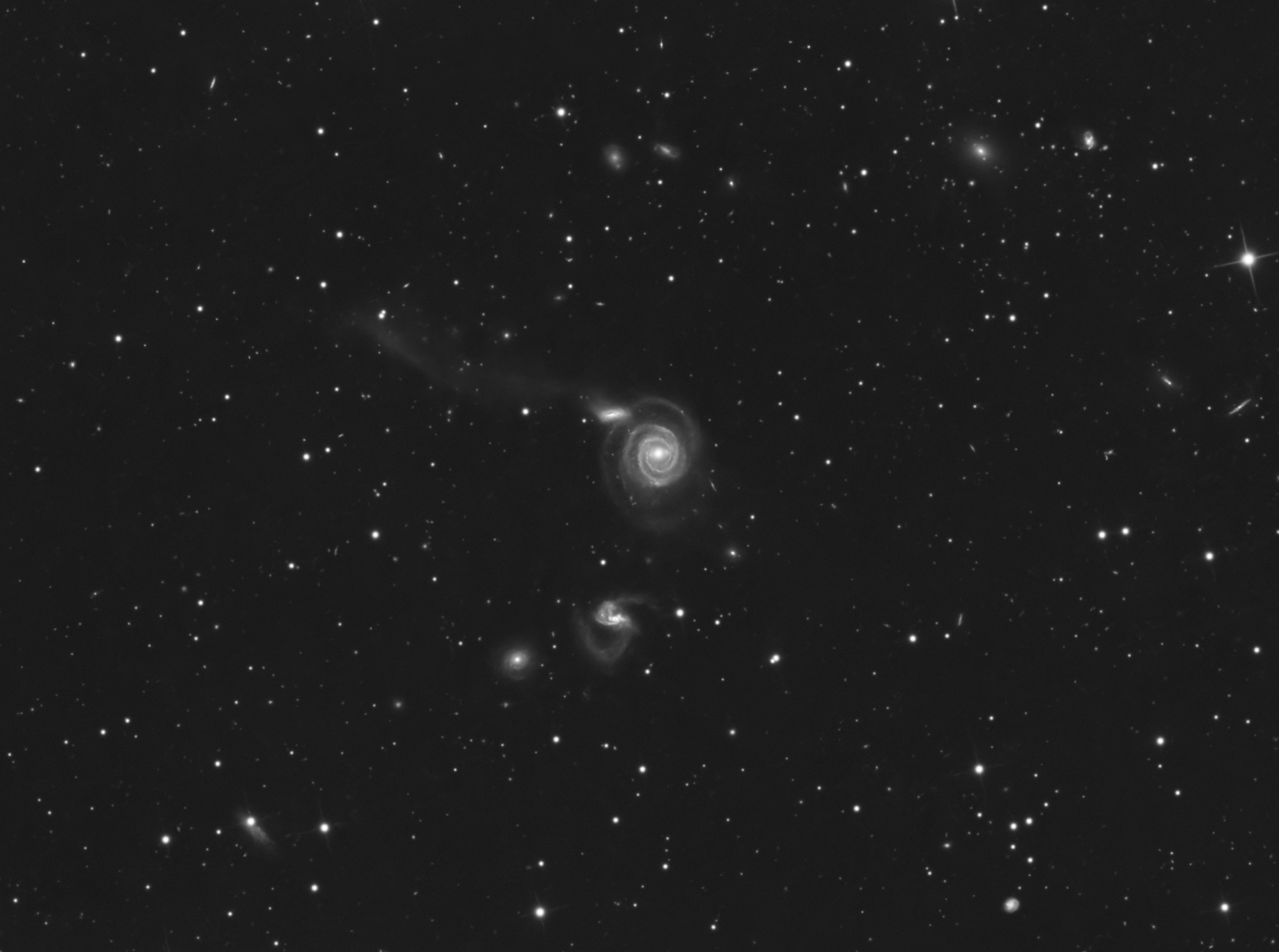

Just an update : first luminance with the clear filter it seems to work fine with no evidence of degraded resolution
25% more signal for free is nice

Update : I got my best 60sec luminance sub ever with this scope using the clear filter :  median 1.36" FWHM according to FWHMEccentricity.  It is not a scientific proof, but for me it validates the fact that letting the IR light hitting the sensor does not impair resolution.
Glad it worked out for you. It certainly works for me. There aren't a lot of free lunches in this hobby but this little change might well be one of them. The graph below pretty much tells the story.
