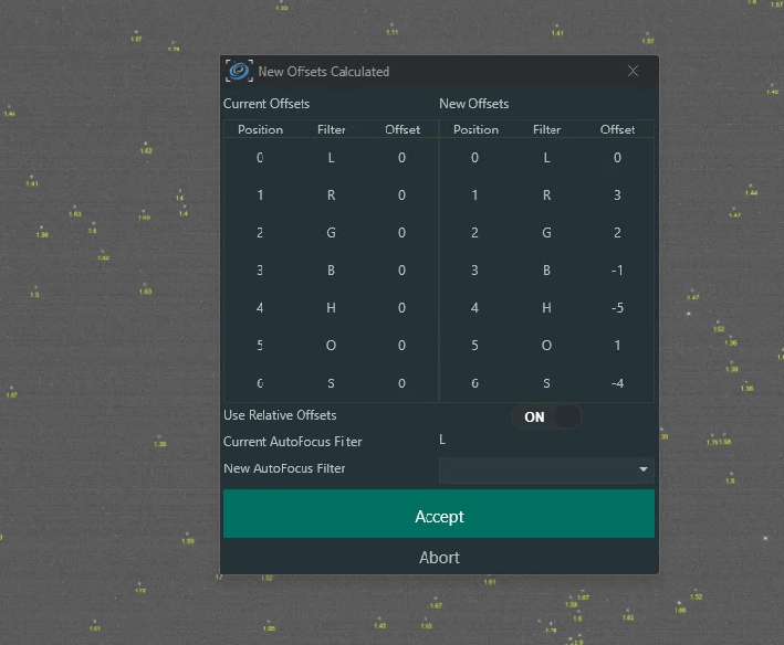

These are my offsets on my Takahashi E130 hyperbolic newtonian with Antilia LRGB and 3nm SHO. Not a lot when a step size is 20. Reflectors with refractive elements will still experience the same effect as refractors just not to the same degree, it might be negligible. With my RC telescopes and no refractive elements, I never refocus between filters, if I had to it would be because the filters are not truly parfocal. I have ran this routine many times on my RCs and ended up with nothing but -1 0 and 1.
Now that's really interesting, and at a fast FR. This seems to suggest that there is a difference.
