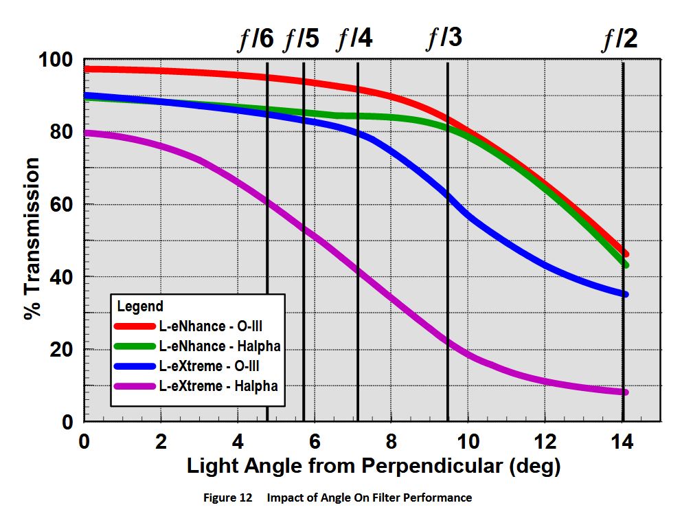

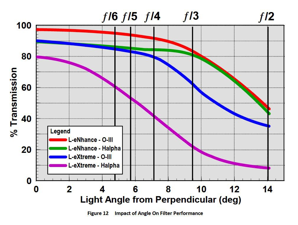

amv8vantage 0.00
Please note that very narrow narrowband filters may become less useful if you move to faster optics.
I have a set of 2" mounted 3nm Chroma that were excellent with my Edge14 w reducer (f/7.7) but useless with my Hyperstar (f/1.9).
BTW, the Chromas are for sale ...

Would I buy Chroma? Sure, one day, but for $2000 for just the LRGB set, another ~$3000, for narrowband, many of us just can't do that, I mean I could… but that's hard to justify unless the Antlia just aren't performing, but they do just fine, and you get the full set LRGBSHO (3nm) for under $2000.
