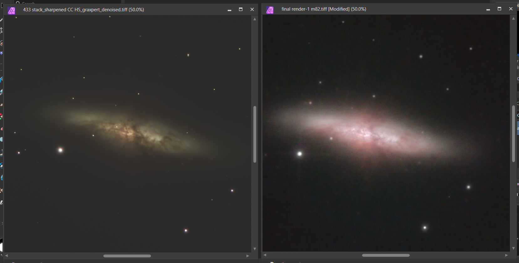

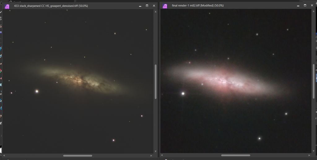

Over the last week, I've imaged M81/82 with my 10" f4 newt and last night with a 91mm f4.9 refractor.    Both in poor seeing, so the star sizes in arcseconds were pretty similar.      Viewing the raw single 60 second images from both at the same image scale, the image from the 10" had far and above more dim detail and much less background noise (much more than the f ratio differences would explain).   Also resolved dimmer stars and details as expected.   I'll try to put a visual example like I did earlier to clearly show this.
HegAstro 14.24
Rick Krejci:
This is exactly what a number of us having been saying all along (with the math to prove it). Neglecting things like transmission losses, assuming similar QE and low or negligible read noise - at common image scale and integration time, aperture will be the main thing that matters, by far. It cannot be otherwise, because if you could get the same result with a small scope as a large scope at common image scale, you would, in essence, be building the equivalent of a perpetual motion machine, a violation of the First Law of Thermodynamics.
Ricksastro 1.51
Arun H:
I've been part of that chorus as well.     Just wanted to give another concrete example.

Here's an actual comparison that I think very clearly shows what you can expect. The image on the left was taken with a 200mm aperture at F/10, uv/ir cut. The one on the right was taken with a 150mm f/12, dual band Ha Oiii filter. Please ignore the density difference as the 200mm image has a lot less integration time. What this image shows is the resolution difference. Not a perfect comparison by a long shot, it does give you an idea of what happens when you increase the aperture.
