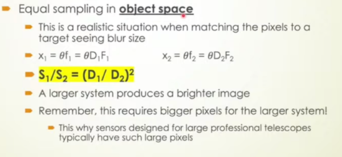

In conclusion, on a linear acquisition device such has a CCD or CMOS, f ratio will not change the SNR on a giveng angle sampled that must be equal in both system, the only thing that will improve SNR on the same angle is the chance to acquire more photon flux and is the collecting area of the system.
This is exactly identical to the statement that equal sampling in object space results in a signal strength ratio that is proportional to the square of the ratio of the lens diameters, and what is stated on John's slide 37:

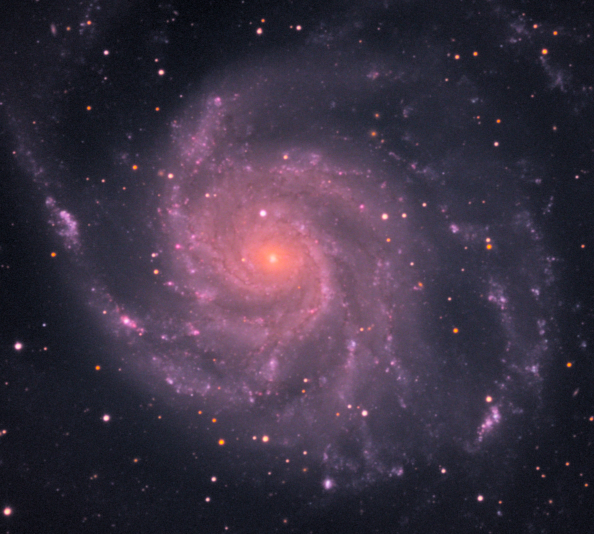

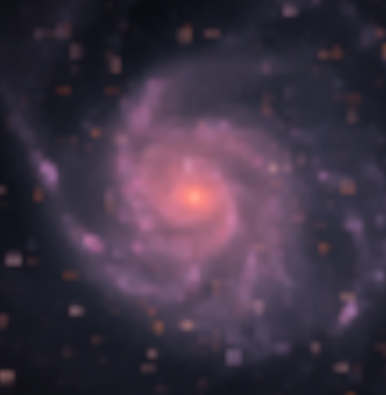

This is going to be an exageration, but which would you prefer?
Yes, your new telescope is slightly slower, but you'll get so much better that out of it.
