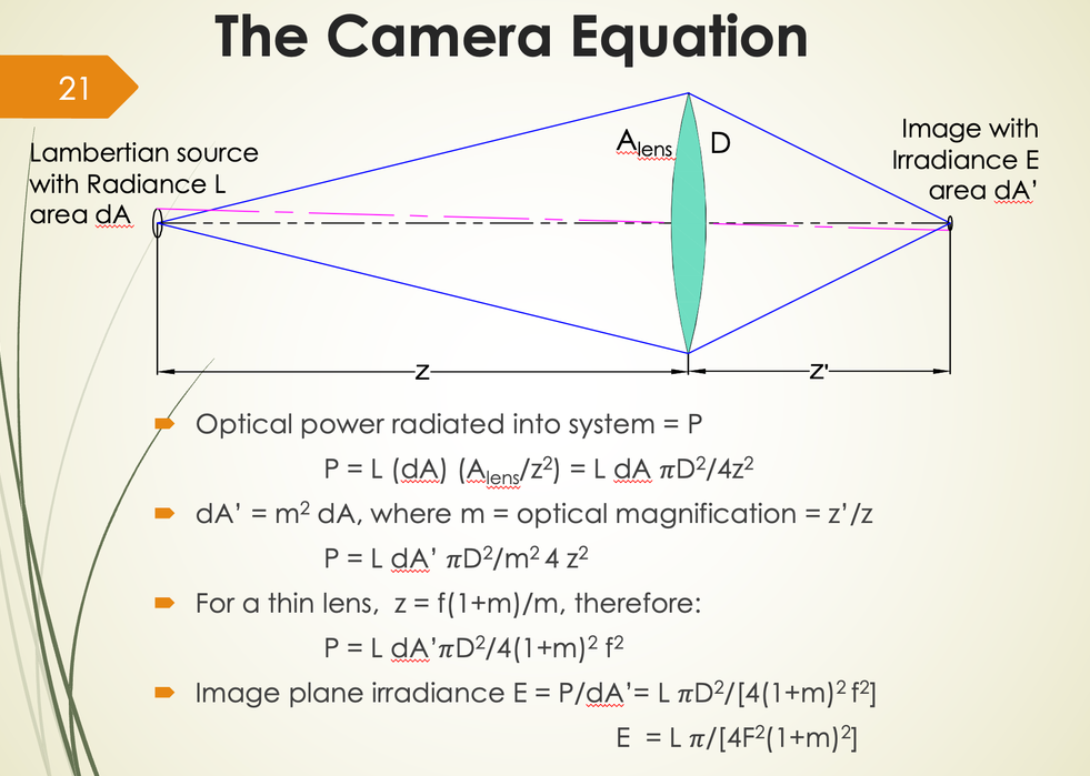

Look at the derivation of the camera equation by John Hayes, below. Optical power, P, captured by the system from a source of radiance L and area dA is dictated purely by the aperture of the lens and the distance. The focal length then dictates how that power is translated to image plane irradiance. A 200mm f/4 and 250 mm f/4 will provide the same irradiance on the focal plane, but for different reasons. The 200 mm f/4 focuses a larger area on the same pixel size as the 250 mm f/4, but the 250 mm captures more power from a fixed angular object area than the 200mm.
A 250 mm lens will ALWAYS capture 56% more power from a given object area than a 200mm lens and this will be true regardless of f#. This gives you the ability, in post, to bin down the 250mm image to a common image scale (assuming the FOV is not lost), so you achieve a higher effective irradiance. This is the true advantage of aperture. For a given FOV and given viewing size/resolution, the larger aperture scope will always provide the better image - simply because it has captured more power from that FOV than the smaller aperture scope. And nothing you do can change that.

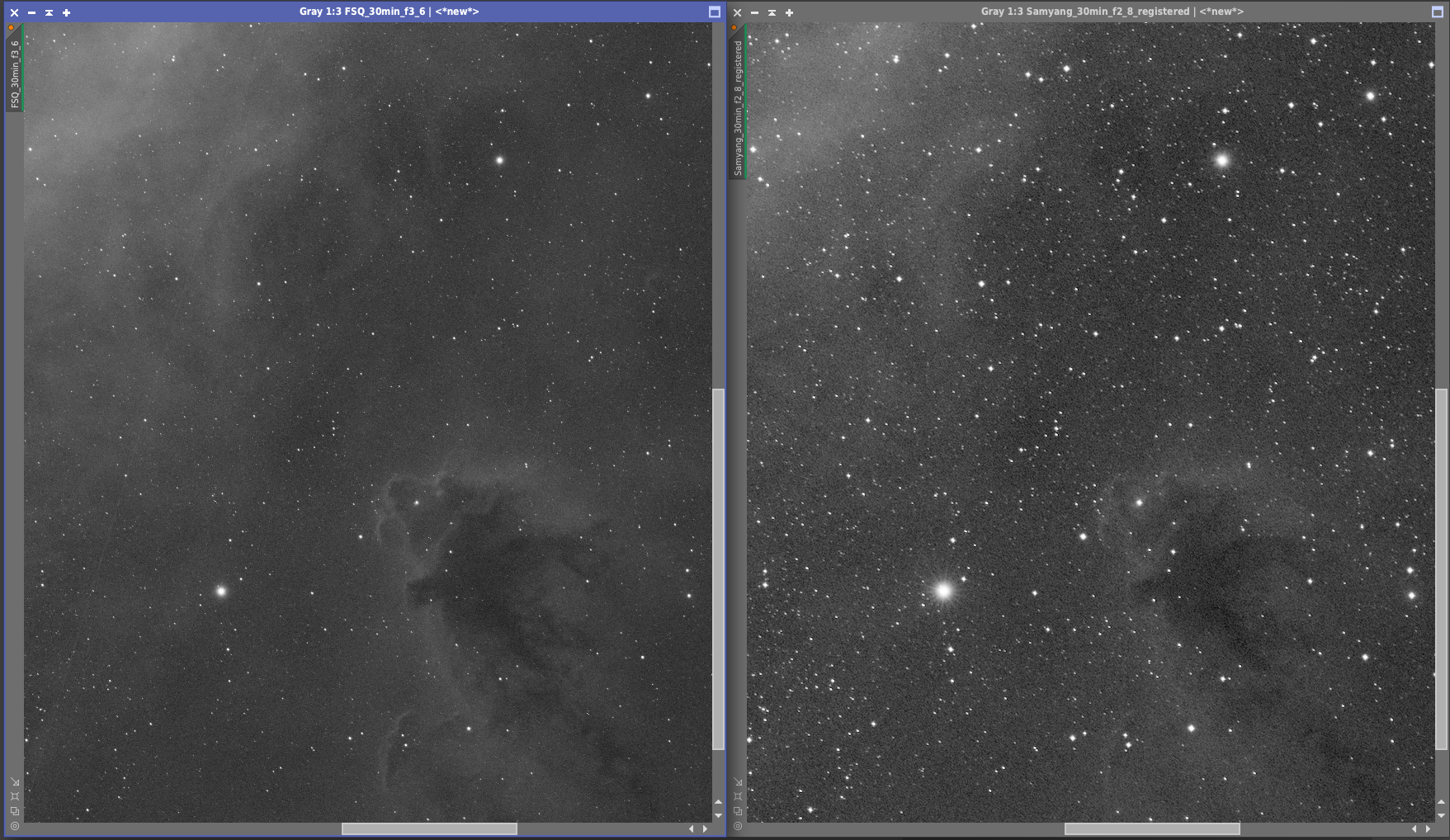

Steeve Body: Well from personal experience, running tak FSQ 106 f3.6 and the 135mm lense samyang at f2.8 as a dual rig, the FSQ capture way more light than the samyang at f2.8… the samyang is I think 65mm… so aperture seems in this case to make a really big difference… That doesn't sound right Steeve. I'm pretty sure that's what you get, but not because of the aperture. Those are two very distinct optics. Samyang doesn't give the same performance at F2.8 that Tak does give at F3.6, not to mention your pixelscale differs. It's very clear that one gets better SNR for extended objects if the F ratio is lower, not just theoretically but fair comparisons also show this. But if you are targeting faint point sources like stars, then you need aperture --hence why we have large aperture scopes for research. But we also have Dragonfly array-like ultra-fast systems for extended objects with low surface brightness.

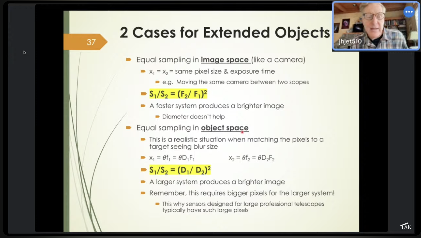

It looks to me like there would be a lot less arguing here if some of you guys would go watch (and understand) this presentation: https://www.youtube.com/watch?v=HiJoqQp1qFI.--particularly starting at slide #28. None of this stuff is the least bit controversial once you understand a little bit about radiometry. John
The point both Rick and I are trying to make is shown below. - In the case of the 200 mm f/4 vs 250 mm f/4, when you use two images at native or captured resolution with a common camera, you are using equal sampling in image space. This gives the same sampling in image space. In this case, the signal is just (F2/F1)^2=1.
- But if you bin the 250 mm f/4's image (and crop the 200 mm f/4's image) to a common FOV and common resolution, you are using equal sampling in object space, which gives case 2 - S1/S2=(D1/D2)^2 -> the signal per new pixel size is 56% greater with the 250mm.
This is entirely expected from the left hand side of the first point in John's camera equation  The power captured from a fixed area dA of object only depends on aperture (for a given distance). In the second case, each pixel is representing the same object area, so the ratio of signals can only depend on the lens diameter.  |

Yes, on paper a lower f-ratio should collect more light per unit area on extended objects. But in real world use, why is the FSQ106 at f/3.6 consistently outperforms the Samyang at f/2.8 in the observation I have made on the same object (horsehead, orion etc...)?
The images were taken at the same time with the same amount of integration time... I understand it is different pixel scale... but even with that before doing this experiment I was certain that the samyang would yield better results on faint nebulosity than the FSQ.... I'm not seeing that....
Here is what I'm seeing When you register and present the objects as you have here - so you have the same FOV and same resolution for the object area of interest as seen on screen - you are effectively using equal sampling in object space. This should and does result in the scope with larger aperture (the FSQ) showing the better image, exactly as predicted.
Here is what I'm seeing When you register and present the objects as you have here - so you have the same FOV and same resolution for the object area of interest as seen on screen - you are effectively using equal sampling in object space. This should and does result in the scope with larger aperture (the FSQ) showing the better image, exactly as predicted. it looks exactly the same without the 135mm being star aligned to the FSQ. here I'm just trying to make the comparison easier
Here is what I'm seeing Steve, 1) Comparing stretched images isn't how you compare signals. You have to look at the actual ADU values for pixels that are looking at the same points in object space. 2) You have to use identical cameras with identical pixel size and responsivity. 3) You have to take into account the throughput of the optical system. That includes the transmission factors for each surface. It's important to understand that it is totally possible to have a very fast objective that has a lot of elements with poor coatings producing a lower signal than a slower system with fewer components that have very high performance coatings. This is one reason that the Dragonfly systems focus on getting lenses with the highest possible transmission. The equations that I provided in my presentation allow for differences in transmission factors. John
