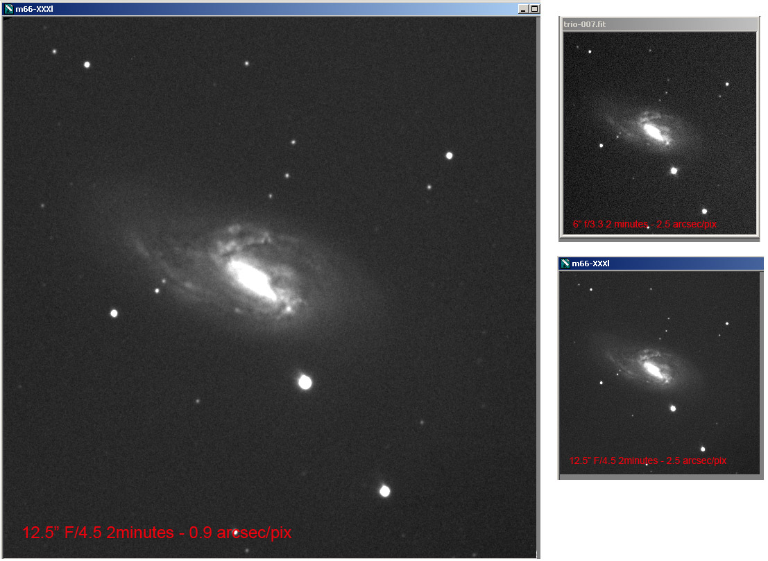

Charles Bracken explains this well in his book "The Deep Sky Imaging Primer", here is an excerpt from his section on this very topic:
"The claim is that it is a myth that lower focal ratios lead to shorter exposures. Because only aperture determines the number of photons gathered per unit time from a given object. The opposing position notes that focal ratio uniquely determines the total irradiance projected onto the sensor, regardless of aperture: an f/8 telephoto lens with an 80mm focal length and an f/8 refractor with an 800mm focal length will go equally 'deep', revealing the same dim features, but at different sizes. And experience bears this out, as anyone who has ever used a focal reducer knows that they clearly brighten the image. Both sides of this argument are correct, but they are defining different goals—brightness of an object (i.e., per angular area of sky, sometimes called 'object SNR') vs, brightness per spatial area as projected onto the sensor (i.e., per photosite)."
What you trade off when you go to a longer focal length with a larger aperture (in your case, f/7 instead of f/5) is more detail. In astrophotography, you have to balance SNR from focal ratio with detail from aperture. This is why long (f/15 or greater) SCT's are popular for planetary photography; the planets are very bright with lots of very fine detail, so the scale is tipped towards the side of detail and aperture over SNR. Your 60mm f/5 scope only packed a 300mm focal length, if you compare that to a massive but slow scope like an Edge HD 8 at native f/10, despite the image on the Edge HD being dimmer per unit time, it is more detailed because of the larger (200mm) aperture and longer (2000mm) focal length. These are the sorts of trade offs you have to make, and the key is finding the balance where you are most satisfied with both the detail in your images as well as the time required to bring out dim details.

In my club we recently did a comparison - horse head and flame shot with various small APOs vs larger ones such as my MN65 and a GSO 10” RC, with camera sensors matched to give similar FOV.
In just 15 minutes the two larger scopes produced better shots than the smaller APOs did in an hour or two. Aperture does count.
