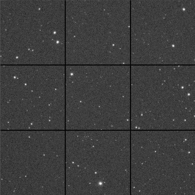

before, I could do 5 minute subs and I would have to trash half of them because of bad DEC guiding, now I can do 20 minute subs with my AVX, no problem, no huge DEC jumpiness, nothing gets trashed:
20 minute sub, APS-C, no BXT:

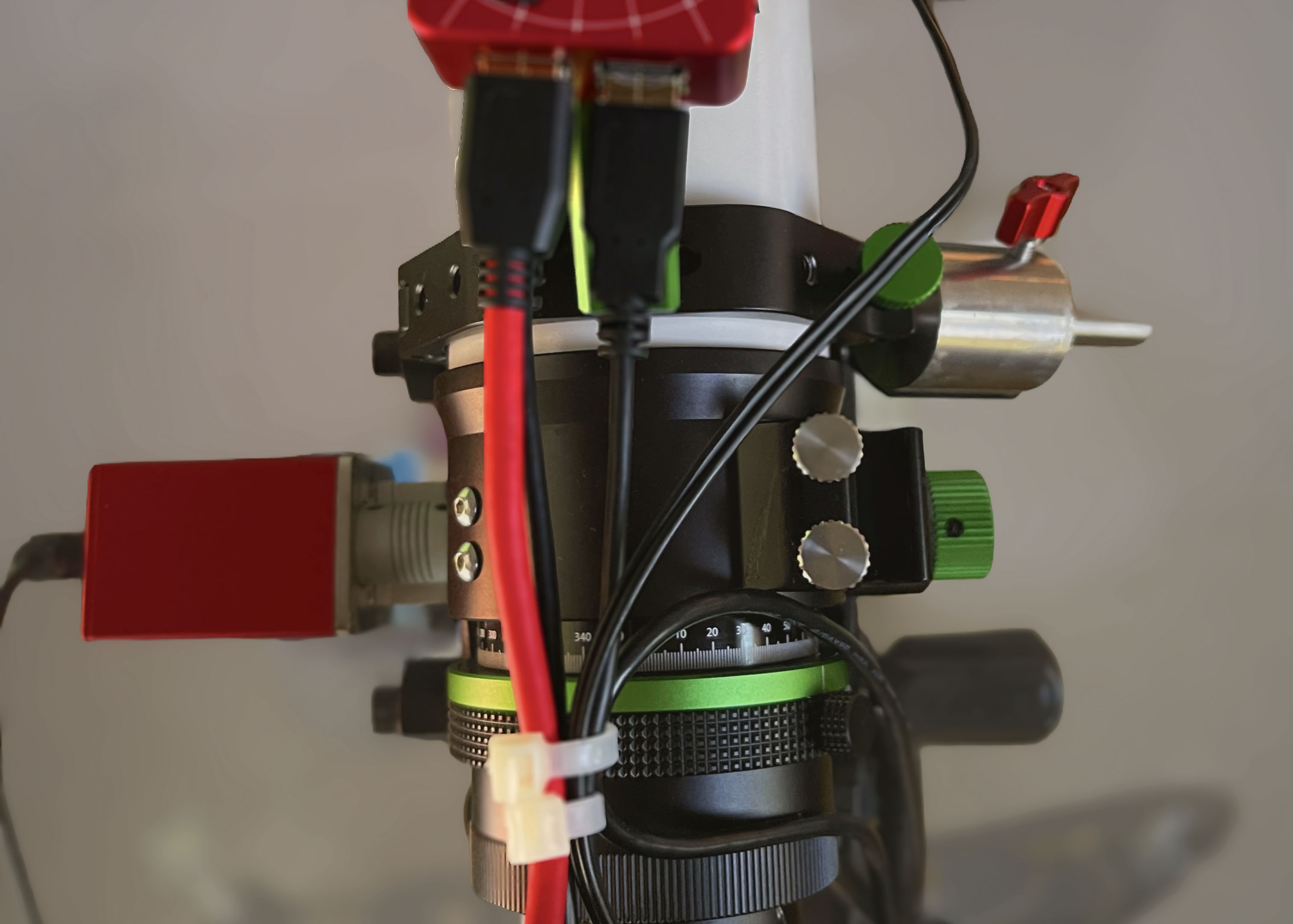

I had this exact problem on my 65PHQ too - because the scope is only 4x the weight of the EAF, and the EAF's center of gravity is about 60mm off center of the scope, almost the whole weight of the EAF.
I 3d printed a bracket that mounts to the dovetail, and allows you to place an M16 threaded rod heading out to the side of the scope (away from the EAF) and then used a 16mm coupler (large nut) threaded onto the rod to achieve balance… that worked perfectly for me.

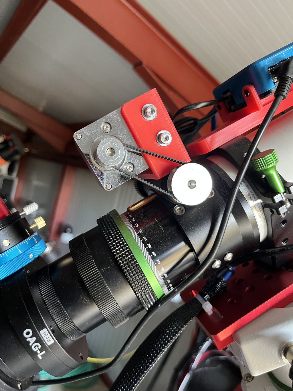

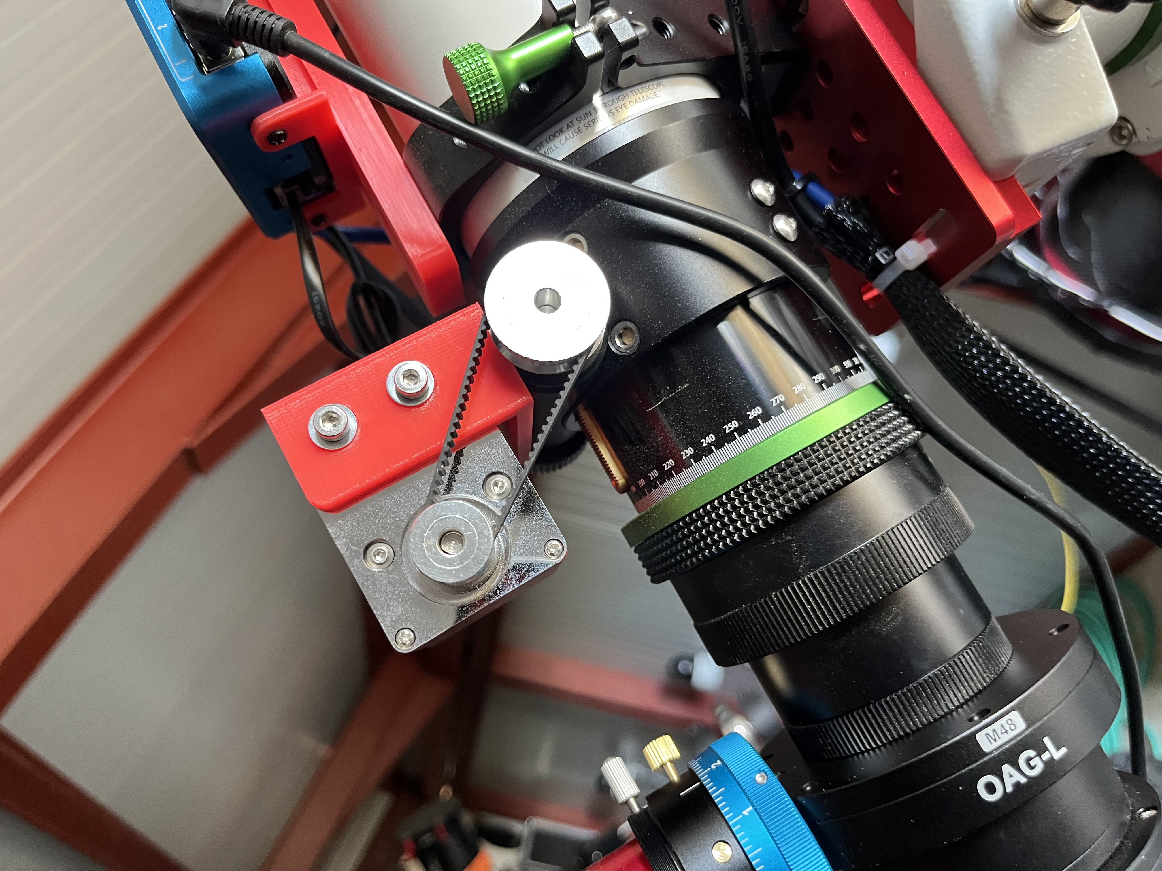

The other thing you could try would be to 3d print a mounting solution that put the EAF unit on top of the scope (mounted on the finder shoe perhaps) then run a GT2 pulley/belt system to belt drive the focuser…. Or, rotate the OTA such that the EAF was pointing 'upward' from the OTA, thus, largely centralising its weight offset… That's how I'd be doing it

I 3d printed a bracket that mounts to the dovetail, and allows you to place an M16 threaded rod heading out to the side of the scope (away from the EAF) and then used a 16mm coupler (large nut) threaded onto the rod to achieve balance... that worked perfectly for me.
The other thing you could try would be to 3d print a mounting solution that put the EAF unit on top of the scope (mounted on the finder shoe perhaps) then run a GT2 pulley/belt system to belt drive the focuser.... Or, rotate the OTA such that the EAF was pointing 'upward' from the OTA, thus, largely centralising its weight offset... That's how I'd be doing it
That's exactly what I did. No issues in 7 months of remote operation so far. I just can't stand that stupid EAF hanging from one side 😅 next time I'll just buy ESATTO

you and Alex have a very good solution
do you mind sharing the link for all the metal parts and the belt you bought for this project (are those from a kit?)
and the CAD file (or whatever the 3D design file is called), for that bracket you printed (I think you printed it, or did you buy it?)
astroswell 1.51
The belt size is GT2 160mm, then there's 36 teeth pulley and 20 teeth pulley and 4 M4 screws with washers. I'm not sure what was their length, probably 10mm. I think you can find it all on aliexpress.
Here's the file, I've printed with 100% filled PETG:
65phq-eaf.stl
65phq-eaf.stl
Thank you! IMO, this is a perfect solution for non-harmonic mount users.
