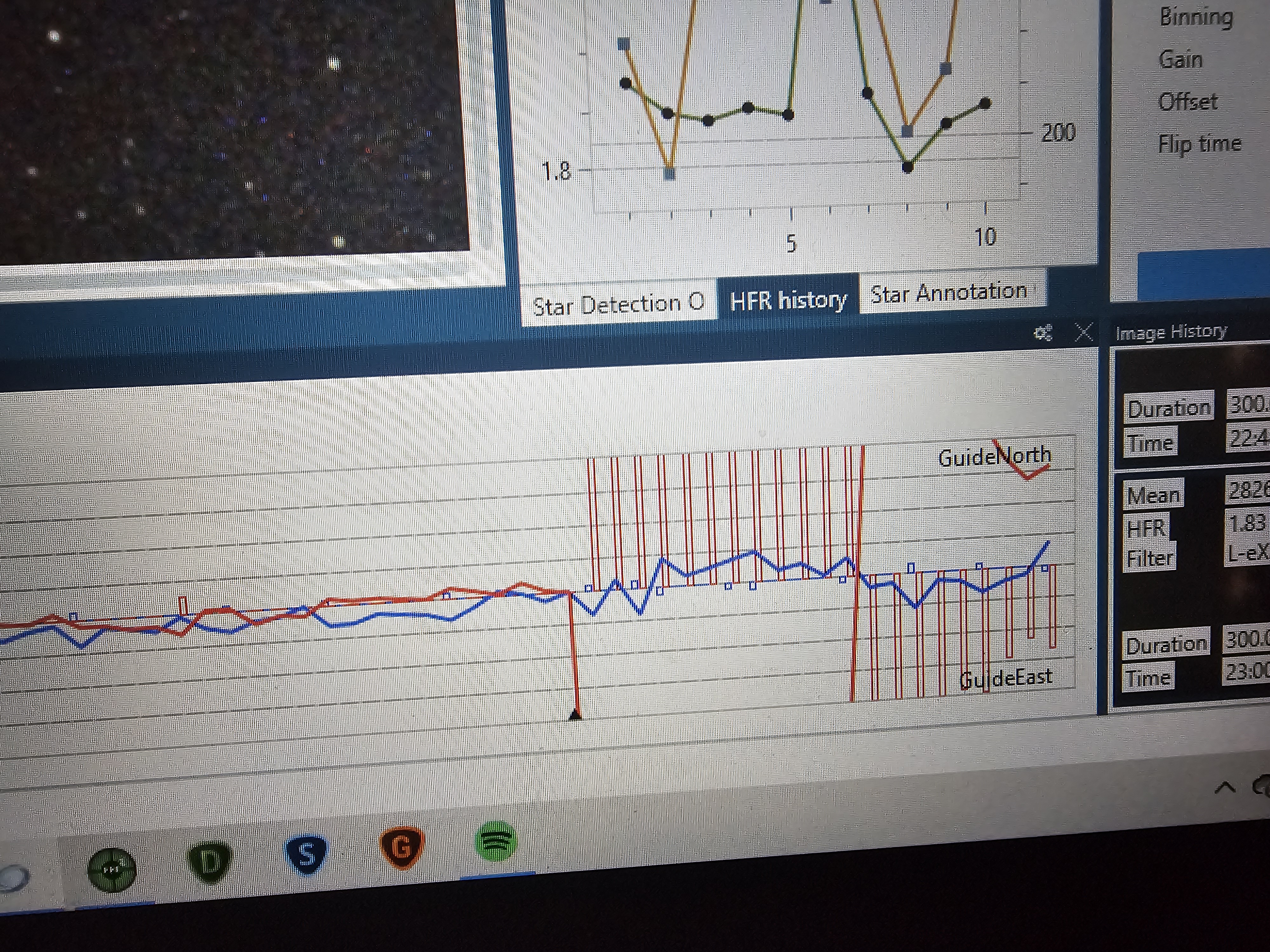

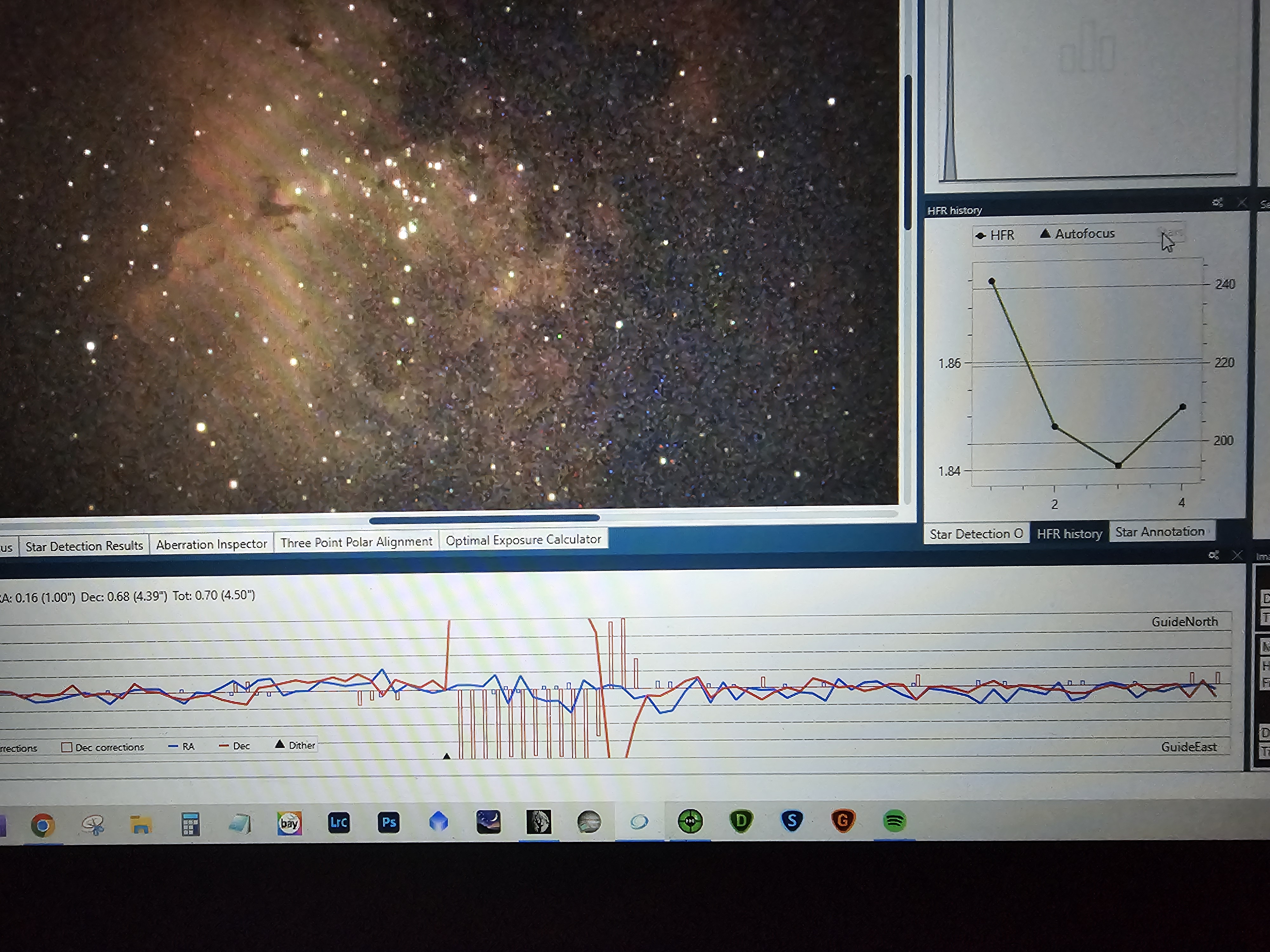

Gee, the mount. Can't see why you might need that info! The mount is a Skywatcher HEQ-5. I do have a powered USB hub. Connection to the guide camera is solid...20240714_223010.jpg20240714_231027.jpg

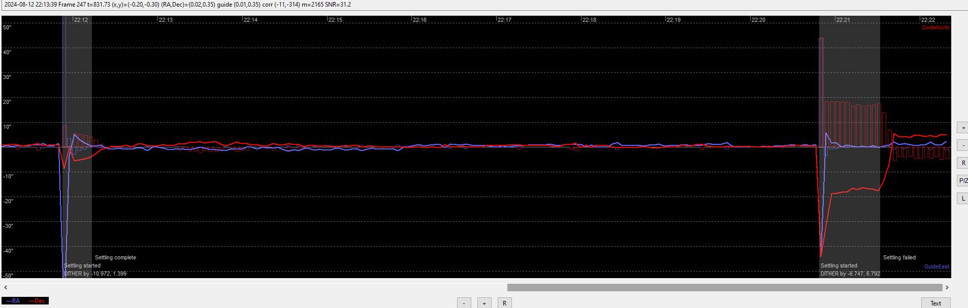

Ok, still  having issues. Downloaded PHD2 Log Viewer. It seems that my mount suddenly stops responding to the Dec pulse guide and then suddenly overshoots. Is that what I'm seeing? And if so, the cause is backlash maybe, or maybe time to regrease the gears? Why is it mostly only showing up during dithering? Am I on the right track here? I exposed the gears in my HEQ5 and I didn't notice any real difference in backlash between the RA and Dec gears. And everything seemed as I remember it when I first opened it up a year ago. Thanks in advance!

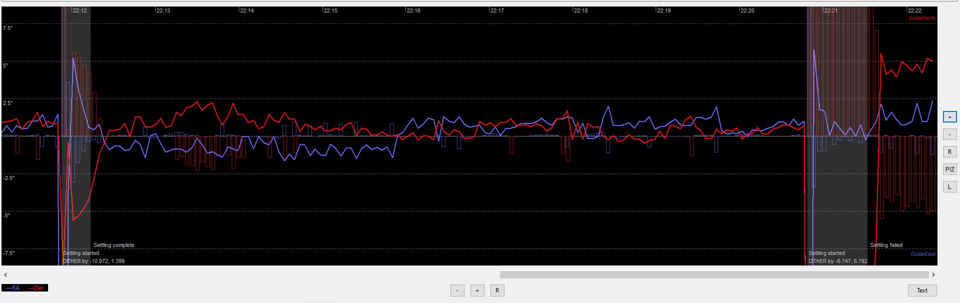

Same Time Period, Zoomed in on the Y axis:

Hi, according to the graphs I see, it seems that DEC is having a lot of backash. When you see a serie of pulses in the same direction and the DEC not responding and then overshooting it looks like backlash. Have you tuned PHD2 according to your backlash? The very first thing to do with PHD2 is to run the guiding assistant with backlash measurement ON, and PHD2 will finish with a report telling you what backlash you have and the recommended parameters. If there is a lot of DEC backlash you can decide to live with it and tune PHD2 to compensate it or first try to reduce it by tuning your mount if possible. I have a AM5 that came with too much DEC backlash, I put more tension on the DEC belt, I still have some but PHD2 is managing it knowing that I put the parameters accordingly for the DEC algorithm.

I have this kind of behavior with my EQ5 Pro mount. I tried to adjust the gears of the mount for months without really increase the performance on that. At least in EQMod there is a setting for the DEC backlash. I increased this number and suddenly, the mount worked perfectly well. It was a bit of a challenge to find the right setting, because PHD2 always told me different values. But at least it worked and still does.
In your guiding graphs, you see that DEC is always correcting in the same direction. When the problem occurs, the direction of the pulses changes. This is the best sign for backlash. Oh, this is what @Frédéric Ruciak had noticed...
