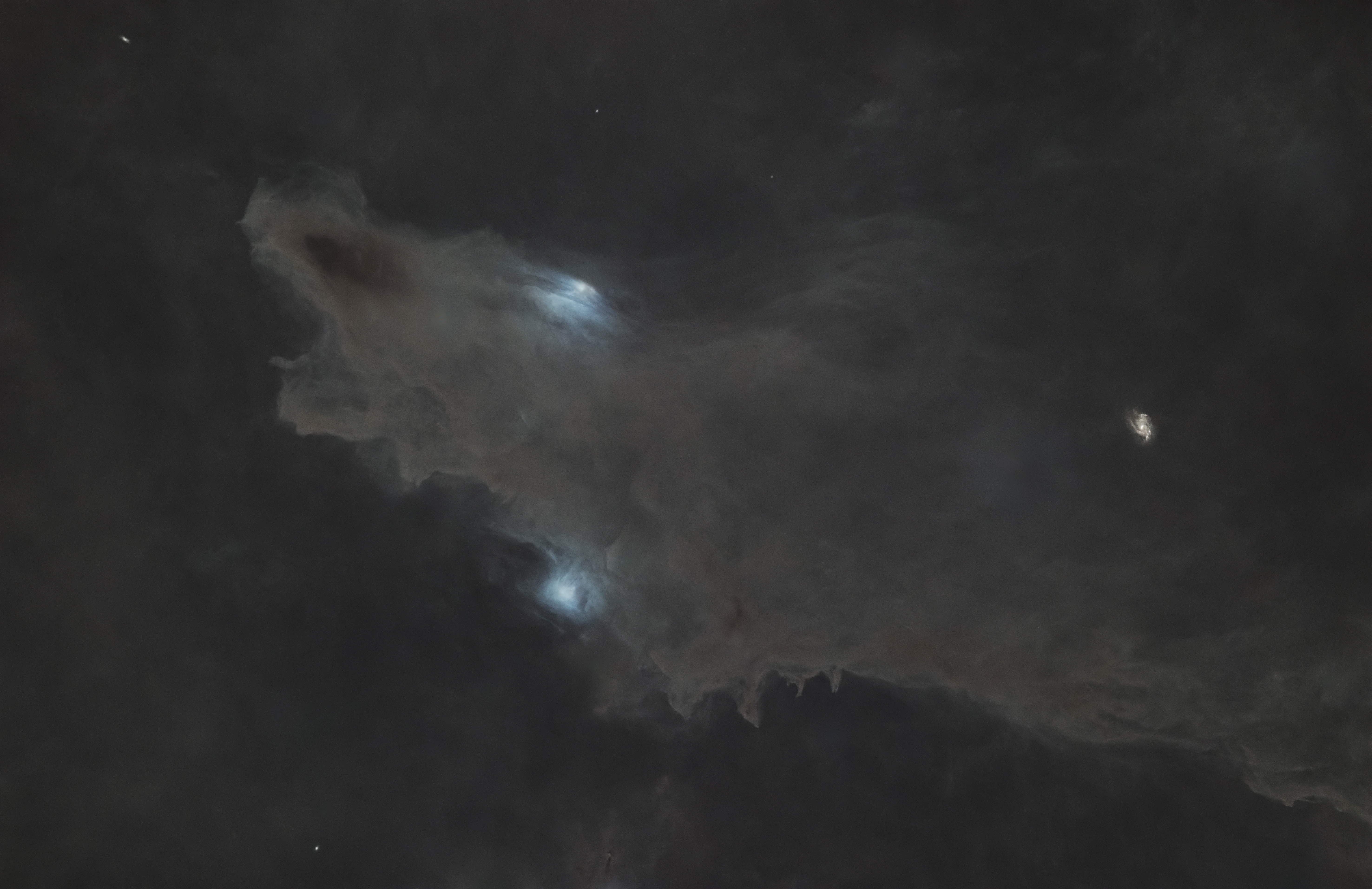

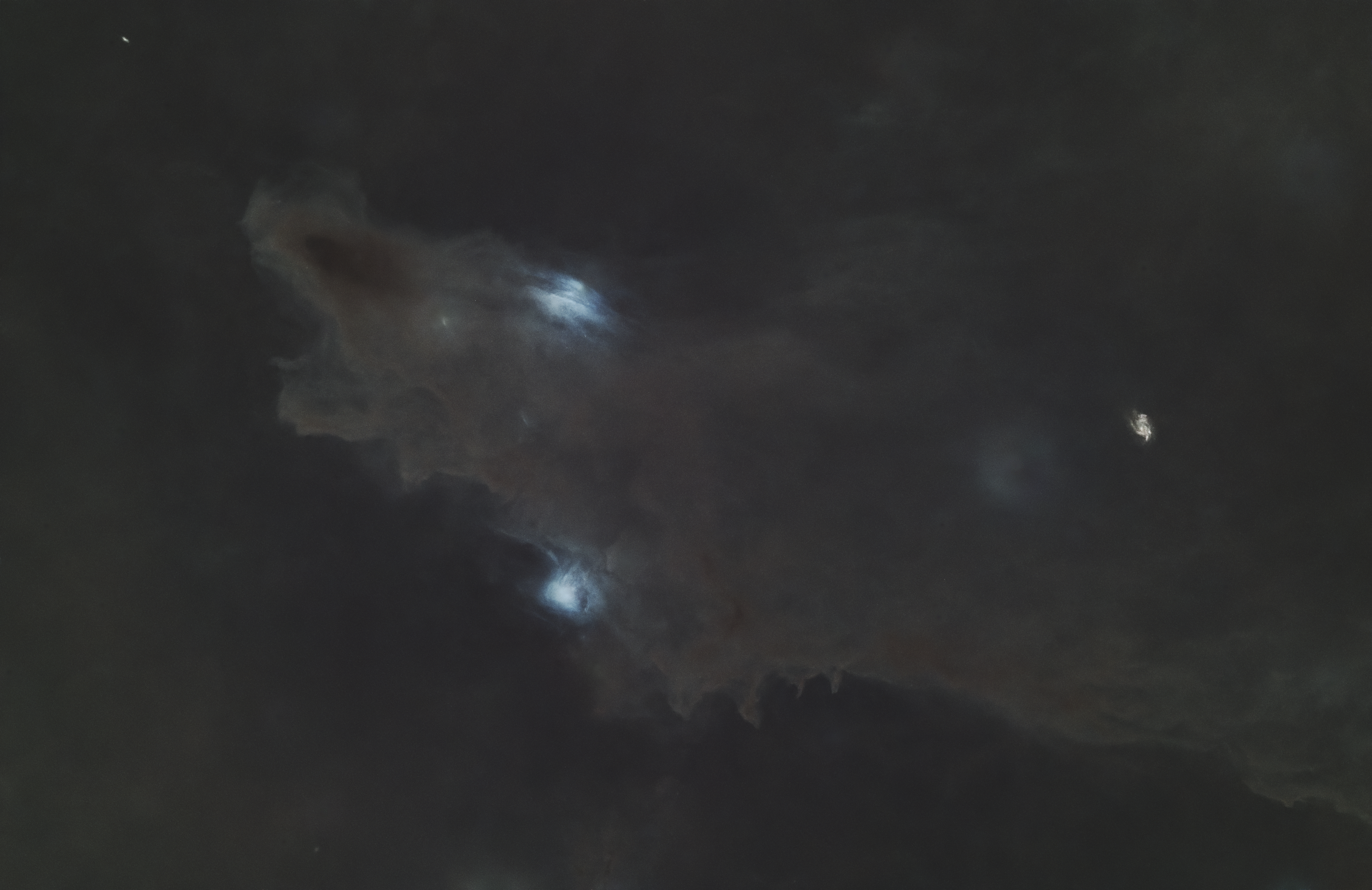

Howdy y'all -- I wanted to demonstrate how much of a difference luminance can make to a broadband image. Most comparisons that I've seen will use X hours of RGB compared against (X + Y) hours of LRGB (where Y is the number of additional hours in L). I don't think that makes for a very fair comparison. This comparison uses the same total integration time for each image: 5.5 hours.
In the RGB image, this is 5.5 hours split roughly evenly between R, G, and B.
In the LRGB image, 2.5 hours is L and 3 hours is split roughly evenly between R, G, and B.
Both images were stacked and processed using the same parameters and techniques. The light frames used in the LRGB integration were selected at random -- I didn't pick the best frames out of the bunch. Stars have been removed to allow for easier comparison.
Data acquired during a new moon in bortle 4. Details about the gear are on my astrobin post: https://app.astrobin.com/u/ThisIsntRealWakeUp?i=3i5tls
LRGB (click to open the full size):
If you ask me, the LRGB image is clearly superior to the RGB image. This demonstrates the benefits of a mono camera vs OSC, even for broadband imaging. (Though do note that an OSC camera also has the downside of bayer interpolation, which reduces sharpness. This is not represented here because both images were taken with a monochromatic camera).

i agree the lrgb looks more detailed. by quite a bit.

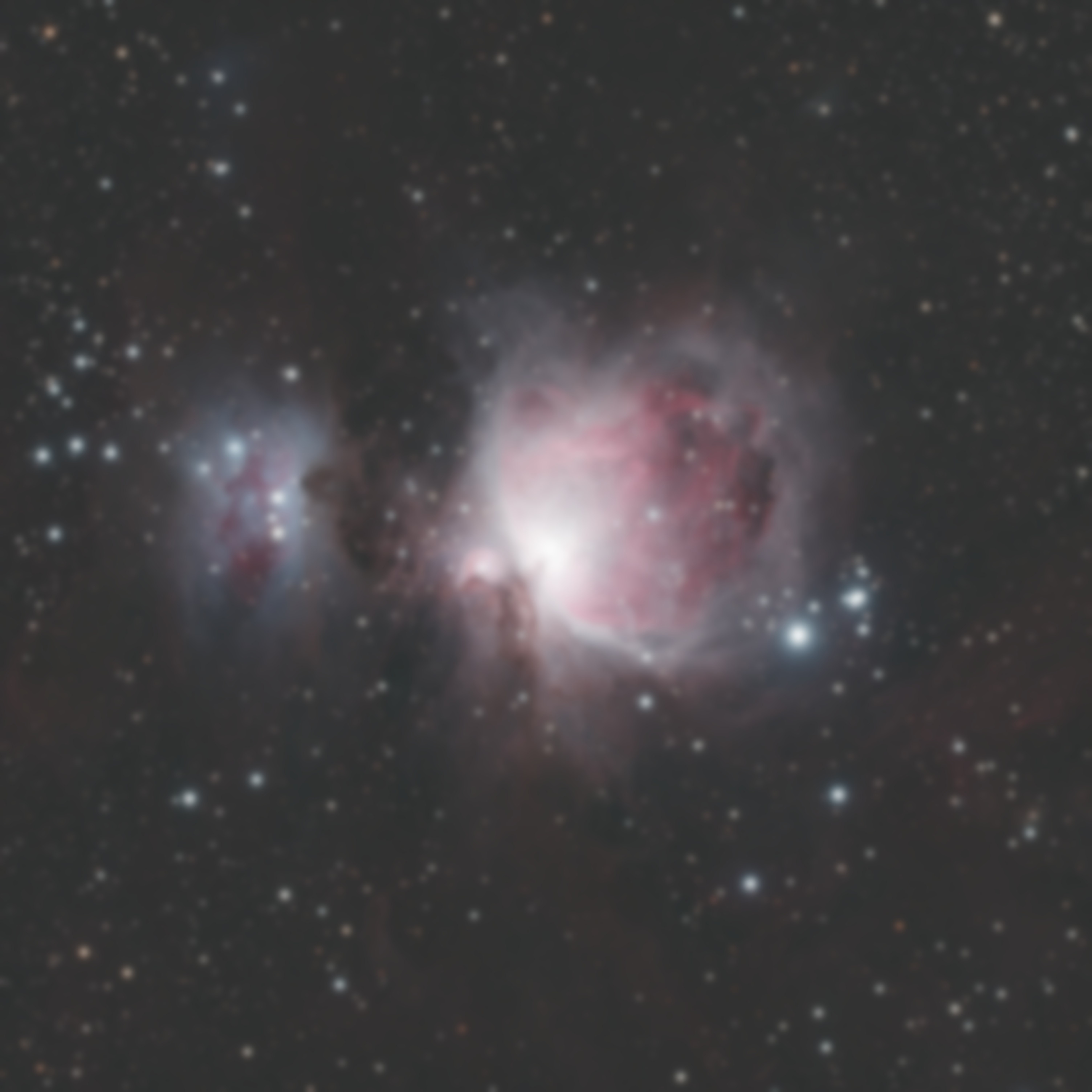

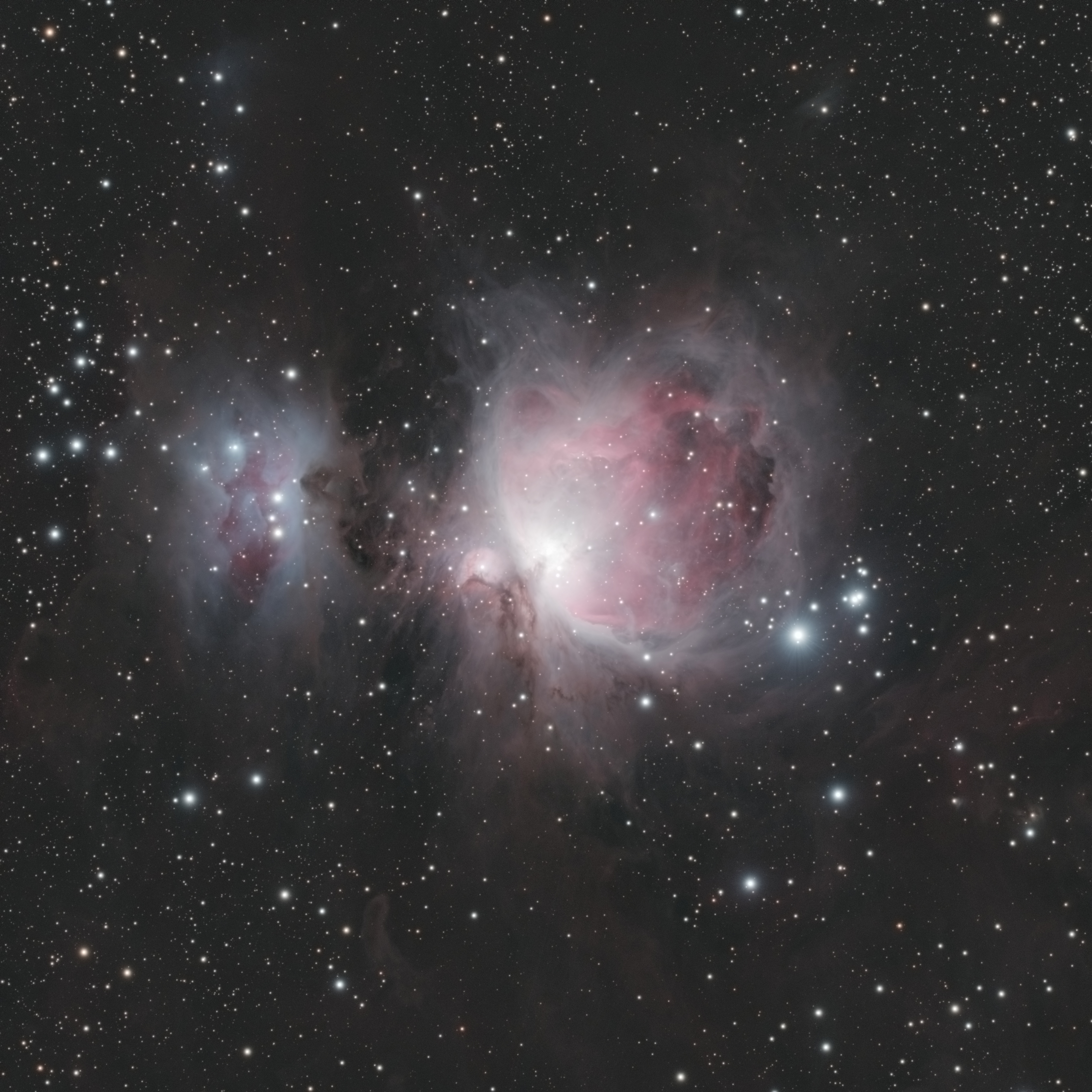

The go-to ratio that I see is 4:1:1:1 L:R:G:B. But I've never seen someone experiment with this nor do I know where this rule of thumb comes from.
In the future, I plan to experiment with ~25 each of R, G, and B (or however many is needed to ensure I have no walking noise or dry pixels after a drizzle integration) and then the rest will be only L. This is because you can aggressively denoise your RGB data before applying your luminance with very, very little noticeable degradation from denoising your RGB data. To demonstrate this, here is a comparison where I applied L to a blurred RGB image versus applying the same L to the unblurred RGB image:

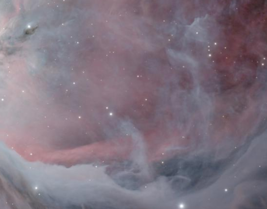

Blurred RGB, to give you a sense of how much I Gaussian blurred my RGB before applying L:
L + Blurred RGB:
L + RGB that was never blurred:
Really the only difference that I can easily spot is that there's no chrominance noise in the L + blurred RGB image and that smaller stars have lost their color. So I think that you can safely denoise your RGB stack pretty aggressively before applying L. Which means you don't need to spend a lot of time gathering RGB to get a high SNR in the first place. But I'll play around with this some more and see how it turns out in my future images.
Though like you said, I bet there are some targets where it's important to not skimp on your RGB integration. Like if you want fine color detail in small galaxies, perhaps.
Editing to add: To be clear, I don't think you should denoise your images by using a Gaussian blur. This is just to demonstrate how sloppily you can denoise an image while still being able to pull back a lot of the detail with luminance.

To cut down on chrominance noise without losing much luminance detail in the RGB image, I extracted the luminance of the RGB image after channel-combining and doing an initial stretch. I then processed it the same way I processed the real Luminance for the LRGB image.
I did it this way for two reasons:
1. I wanted to give the RGB-only image its best chance, editing it as I would if I were an OSC camera user or someone without real luminance data to work with.
2. Because I knew that I would be doing some processes specific to the luminance of the LRGB image, and I wanted to keep things as apples-to-apples as possible. So I didn't want to do some edits to the real luminance without doing the same edits to the extracted luminance.
So not quite the same as making a synthetic luminance with the ImageIntegration tool. But I did extract the luminance from the RGB image and process it as if it were real luminance data.

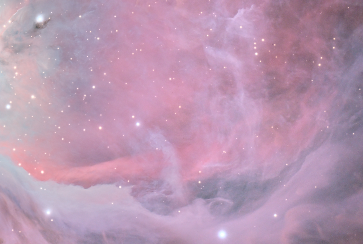

I have had some success combining lum data from my mono camera with OSC data I captured last year - as has been outlined in prior posts, the lum data for an LRGB image is VASTLY more important than the colour, so I can take my 11mp OSC data from my 294 colour, and use lum from the ToupTek ATR2600M and create L-OSC images that benefit from the detail the 26mp sensor provides, with colour data that is FAR less detailed.
Here's a crop from the OSC data, then the OSC data with the 2600M lum utilised.
Worth noting - that's the same colour image used - but the Luminosity drove the brightness and sharpness up rather dramatically...
