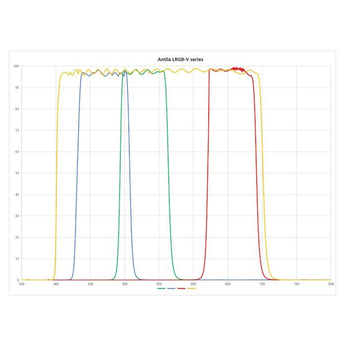

lrgb-v_spectrum_curve_4.jpg Here is the spectrum of the LRGB filters that I use.
, That's about what I expected, overlapping B and G with a notch between 565 and 620.  Did you do the L channel or just RGB?
