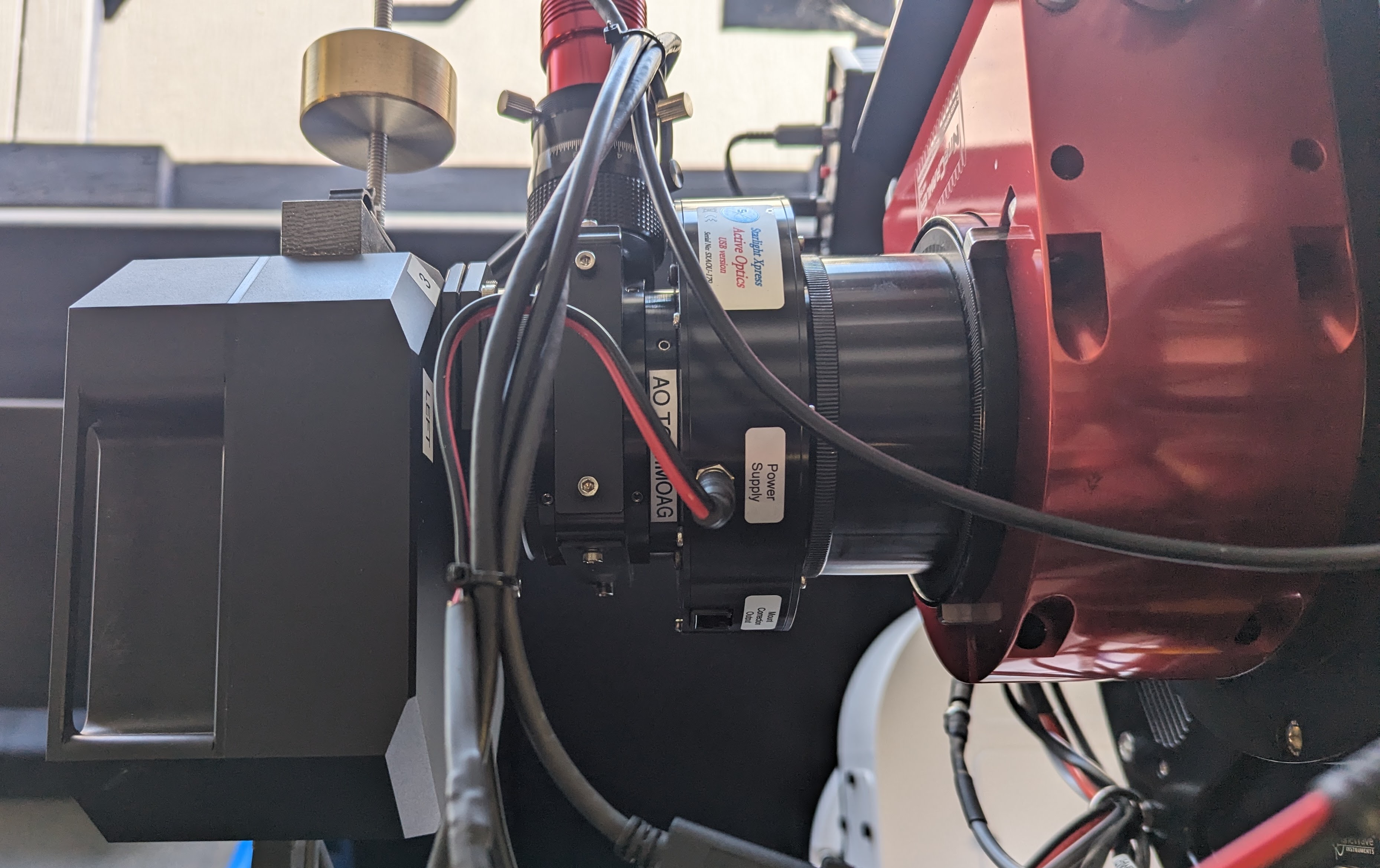

I have two of these, a main unit and a spare. I have used them on a TOA 130/Paramount ME, an AGO 10 inch iDK/Paramount ME, and currently on a Planewave CDK 14/Planewave L350. They work great but do take a bit of getting used to in terms of setup and operation. Once that is done they work very well.
I have used the original SBIG mirror type AO as well back in the day but SBIG is kind of yesterday's news and I have not used one of theirs in years. The SX unit will work with pretty much any camera and OAG if you have the right adapters, usually from Precise Parts.
I chose it because it works great with PhD. That is mostly because one of the original PhD programmers, Andy Glasso, had one and that was used to develop the support for it within PhD.
I would ignore all the nonsense about "high speed guiding" using teeny sub-second guide exposures to give you clearer images. It will do nothing for crap seeing. That will cause more problems than it solves. Treat it as an "optical guider" that takes some of the load off the mount. It is easier to move a one oz. glass plate precisely than a 50-150 pound mount. I typically use guide exposures between 5 and 7 seconds with my CDK (2563 mm) but that is with a high end direct drive mount that already has great tracking.  In fact, it will help with a poor mount but will not totally fix a bad mount because that would involve the aforementioned short guide times that are best avoided for many reasons.
The bottom line is that it makes guiding less "fussy" even with a good mount and with a less than ideal mount may help at least some, although that has it's limits. Current setup with Nightcrawler and Astrodon MMOAG and Moravian camera shown:

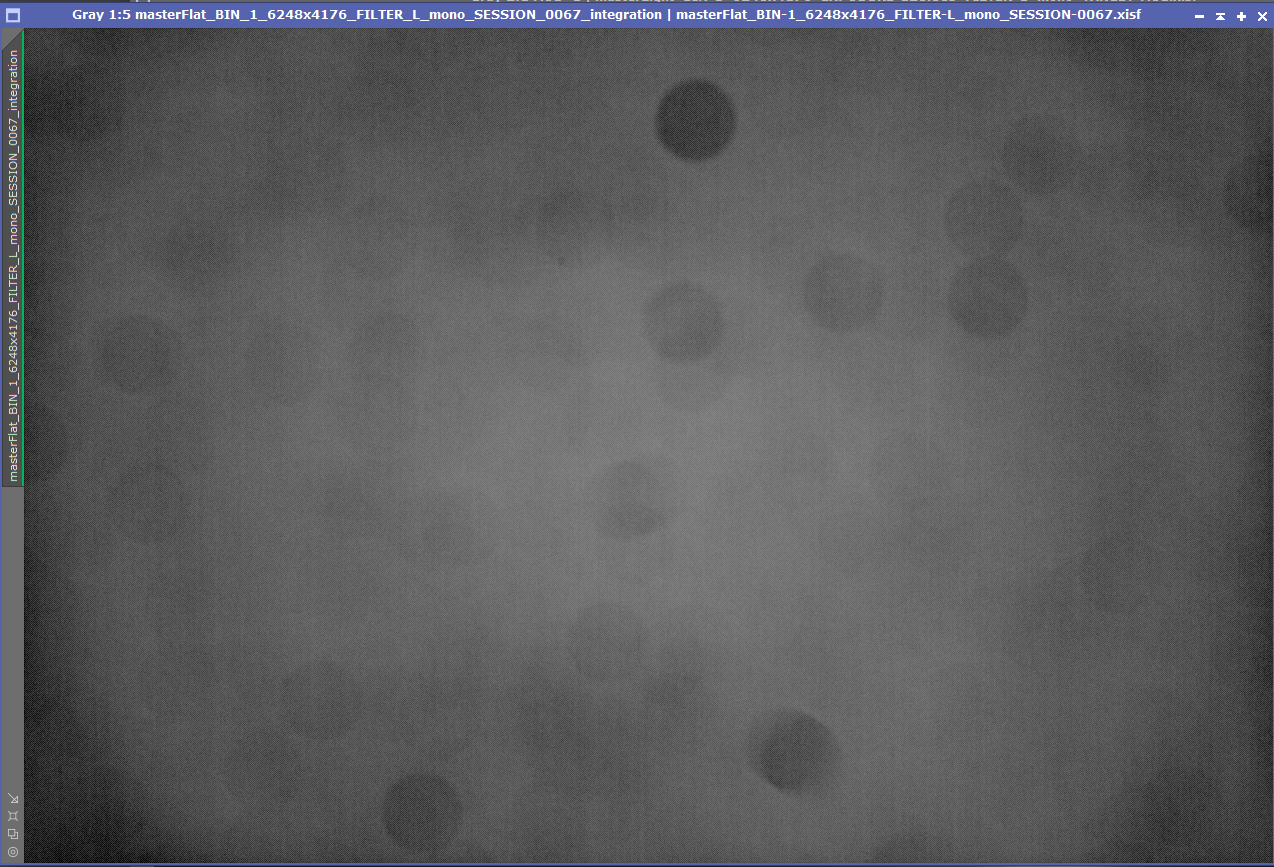

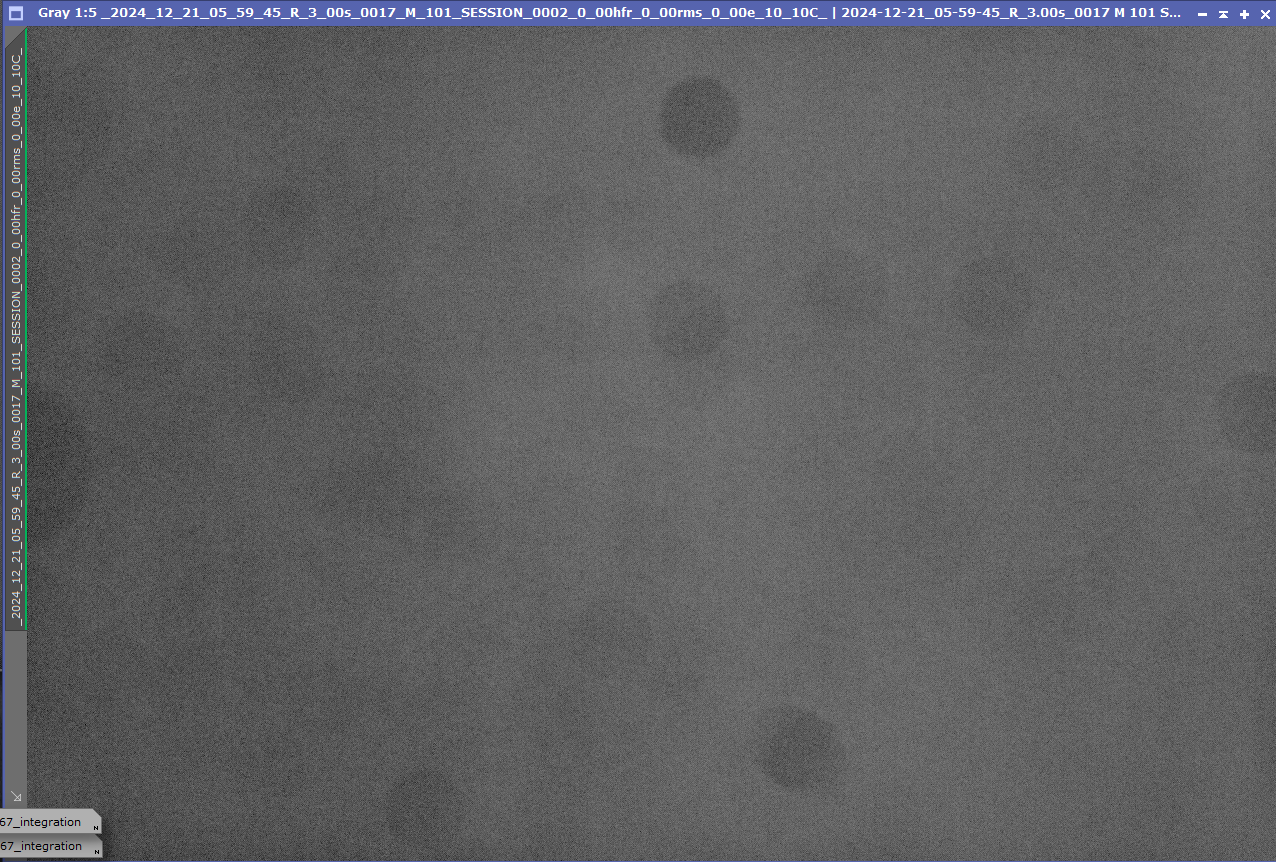

Those who use the AO unit from Starlight Xpress, have you had trouble with your calibration frames?
After fiddling with one for a while I finally started to use it an anger last night and in the morning when I stacked my subs I noticed circular gradients throughout the field.  I took a look at the mast flats and this is what I'm seeing:

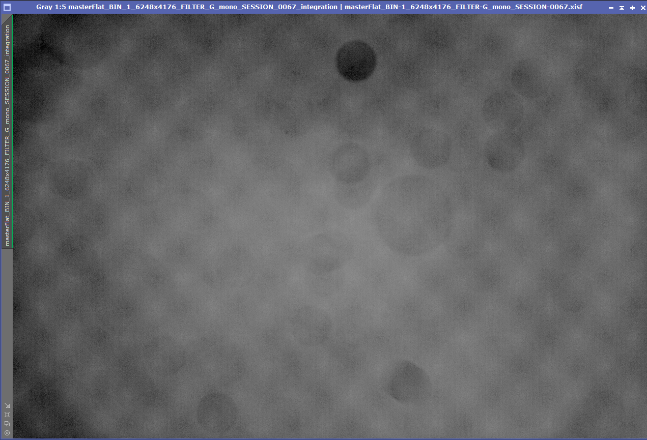

Green:

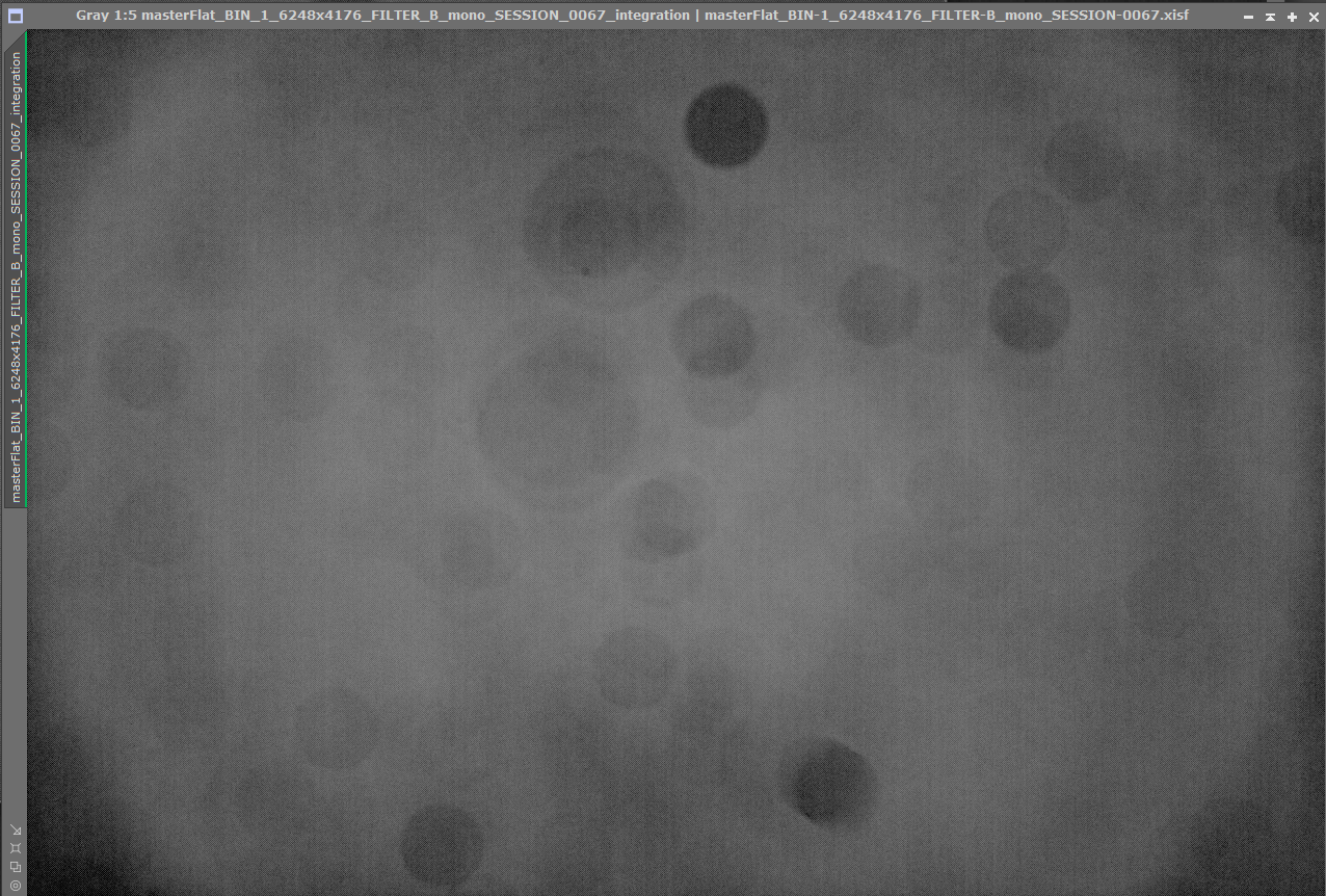

Blue:

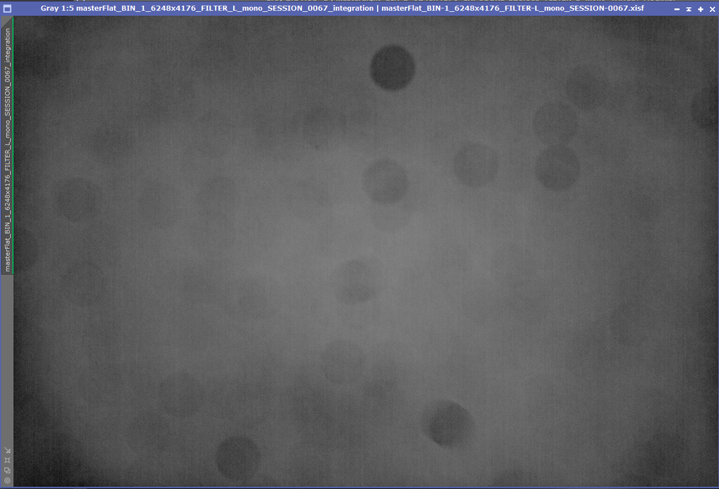

Lum:

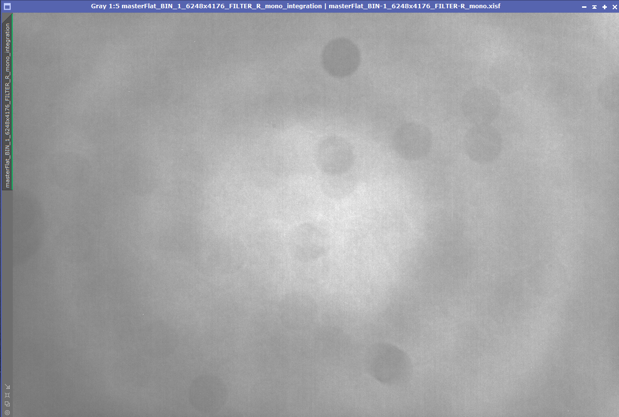

And here's what a Red flat looked like before I installed the AO device:
And those circular gradients are showing up in my masters:
red master:
Got a nice fat circular gradient that aligns exactly with the flat.
I'm fearful that the light from the image was taken at a different "tip" angle than the light from the flat and what I'm seeing is the master is the residual.
Has anyone else had a similar problem with these devices?

CCDnOES 8.34
I have not seen any issues like that. I do always take the flats with the AO powered up and connected to Phd (which centers it), but of course not guiding. I suppose it is possible that the tip/tilt plate was in an odd position for the flats. Or maybe some interaction with the Paracorr, but who knows?
kevinkiller 2.11
Yes, this was taken with the AO device powered immediately after all the subs for the target were taken (via the "Immediate Flats" instruction of the Target Scheduler plugin)
The AO unit is connected to the focuser tube of an Askar 107PHQ (petzval design) so it's quite far from the lens elements in the telescope and the OAG/FW/Cam is attached directly to the other side like shown in your picture.
I'm assuming the FW is built in to your camera?

Your RMS would have been fine at that pixel scale, as the oscillation is below the pixels resolution. Seeing is your biggest issue, but the AO can help with that too. My 6R guides similar and I end up being close to diffraction limited at .58" pixel scale on my EdgeHD 8.
As for the flats issue, you have introduced another optical element, and as far as I can tell, it seems to not be optically flat or transparent either, which can cause issues with the flats.
Another theory is internal reflections from the AO itself.
