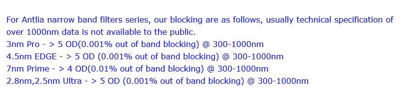

Jacob Heppell: Let me know when you find your spec sheet. I was able to find the one for my OIII filter and I imagine the others are similar. It goes from 300 to 1150 nm and is specific to my filter. Peak %T is around 97%.
Arun H:
I was able to find the one for my OIII filter and I imagine the others are similar. It goes from 300 to 1150 nm and is specific to my filter. Peak %T is around 97%. Nice!!! That's what I like to hear. How does Chroma compete these days when the equivalent Antlia filter is about a third the price for something that I "guesstimate" is at least 90% as good.

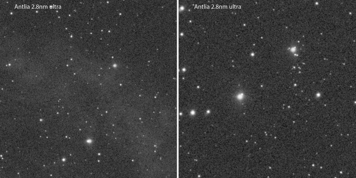

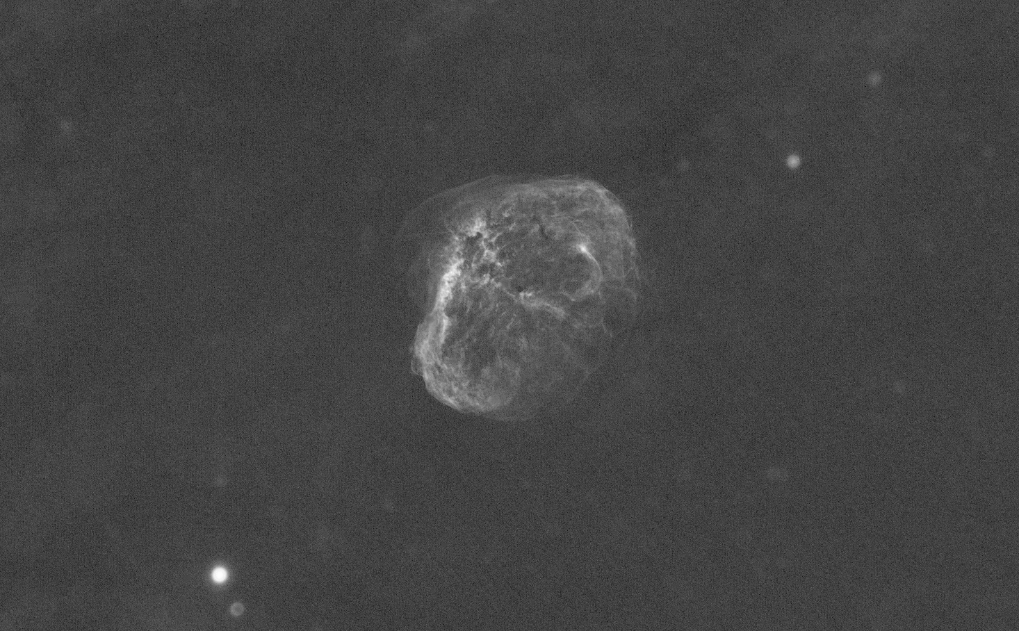

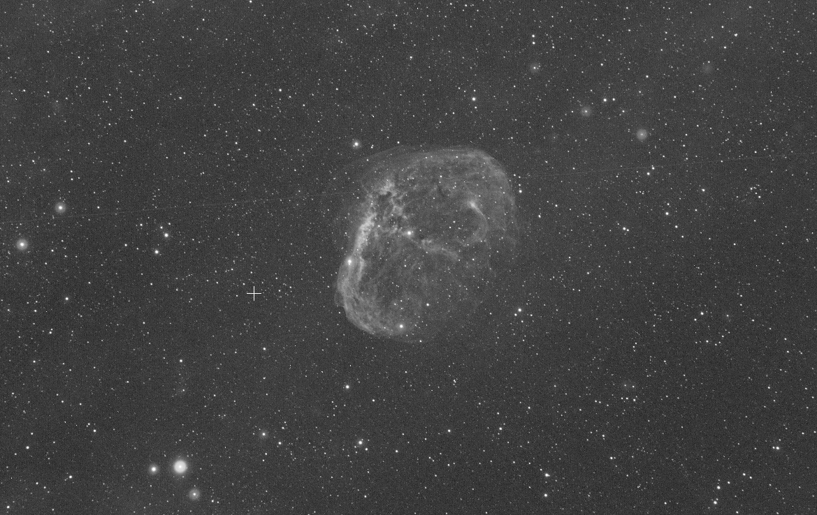

I live under a Bortle 4.5 sky. For the tests I had the filters side by side in an EFW 7x36mm on an ASI2600mm pro. First I compared the 2.8nm ultra with the 6nm Astronomik. For the test, I took 8 shots with each filter in turn. The Antlia showed significantly more contrast than the 6nm Astronimik, but it had problems with IR stars (MIRA stars and LPV stars) at more than 30 positions of the test image.
Here a cropped gif that shows the better performance of the 2.8nm in the nebula but also atrifacts on 2 IR stars at the bottom and the left side:
My dealer sent me an Antlia 3nm pro for testing. In a side by side comparison with the 2.8 ultra, I couldn't see any significant differences. Only in extremely faint nebula areas did the 2.8nm seem to show minimal, but hardly recognizably better structures, even when stretched strongly. That's why I would have liked to keep it. However, because of the problems with the IR stars, I decided to go for the 3.0 pro in the end. My dealer contacted Antlia at that time but they did not offer a replacement nor a useful explanation .
I was able to find the one for my OIII filter and I imagine the others are similar. It goes from 300 to 1150 nm and is specific to my filter. Peak %T is around 97%. Nice!!! That's what I like to hear. How does Chroma compete these days when the equivalent Antlia filter is about a third the price for something that I "guesstimate" is at least 90% as good. This is exactly how Chroma competes from my point of view. A customer service that doesn't say "there is no problem with our filters go check it out yourself if you don't believe" when there are IR stars appearing on your image out of blue. You either pay extra for professional customer support or you gamble with your cheaper option. I have seen a lot of people's different complaints on the cheaper option, but almost never with the other. Still, I have to criticize, I find Chroma too expensive for the purpose. Not even talking about working conditions that we support.

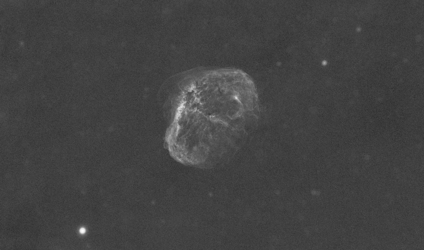

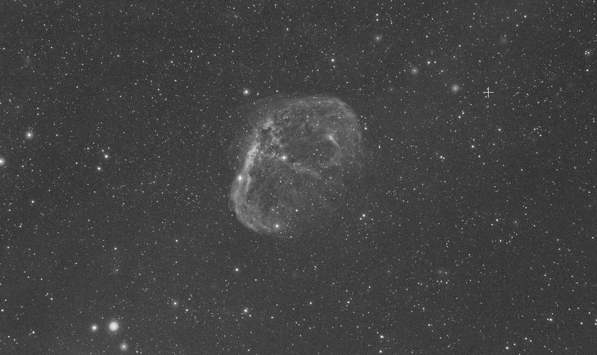

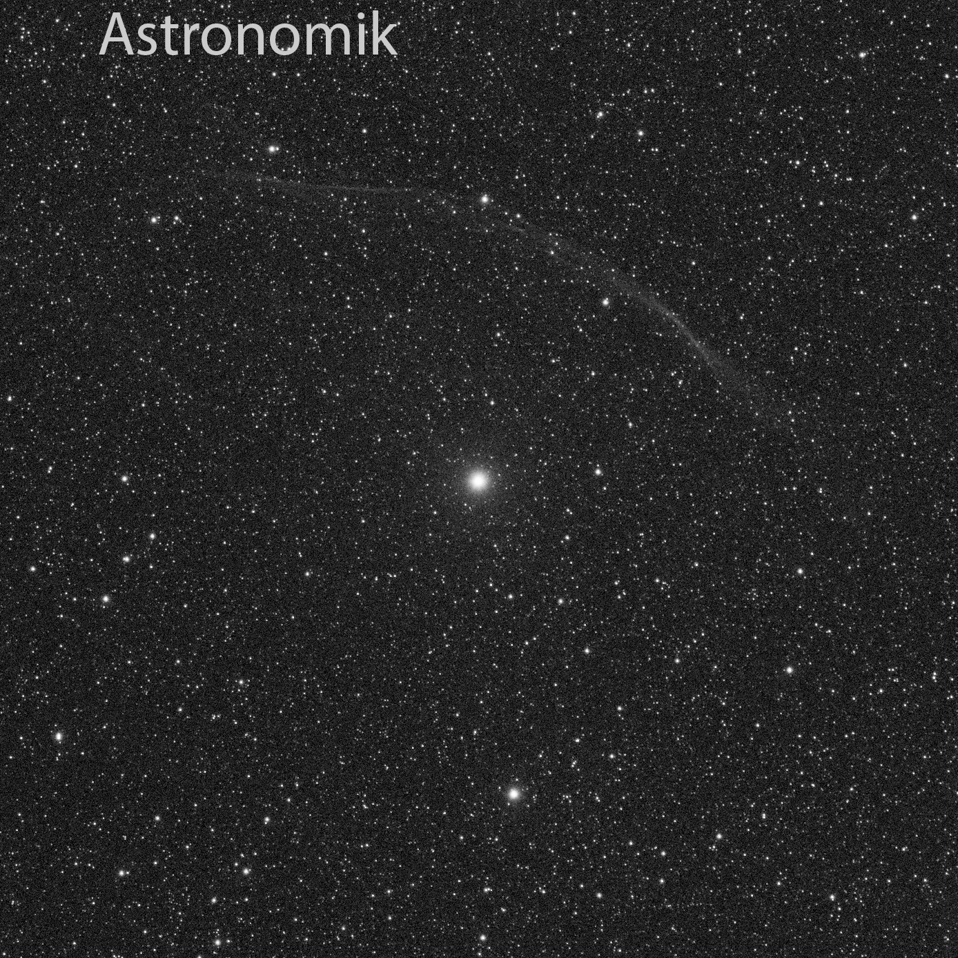

If it's any help, I just purchased a complete set of the new 36mm unmounted 2.5nm SHO filters along with the LRGB Dark series.
I ran the filter offset calculator in Nina about 10x (instead of default 3x) and it came back nearly parafocal (maybe 1-2 steps between filters) on my Esprit 100ED with a ZWO EAF focuser from my B7 backyard here in Texas.
For 3 nights I shot the western veil in a LRGBSHO 60/90/90/300/300/300 round robin schedule to check for halos on 52 Cygni and there were none with my 2600MM This is in contrast to my Player One Anti-Halo Dual-Narrowband Pro filter which did produce a small halo with my 2600MC.
My scope is sitting on the shelf at a remote observatory waiting to be installed so I can't test further at this moment, but from the testing I did I was amazed at how much better the images came out with the mono+2.5 filter setup. My HFR went from 2.2px with the PlayerOne+2600MC to 1.6px with the 2.5+2600MM consistently over 3 nights. (3 nights with 2600MM and 4-5 nights with 2600MC).
Hope this helps.
Here's a link to the masters if you want to compare yourself: https://drive.google.com/drive/folders/1v_9pME4EA_evx6oFNm82iwqNmpddU3lz?usp=sharing
Note: The 2600MC_[Ha,Oiii,Sii] are extracted from the dual-narrowband masters with DBXScript Thanks a ton for the insight. This is exactly the kind of information I am looking for to make my decision. I'm really glad when I got into this hobby 3 years ago, that I started with the 2600MC, the images are amazing and it's relatively simple to work with. I became instantly addicted to AP. When I upgraded to Mono, it increased the complexity more than I anticipated, and along with having to triple your imaging time, it's definitely been cloudier the last year. I used to be able to image any night I wanted to the first couple years in Colorado. Had I started with Mono, I might have given up, but yes, the quality is just next level. Sometimes I'm blown away at just the initial stacked images from a single channel, before any processing! Detail that wasn't even in the OSC images, easily shows up with Mono, and detail that was in the OSC images, but not noticed, becomes in your face obvious.

I certainly discovered that when I put an UV-IR blocker on my coma corrector, the artefacts from my dodgy 2.5nm OIII filter disappeared. There is certainly no harm in having the UV-IR blocker and I did briefly contemplate doing just that but I was persuaded to chase up Agena/Antlia for a replacement. Glad I did! One thing I didn't think to ask and may not have made clear, but I am not planning on replacing the whole set of Optolong Filters, just the OIII, so is there any issue with imaging SII Ha in 3nm and the OIII in 2.5? I wouldn't think so, even if the OIII ends up being better, sharper data, I don't think it would throw of the balance of the channels significantly, that would make it look strange.

So my Antlia 2.5nm OIII filter showed up yesterday and I was able to take a few images before the clouds hit. But, still have the halos. Not quite as bad as the Optolong, and I have a feeling the image quality will be a little better, less background noise or light pollution in the OIII band. Here are the comparisons between the Optolong 3nm and the Antlia 2.5 nm. Both are just 6 x 300s frames stacked. The DSS image scores were about half on the antlia(400 - 600) as the optolong (800 - 900), but that was probably more due to atmosphere and possible cirrus clouds. Optolong 3nm OIII  Antlia 2.5 nm OIII  I always remove the stars for processing and then add back, so this image isn't as important as the next set, showing the stars removed with StarXterminator. I reached out to RC, and he said the software isn't designed to remove the inner reflections created by the bleedthrough from these filters. As you can see, it's able to remove more on the Antlia than the Optlong, but still not even close to perfect. Although it's easy to remove them with the blemish tool in Photoshop, the large star in the Squid nebula creates a halo that runs right into the actual squid nebula and it's pretty much impossible to remove without creating a mess where the nebula and halo meet. Optolong 3nm OIII Stars removed - Once you start stretching the image, all those little faint blobs become VERY noticeable.  Antlia 2.5 nm OIII stars removed.  |
