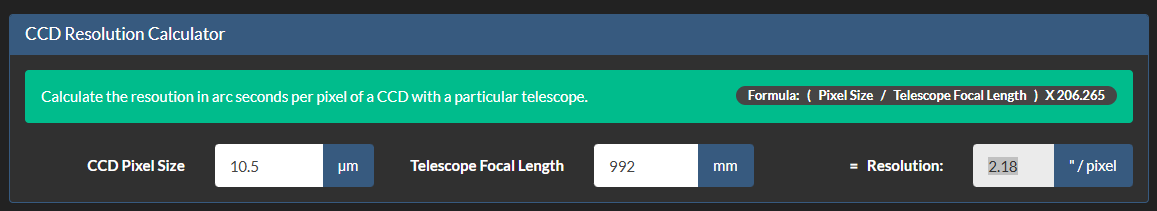

I recently became aware that the airy disc size on my TOA-130 telescope in green light is ~10.5 µm.  (In fact, the airy disc size is only governed by f-ratio so all F7.7 telescopes will have this airy disc size regardless of their aperture).
When I calculate how much of the sky that airy disc covers it comes out to 2.18" with the TOA + 645 flattener.
When I go checkout the spot diagrams of the Takahashi 645 flattener I find 1 µm spots RMS on-axis and 2 µm RMS at full-frame.
https://www.cloudynights.com/topic/822975-toa-130-toa-150-and-645-flattener-results/
What I don't understand is why are this super small spots prized when the airy disc is 5x - 10x larger?

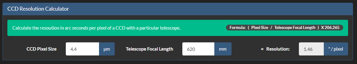

Also, the TOA is known for being a super sharp telescope but how can that be when it's airy disc is so much bigger than what's you get with say a RASA 11 with <4.4 µm RMS spots with and airy of 2.96 µm.
https://www.celestron.de/media/mageworx/downloads/attachment/file/1411/RASA_BOOKLET_11in_36cm_2018_LR.pdf
While the RASA the optics are not diffraction limited (what you see is governed by the RMS performance instead of the airy disc) but even then it has 50% better resolution than the TOA-130...  [1.46" * 1.49 = 2.18"]

I believe this is what I'm doing when I compare the 2.18"/airy-disc on the TOA-130 with the 1.49"/RMS-spot from the RASA11.  An arc-second is an angular resolution, right?
The RASA11 has a smaller angular resolution for it's airy disc diameter.  FOV is about sensor size.   A camera with 3.76 µm pixels sample the light-spread in the image plane by a factor of ~2.8x [10.5 µm / 3.76 µm] for the TOA and by a factor of  1.17x [4.4 µm / 3.76 µm] for the RASA 11.
The RASA needs a very small pixel camera in order to sample it's RMS-spot appropriately.     A camera with 1.32 µm pixels would give you the 3.33x sampling factor.
