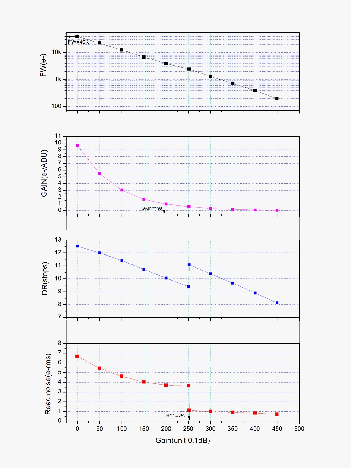

Here are the performance charts for the sensor.
dkamen 7.44
You use lower gain if you are imaging something very bright because dynamic range is your main concern.
You use the higher gain if you are imaging fainter stuff, in which case read noise is your main concern.
Almost every value of gain can be optimal depending on other factors, such as your f/ratio, light pollution levels, exposure time your gear is comfortable with.
I think outside of specific cases such as very short exposures or when you want to capture as much star color as possible (note that big stars will almost always saturate at the center, the question is how large will the saturated radius be), the point where HCG kicks in is just fine (the difference between 255 and the 250 given by the manufacturer is too small to matter).
You say you do not have DR problems so if you were to deviate from 255, it actually makes more sense to try a higher gain than a lower one, assuming you cannot increase exposure time due to mount limitations.
I'm in Bortle-8 shooting at F/6. Exposing for as long as needed isn't a problem although I do like to keep the subs as short as possible. I know I'll have to go longer than I like at zero gain in order to swamp the read noise. I am curious as to why going with a gain higher than 255 would be advantageous? I wouldn't gain much in read noise and I would loose dynamic range.
prookyon 0.00
I guess going to even higher gain would only make sense in case of using very narrow bandpass filters and especially in very low bortle areas as then the sky background electron rate gets so low that suddenly read noise is very important.
Especially as the time required to swamp it is dependent on the square of read noise. So going from 1.2 to 0.75 (guessing from the chart) would mean a time decrease of 2.6x.
And of course nothing wrong with using gain 0, but then again swamping read noise will mean time increase of about 29x (square of 6.5/1.2). But in bortle 8 the sky background is so high that it just means going from a few seconds to a few minutes so … whatever smile

Has anyone tried shooting a 585 sensor at zero gain? I typically run my ZWO version at 255 so that HGC kicks in and drops the read noise but I do give up well depth and dynamic range. Generally this works well as I like to keep my subs short. I haven't run into any dynamic range issues at 255 so I wonder of the extra 1.5 stops of dynamic range would be helpful?
Hi Tony, I don’t have the same camera, but I am in Bortle 8, so I can share my experience and calculations.
Read noise only matters if it adds significantly to your sky background noise, because your background noise is as good as it gets, you can’t get noise lower than that.
In Bortle 8, for an RGB no filter 4 s exposure my sky background is 32 electrons. I run my camera at 1.4 e read noise. So doing the calculation for noise:
Total noise without read noise is: sqrt(32)=5.66 e, as the Poisson noise is the sqrt of the signal.
Total noise with read noise is sqrt(32 + 1.4^2) = sqrt(32 + 2)= 5.83
% noise due to read noise: 100*(5.83-5.66)/5.83= 3%, so read noise is insignificant even at 4 s.
Now if you run a gain=0, 7 e read noise, your total noise is sqrt(32 + 7^2)=9, so your % read noise would be 100*(9-5.66)/9 = 37% noise!
Running at Gain=0, and 7 e read noise if you run 10X longer subexposure, which is only 40 s, you would get: Total noise = sqrt(320+7^2)= 19.2 vs Sky noise = sqrt(320)=17.9, and the read noise is then contributing 100*(19.2-17.9)/19.2=6.8%. Not too bad, but you would probably want to run at least 1 minute to reduce the impact of read noise.
With my narrow band filters in B8, I need 1 to 4 minutes exposure to get down to about 5% read noise contribution. The narrower the filter, the longer exposure I need.
So at 7 e read noise, now you are talking about at least 10 to 40 minute exposures to reduce the effect of read noise. That may be more than you are willing to run, that needs excellent guiding and a very stable setup.
My own opinion is that in most cases there is too much worry about the camera dynamic range for deep sky imaging. The important thing is that your image dynamic range is using the most of the sensor dynamic range in the sub.
So at gain=0 you have 40 K dynamic range. But if you are taking an image of a faint nebula, the nebula itself might be only using 5 K of that range. So your whole nebula image has 5 K levels to define the dynamic range of the image. Suppose you increase your gain so that 5K image now goes to 40 K. Now you have 40 K levels to define you image. Your image smoothness is going to increase dramatically, which will enable you to stretch much faithfully to the input image.
Now that setting to optimize the nebula might very well blow out the stars. The other option is to increase your subexposure, which of course risks too saturating stars. One option if your nebula is faint, is to set high gain or longer subs for the nebula. Then take a second set of images with lower gain/expsure for the stars, this doesn’t need so much exposure. Then with SW today you can separate stars and nebula and combine them both--you get the best of both worlds. In the end it is a trade off, so you will likely need to accept some level of star core saturation if you want to optimize for the nebula. And often bright stars are saturated anyway.
Finally, note at gain=0, you have nearly a 10 electrons/adu detection. That means that 0 to 9 electrons in, gives you zero  signal out! A signal of 10 to 19 e, gives you a signal of 1 out. So you are losing "resolution" of the number of electrons. On your camera I would recommend no lower than a gain of 198, which is your unity gain. That is one electron in gives 1 unit of signal out. And there is benefit to running even higher gain, again to give you more levels to capture the weakest signals. This is because while we always talk about discrete electrons, the signal out is actually a continuous voltage with noise, so having more levels to capture fractional signals can be important for weak signals.
I would not run personally less than unity gain. And I would suggest you look at your subexposure histogram to judge how well you are using the dynamic range of your sensor by using it as much as possible with your image dynamic range. If your input histogram shows no pixels at all saturated, you are probably running at shorter exposure or lower gain than you should be at.
I hope this helps

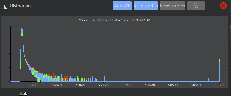

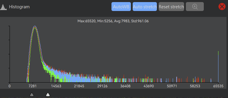

Hi Tony
Looking at your 252 gain image at 60s, you are using the histogram really well, and only saturating a few pixels. I use SharpCap and it shows a histogram with the number of saturated pixels, so one can make a judgement call. My judgement is there will only be a few pixels of bright stars saturated, so this is fine. At this gain you are at 0.5 e/adu, which is great, you are above unity gain. And given you are in Bortle 8 (like me)  with just an IR filter, this exposure is more than enough to make read noise be insignificant vs. sky noise. I would not go to longer at this gain for this target. Doubling to 2 minutes means that anything > about 38000 adu will be >2x38000 is > 66,000, so saturated. Similarly if you half your exposure, you will have virtually no signal >38000, except perhaps some of those pixels that were in saturated cores. So you will not be using all of your dynamic range.
Looking at your 100 gain image at 300 s, you have very little in the upper half of the histogram, >3800 is pretty much empty of data, and you still have some saturated cores. So the histogram here is not looking quite as good. Your read noise here is around 4.5 e, but again based on my experience in Bortle 8, you are not getting much contribution of read noise at 300 s.  That is great. Note here you are at 3 electrons/adu, so you are loosing some electron resolution, you can’t tell 0 from 2 electrons, or 3 from 5 electrons, etc, in your output. Now unfortunately, while increasing the gain from 100 to 150 will increase your signal 2X or 1 stop you will also lose dynamic range, so likely saturate too much. And doubling the gain will not get you to unity gain. You could increase exposure, but that will not obviously get you to unity gain either, and 600 s is getting a bit longer than you might want? I would increase gain to get to unity gain, this gives you two stops or 4 X bigger signal. So you could drop your exposure to 150s, bringing it down 2X in signal. So now your histogram will be better filled. The advantage of going from 100 to 198 gain is that there is virtually no loss in camera dynamic range.
I know this is all quite complicated, there is a lot to think about.
General rules of thumb:
Unity gain is a good place to be, but if you are not filling the histogram you could increase gain, but carefully as you now will lose dynamic range with higher gain. But if you are far away from filling the histogram, higher gain can be good. Of you could increase subexposure, but in Bortle 8, without NB filters, 60 sec is going to be a long enough sub to subdue the read noise, going longer is not helpful, particularly if you have to drop below unity gain.
