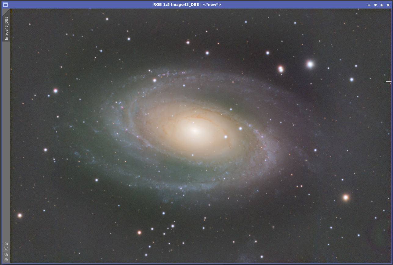

George Hatfield: I processed the 300 second R, G and B masters. Before combining to the RGB I ran linearfit with red as the standard since there was a huge difference in the means. I then ran the RGB through GraXpert which seemed to work fine. Then color calibration with SPCC. I used Astrodon filters. I don't think the filter type makes much of a difference. Anyway, the SPCC curves were very unusual... I have not seen them running in opposite directions in any of the images I have processed. Also the central core is way too purple even when calibrated and the arms of the galaxy look sort of "coagulated." Could there be a problem with the WBPP processing? I don't think any amount of processing is going to help this image. I would go back to the very beginning and start over.
George as I never had the filters right, my SPCC charts always looked weird like this - and yes, the purple core drove me crazy - great you spotted it!

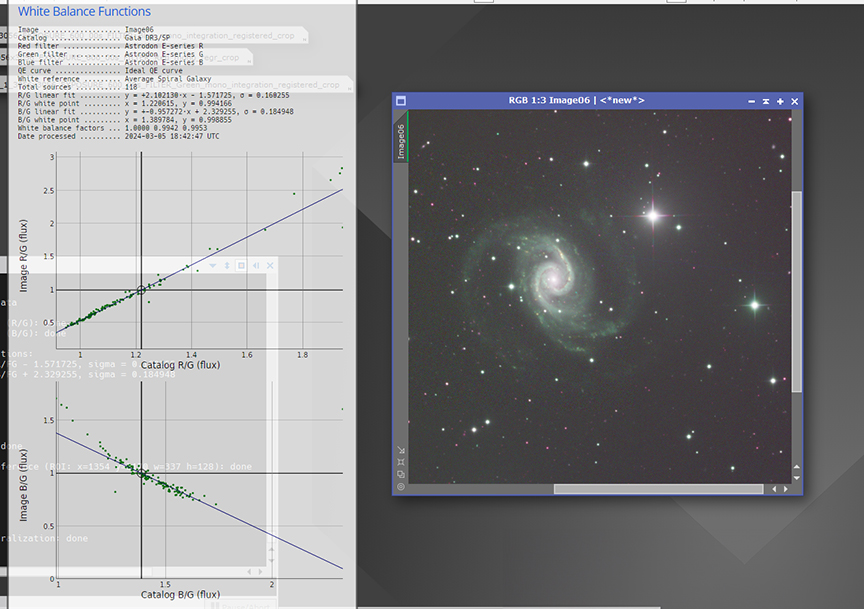

As others have done above, I switched the green and blue masters when creating an RGB and got a similar aberration of colors (too much purple and green) with this image of NGC1566 that I am working on. Also, the SPCC curves showed the same slope reversal for one of the curves. One question that remains for me is how this mixup occurred. The file names were wrong and looked like something WBPP may have created. Did it somehow misidentify the filters of the subs it was processing? George  |
George Hatfield: As others have done above, I switched the green and blue masters when creating an RGB and got a similar aberration of colors (too much purple and green) with this image of NGC1566 that I am working on. Also, the SPCC curves showed the same slope reversal for one of the curves.
George I believe he mentions that he has swapped them physically, which then leads to the wrong filename.
George
yes, stupid me changed filters after cleaning and putting SHO first in the wheel. Replacing them I must have put them in the order RBG but named them RGB - everything from there forward was a mixup. Only that I believed its normal to have a magenta bias always …

The linear data looks good and sharp, but it comes off quite purple. I wonder if the channels might be mis-labelled? It seemed a lot better when I did RBG (based on the file names) rather than RGB..
Edit: Added a screenshot of the unlinked STF for that particular combination
 Arny, I reversed the green and blue as was done above, then did an RGB integration, SPCC, Histogram transformation and used Noise and Blur Xterminator and minor color saturation. I was wondering if it is possible you have the green and blue filters swapped in your filter wheel after looking at the results here.  |
