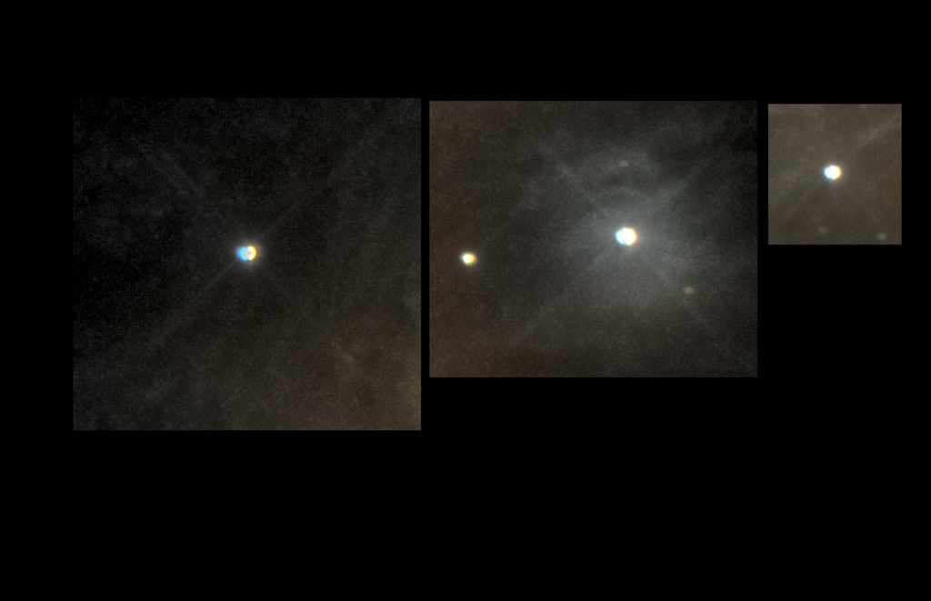

It's the same direction across the image, only on the brightest stars. BlurX doesn't get rid of it except for the faintest ones (correct only). I tried channel match, and to correct the big stars, the small ones are way out of whack. Does anyone know what causes this? Maybe how to fix it?  |
What causes this is obviously your optics and it is called lateral chromatic aberration. So what was the telescope used? It might be possible to reduce it but not entirely eliminate it. To tell, I'd need the raw files.
Did I have the same problem?  For me though, it was with a newt, without a coma corrector. But I think the problem went away once I recollimated.
andrea tasselli: What causes this is obviously your optics and it is called lateral chromatic aberration. So what was the telescope used? It might be possible to reduce it but not entirely eliminate it. To tell, I'd need the raw files. It's a 65phq. Subs were over several days. It wasn't particularly good seeing so I was thinking maybe guiding/atmospheric effects. Did you want to see single subs, or the stacks?
Possibly both but I need the file rather than just an image.

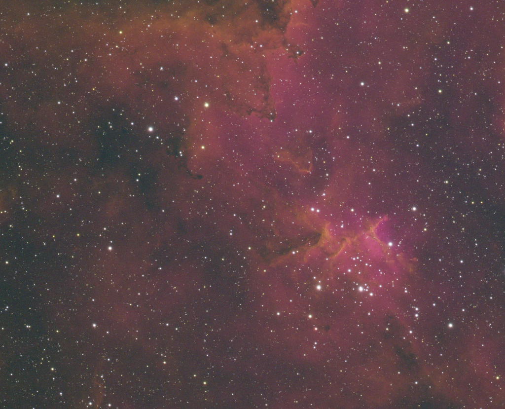

So, you sent 3 master light of which one (Ha) in already very high pixel count and the other 2 being upscaled (drizzled?) by a factor. Apart from the obvious wastage of bandwidth drizzle doesn't make sense unless you got copious signal and are actually undersampling the image and neither is the case for the SII and OIII frames. In fact for all of them. Passing on the issue of color fringing there is no immediate fix with any of the various methods in PI so in that sense it cannot be cured (this is because the image scale changes with angular distance). BXT, however, in its latest AI incarnation (4), does a decent job of tuning it down (although some hints are still there), see:  This is an auto-stretched image of a 3-color composition so no other operations were carried out. Being a NB palette color fidelity isn't an issue here but I'd imagine it would be for RGB stars. While not perfect is still a workable result.

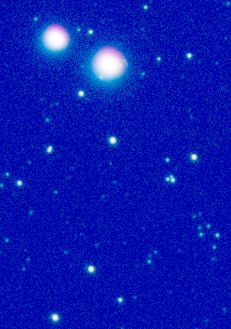

I always find that bin2 stars are blocky though  |
I can't see any blockiness here (this is in bin2), do you?  |
