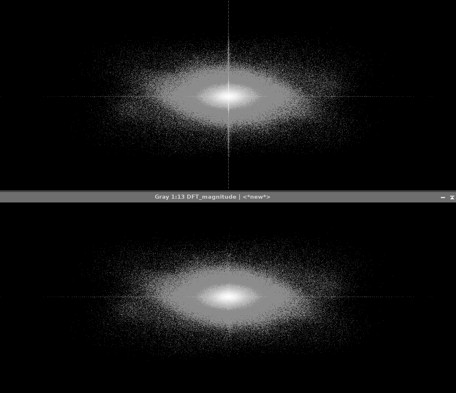

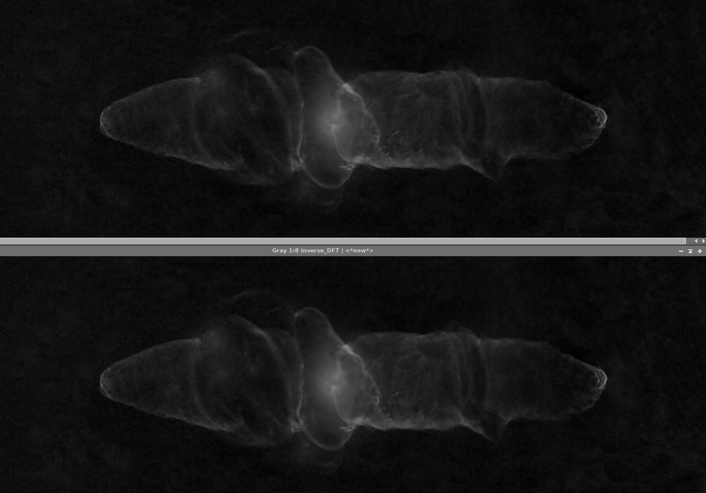

On the top image, the horizontal banding is clearly visible, on the bottom one, after DFT, masking and Inverse DFT it is completely gone.
On top the power spectrum form the banded image, bottom the power spectrum after being edited with the clone stamp to remove the central vertical line, which is where the horizontal banding noise is located in the FxFy domain.  This second image is also the power spectrum of the debanded image, and the one used in the inverse Fourier transform.

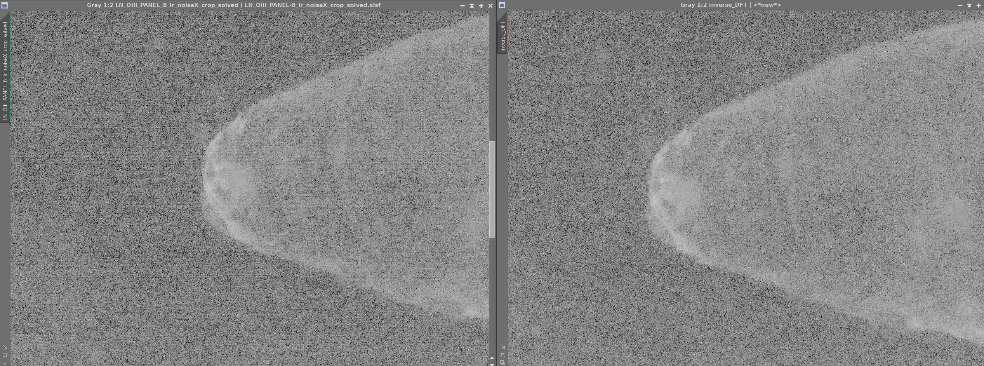

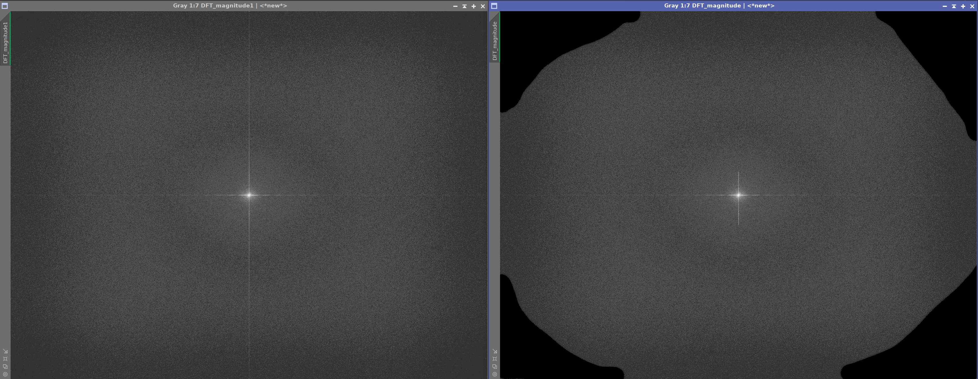

Here is another example of debanding on a marginally exposed, highly banded image (left) and spectral debanding right..lowsig3.jpg
On that example I blackened the corner with Rogelio's paintbrush (for spectral denoise purposes), and removed the central vertical line for debanding, using the clone stamp. Note that I stayed away from the center of the image, to avoid creating Gibbs artefacts at the top and bottom of the image.

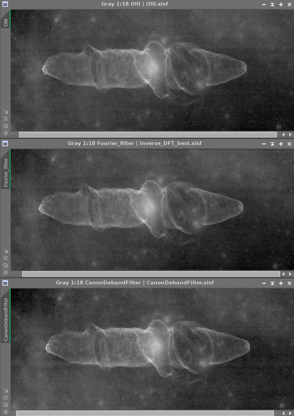

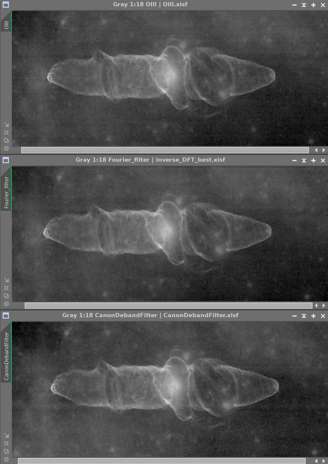

spacetimepictures 4.82
Wow that is clever and technical! Great job and thanks for sharing.
jhayes_tucson 26.84
This is a nice application of Fourier filtering.  It is exactly what was used in the early moon missions for removing artifacts from the scanning cameras used in early lunar satellites.  Have you compared your results with the CanonBandingReduction tool?
OklahomAstro 5.08
The true and new method of defeating banding is- Buying a new camerasmile

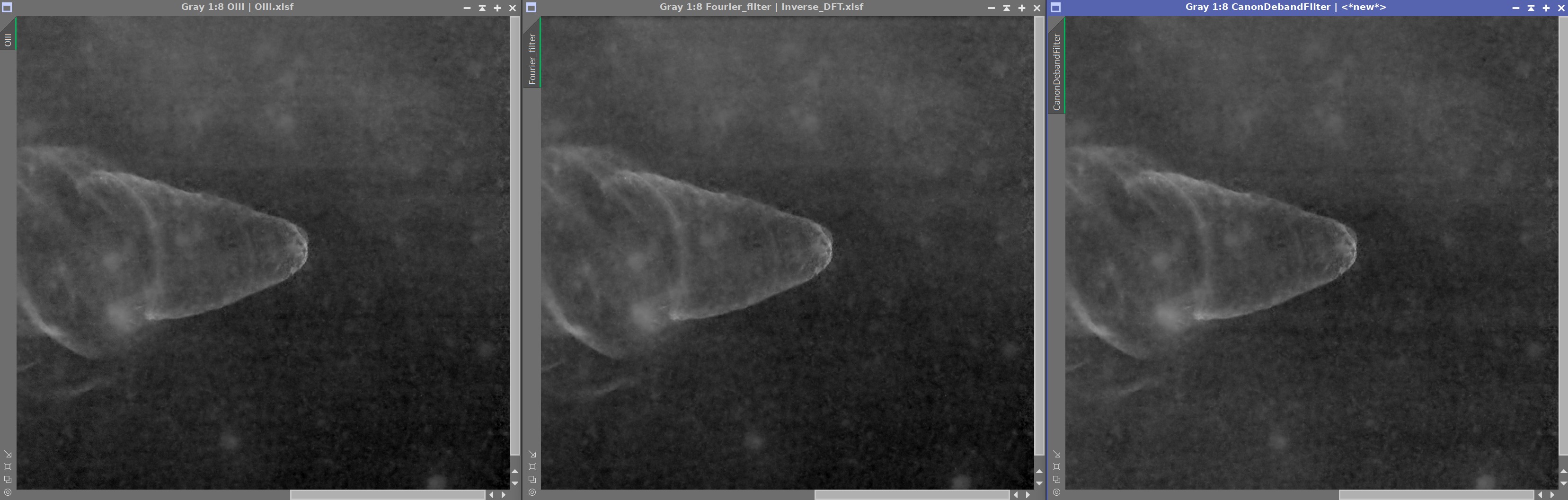

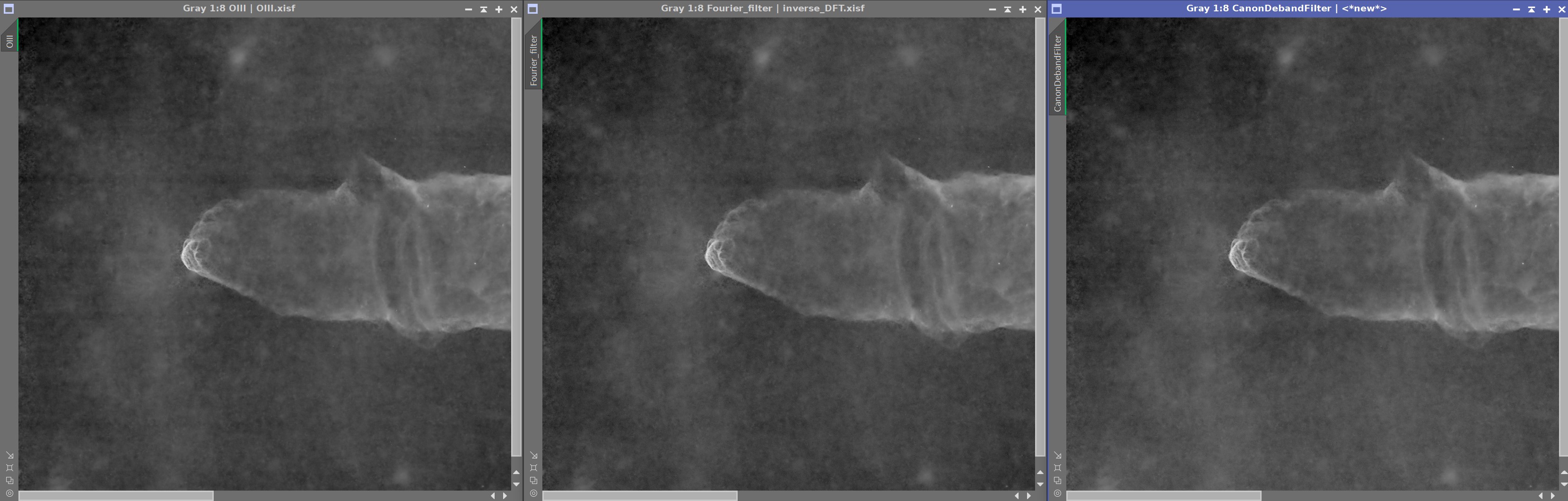

blackrig 6.20
Original, FK filter debanding, Canon Debanding script with highlight protection. Clearly the statistical method (Canon debanding) has difficulty switching from the target to the background but otherwise does a pretty good job.
blackrig 6.20
Unfortunately, this is a problem with the last iteration of sensors, maybe even more so than with the previous generation. The images above are from an IMX461.
blackrig 6.20
Here it is again on the full target, in order: original, Fourier filter, canon debanding script best effort.

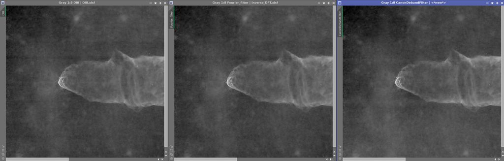

blackrig 6.20
Here she is, after being rescued by the Fourier FIltering in both Ha and OIII (was not necessary on SII). Squid.jpg
