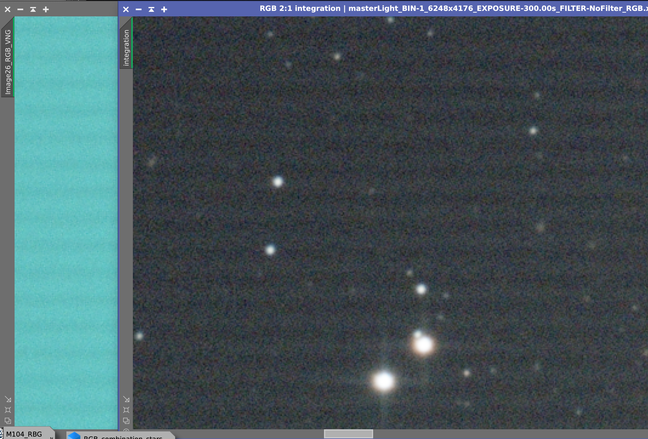

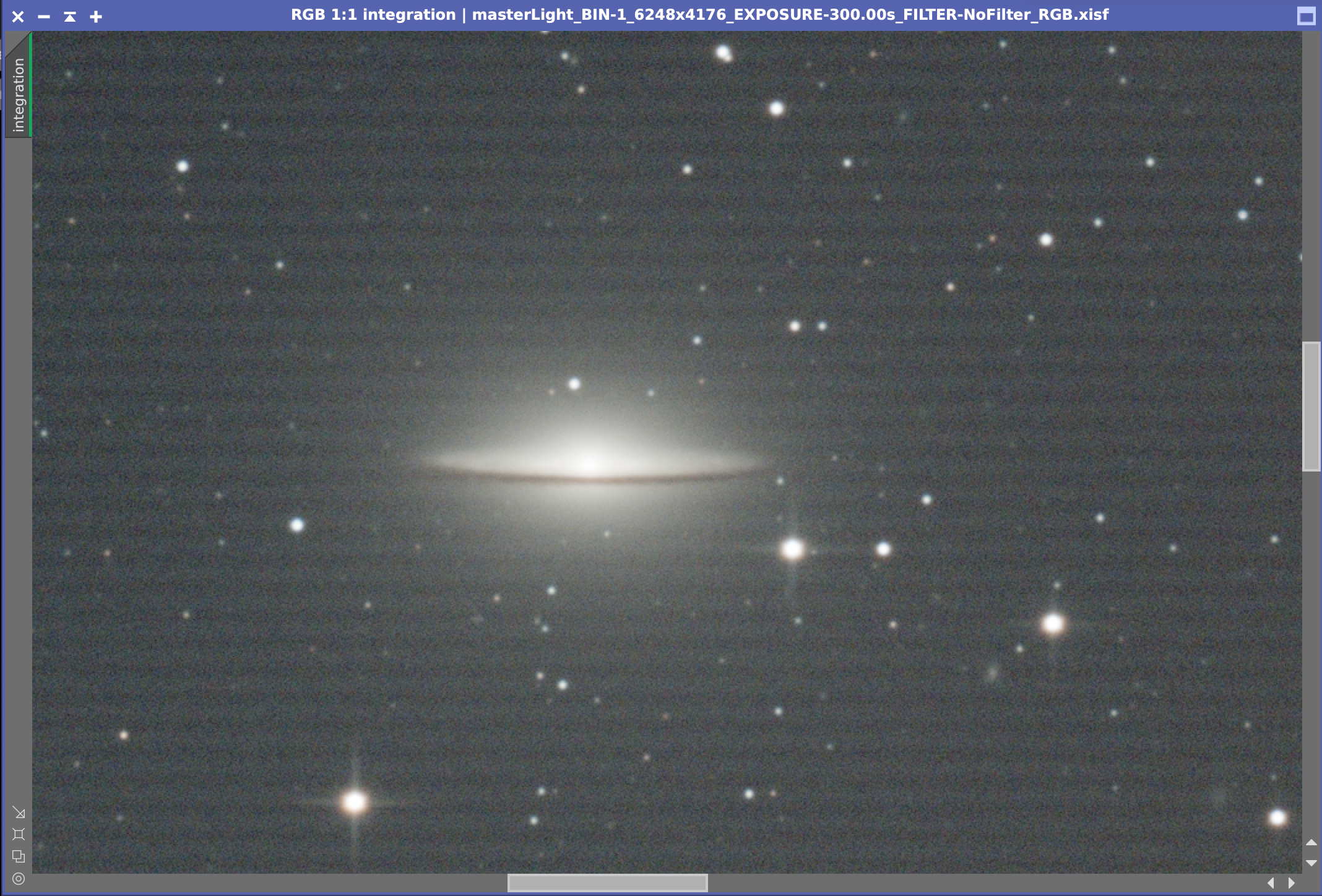

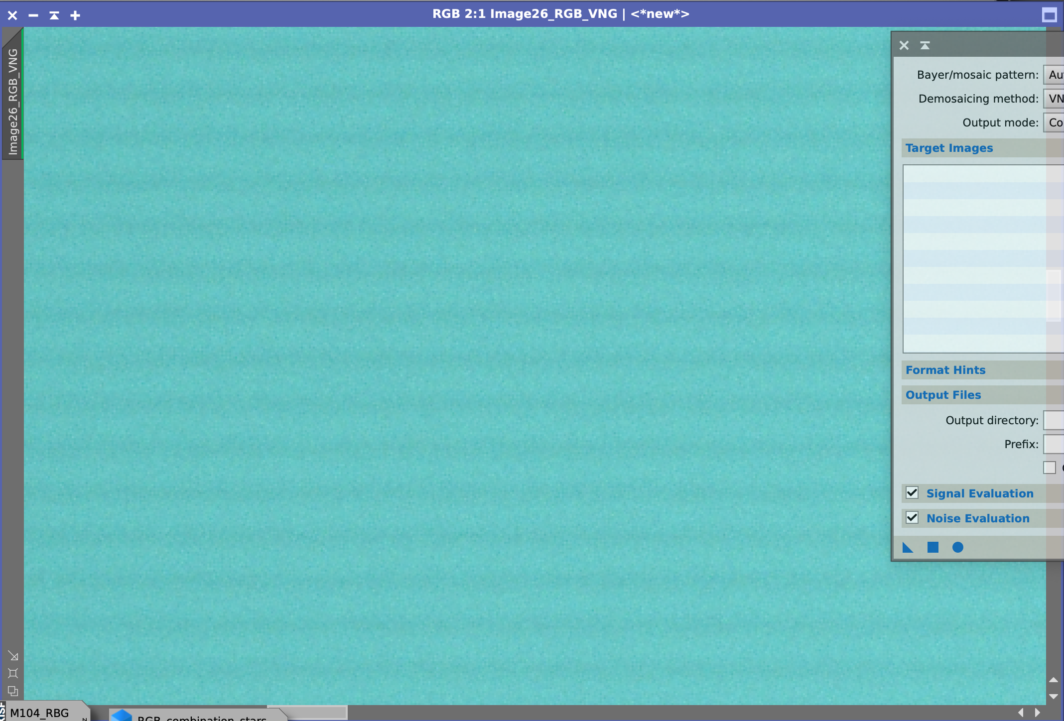

Hi all, I would like to share a very strange experience: I processed (pixinsight) two sessions of capture (newton 150F4) on M104 with flats (Lacerta flatbox withFlat wizard from NINA) per session and got a very strange linear ondulated background as seen in the attachment. To make it short I found that this background was coming from the flats as can be seen in one individual flat (debayered). Surprinsingly it is not showing the same way on the masterflat that looks normal but most probably keeps tracks on this at a decimal level. The side by side crop show clearly the same "frequency" in the master light as in the flat. I found too that if I do flats on the blue sky (not with my lacerta flatbox) I do not have this linear ondulation on the background. What is strange is that I used this lacerta flatbox a lot of times before without noticing this problem in any masterlight. When I zoomed on the masterlight this time it was obvious that something got wrong. It looks as an interference pattern maybe generated by the combination of the flatbox, the L-pro filter in front of the baader MPCC and the baader matrix on the camera. As you can see, the pattern is aligned with the largest dimension of the sensor and doesn't rotate if I rotate the flatbox. Has anybody ever had the same experience? any idea? To solve my problem I switched on doing flats on the blue sky just after sunset but I most probably have some light leak problem now. CS Frédéric    |
I had the same issue with a flatbox that I used - it was caused by the flickering of the LEDs due to PWM used to "dim" the flatbox. The flatbox was very bright and lowering the brightness introduced the issue. A solution would be to place something extra between the flatbox and your telescope so that you can use longer exposures to overcome the flickering.
I eventually ended up using sky flats with my mono camera and these have been working just fine so far.
What is your exposure time for your flats? If it’s too short, then you might see patterns from LED flicker, as noted by Kristof above. I usually try for 1 sec. exposure on my flats because of this issue. You just have to make sure you adjust the brightness of your light source accordingly.
Hi Frederic I discovered my LEDS on a homemade flat panel was very prone to interference from several origins. Even when I was earing my old radio at the observatory the panel could make "radial" interference. That ended when I switched back to 12V car incandescent bulbs (oldies), keeping only 1/3 of these LEDS, and from that point I was able to do my flats without problems.

Thank you for your advices, yes I have extremely short flat exposure. I'll try to extend.
I'll try to build a Faraday cage around the flat box with aluminium paper as I understand that it might interfere electrically and not optically with the sensor of the camera.

I had exactly the same problem with a cheap PWM dimmer I used for dew bands before and others have already pointed out the problem. You can buy a flickerless dimmer from Lacerta: https://teleskop-austria.at/PowerSplitLUX#m - unfortunately they only sell the big version now. I have a previous old version with only 2 channels which was much cheaper. I can confirm this really works as advertised. Maybe there are other products out there as well.
Set the exposure time to 3 to 5 seconds.
Hi Vahur, thank you for the reference, I ordered it.
