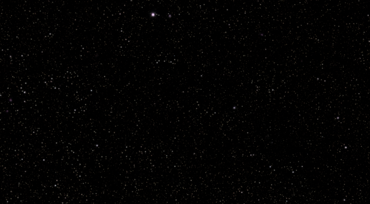

I'm new to the hobby of astrophotography. I've run into a problem and can't seem to find a solution.

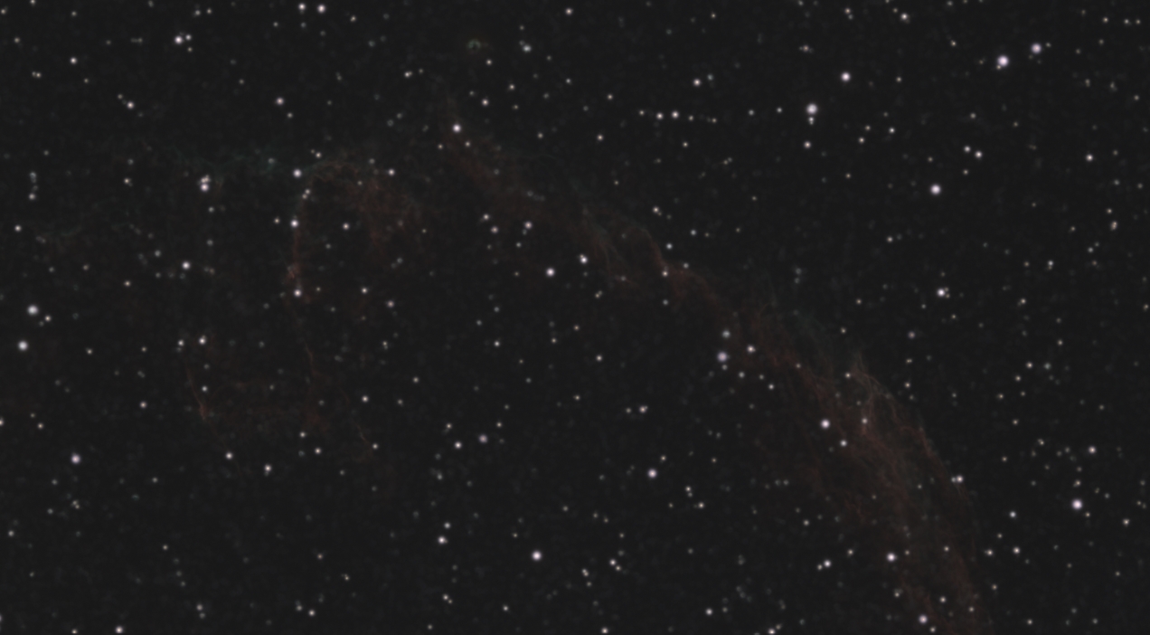

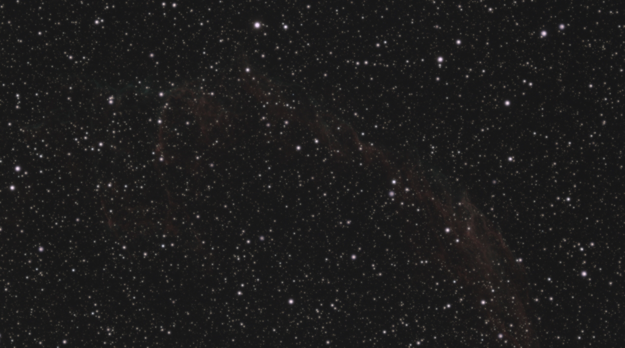

I am using Siril and StarNet from inside Siril to separate stars. After the process is completed on the starless version, there are still stars. I've tried various stretching intensities, but the stars always remain.
This is an image before using StarNet:
This are the images of starless version and a starmask that are generated:
Related to the photography process itself, exposures of 180 seconds and 100 frames were used. I think that the stars in the photo are overexposed and that the focus is not good, but I don't have enough experience to be sure since this is my first photo.

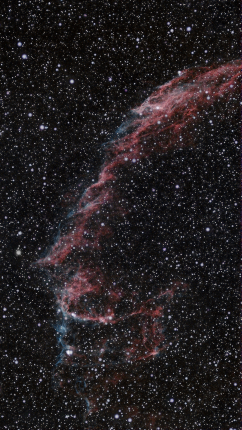

With the data i managed to get this final result:
Thank you for all the advice in advance!
Kind Regards!
Make sure that you are running starnet before you do any stretching and make sure you tell starnet to pre-stretch the image during extraction. There is also a command in the stars menu that will de-saturate your stars for you. I would run that first.
NeilM 2.11
I agree 100% with Gondola.  Focus and star 'bloat' (saturation) are definitely issues with your image, but Starnet is pretty forgiving with those.  Focus issues can cause haloes with Starnet, and that doesn't appear to be a problem in your starless image.  The good news is that for your 180 second exposures your starts are perfectly round which means that you nailed the polar alignment and guiding - well done.  Focus should be a relatively easy thing to fix in the future.

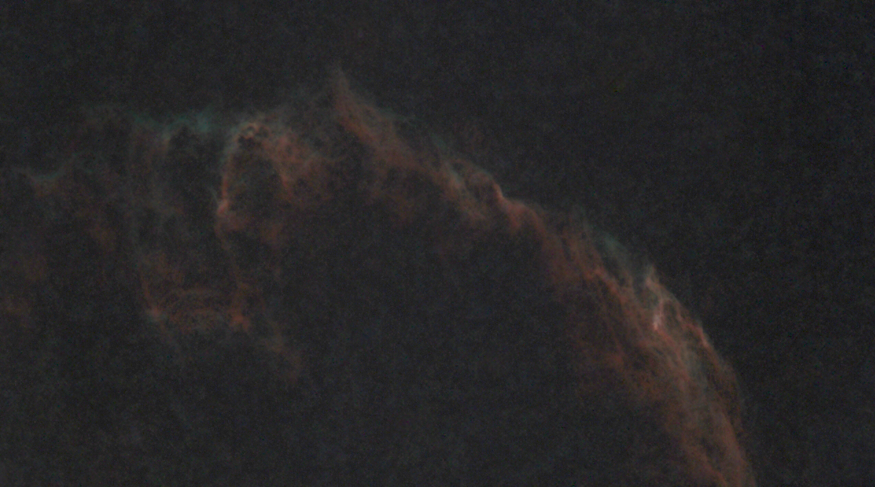

I took your low quality 400k jpeg file and did what Gondola suggested and desaturated the stars before running Starnet. The result is below.  As you can see essentially all stars have been eliminated.
There's some nice detail there..  with this data I think you should be able to create a great image.
Good luck
Neil

Thank you very much for the advice. I tried what you suggested and it worked much better.

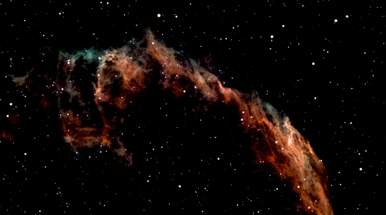

And then just for fun I spent a few minutes adjusting the curves of the starless image, removing noise and then recombining it with the slightly less saturated star mask.  This is all very poor low quality data from your original jpeg that you posted, so you should be able to achieve fantastic results with your raw data.

Nice result with that jpeg.
I guess learning curve for great processing is pretty steep. Whatever I tried I couldn't really get the result I am satisfied with and I expected more details with that much integration (telescope is 80 mm refractor at f6.4).
NeilM 2.11
I'll add that I think you do have a lot of detail in your data!  As you say, it will take a little experimentation to draw it all out.
