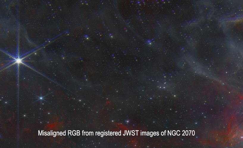

I'm working on the NGC 2070 image from JWST. No problem with the download. However, I can't seem to get the different filter images to align in Pixinsight. This is evident when I look at the combined image (090B, 200G, and 470R). When I look at a bright star on the left side of my image (see below), it is obvious that the blue channel is not aligned with the other two. The problem is not consistent over the entire image. The center, for example, is fine. The upper right is misaligned, but the lower right seems OK. Things I've tried.
1.  The images are different in size.  Resampled to approximately the same size.  No improvement
2.  Tried using a different filter to align to (e.g., rather than 090, used 200).  No improvement
3.  Tried thin spline.  No improvement
Suggestions?
Thanks in advance,  George

Try 4th order splines or even 5th or 6th.
ghatfield 1.51
Thanks, Andrea.   I tried 6th order, no help.  I think I need a distortion model which is way above my "paygrade."

WhooptieDo 10.40
It looks to me the problem isn't in your alignment.  It's working fine.   The problem was in the original stack.    The 470 data already has quite a few double stars on the top left of the frame, registration didn't work.   It needs to be restacked.
WhooptieDo 10.40
Hell, they all have registration and rejection issues.

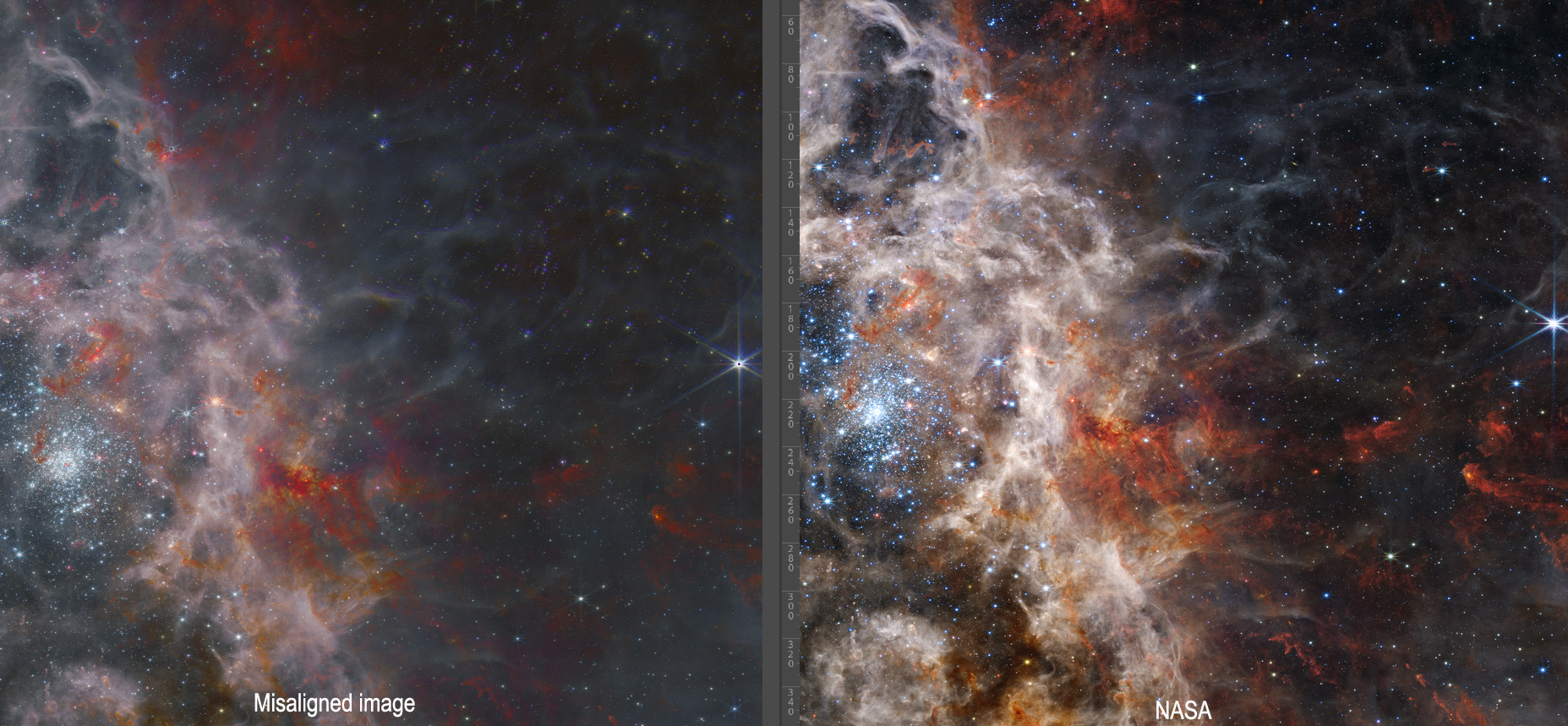

Yes, these masters do have issues.  I'm not sure they are stacking issues since I read somewhere that these images are not the usual stacked masters in the earthly sense.  However, they are often mosaics of smaller images, which can lead to defects.  However, the NASA-processed image shows that a decent result is possible.  See below for my partially processed image vs the published NASA image.   Given the color similarities, I suspect the same masters were used.  But who knows?  Maybe they had access to the pre-mosaic images.  Also, NASA undoubtedly has access to processing techniques we can only dream of.  I think I will give up on this one and move on.
