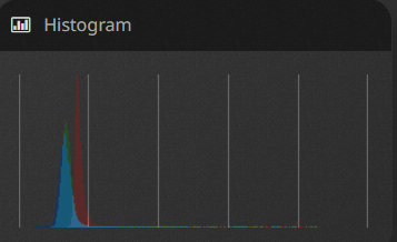

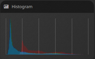

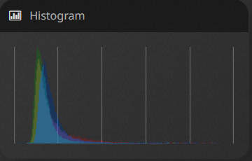

Is there an ideal histogram, or do the colors necessarily need to line up?
morefield 12.31
The "toe" or the left side should match for the three channels.  Otherwise you've got a background tint.  But if the entire background is Ha even the left will be off a bit.  If I saw something as far off as the first one I'd certainly play with it and see if better white balance improved things.  But I wouldn't expect every histogram to line up exactly.
