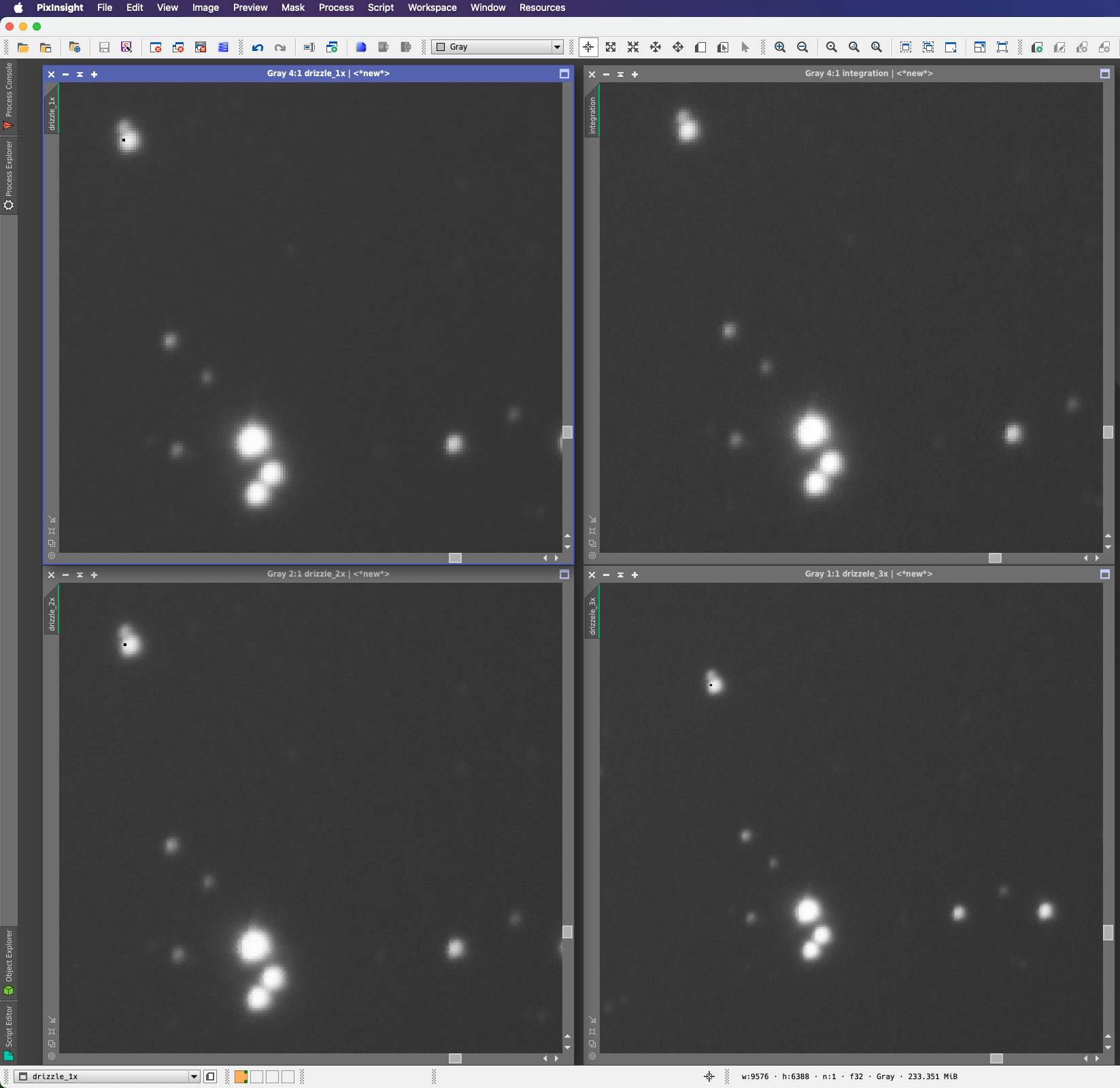

I was reading this thread while actually running a test on my OSC (ASI6200MC) with a RASA 11.  Drizzle certainly introduced some artifacts, but it did reduce pixelation in the stars.  I ran a test with 1x, 2x, and 3x drizzle.  This is 6x 10min subs integrated, but no bias, darks, or flats applied.
I fail to see how noise in those pictures is any different between each other. Besides it's the SNR that really counts and it really counts in the shadows.
