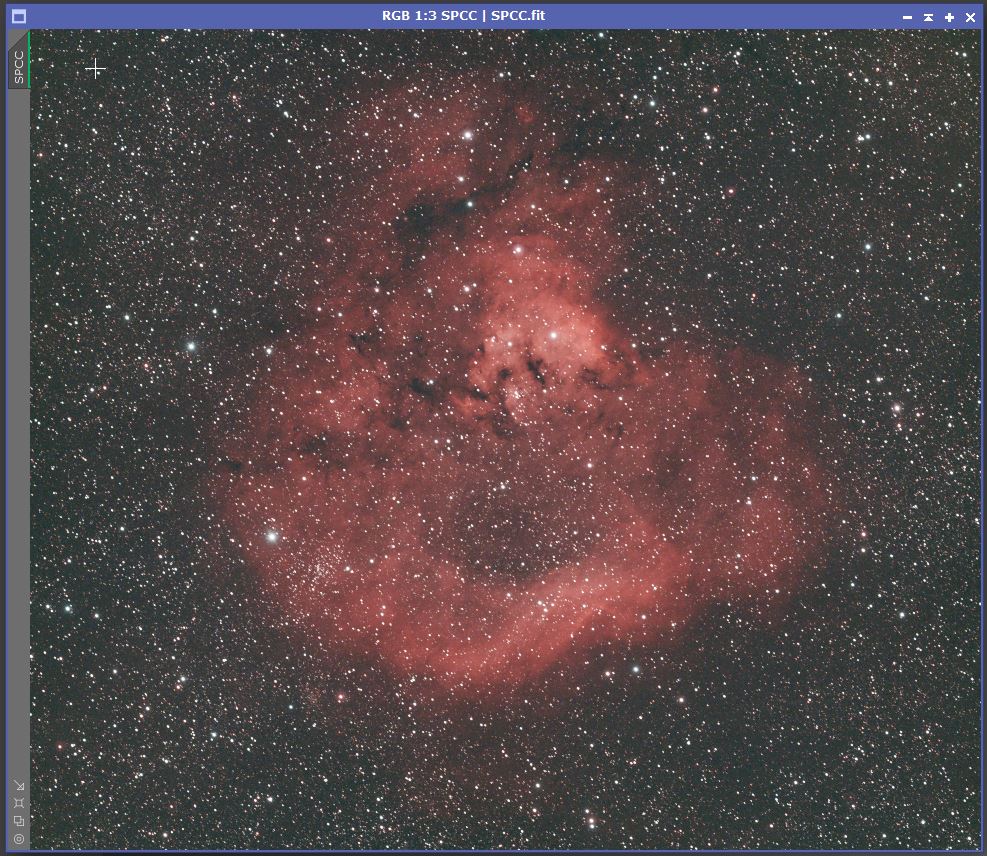

Used DBE too, forgot to mention that. How many samplers are you placing when trying with DBE? It looks like there may be too many in your example here, because we see this kind of darkened ring around the nebula which can happen with too many samplers - or poorly placed ones. ABE often does that mistake with images that contain a lot of stuff, like most nebulae that more or less fill the image (it works well for simple images, like a galaxy in the center of the image with nothing of interest around it). I used only 6 samplers for the background in mine, roughly in each corner and then a couple others where they seemed to fit nicely. Well away from the nebula in the center - no need or want to put samplers close to it. For the settings, the only thing i changed was to set tolerance to 1.0 from the default 0.5 and the resulting image appears to be very flat in terms of gradient.

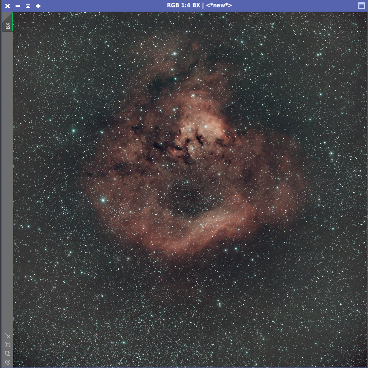

This is what the image looked like during my process after applying DBE and SPCC, with the auto STF:
This part of the process - gradient removal - is very important for preservation of shadow detail and one you should spend some time on. Usually with DBE less is more, so fewer samplers rather than many samplers. And none of them on stars or nebulosity. In an image like this where realistically there is at least a little bit of faint nebulosity all over the place you have to choose the least worst spots, basically just the darkest areas. It helps to put the image in the extreme STF mode for this step, so you can see the background better.

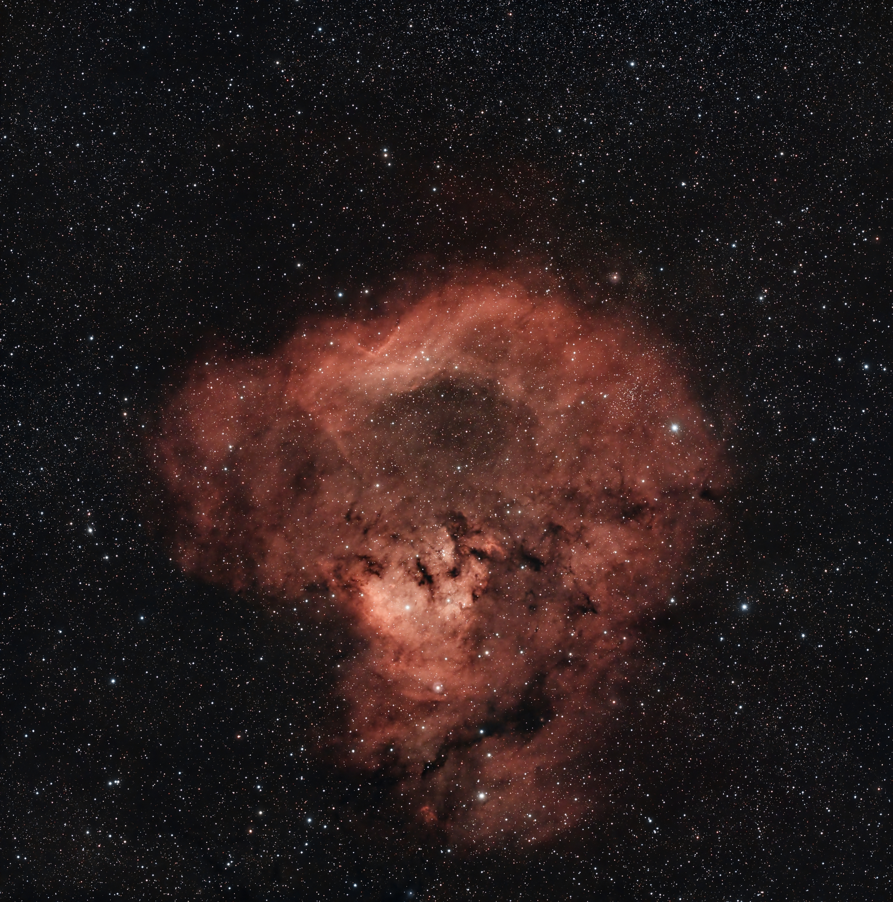

So here is my first version: https://astrob.in/1dcjx7/0/
All in PixInsight:
  • WBPP with autocrop
  • SPCC
  • DBE
  • NoiseXTerminator
  • BlurXTerminator
  • Some stretching and curves
  • StarReduction Script (Bill Blanshan)
  • NarrowBandNormalization (Bill Blanshan)
  • ScreenStars (Bill Blanshan)

Out of curiosity, do you see the nebula in, mainly, red? Because isn't what I see on the posted link (more like grey-white). And, also, BTW, you were right to put a high number of sample points but what makes the difference is where they go, in other words what parameters you used to create the samples.
EricGagne 3.82
It is actually in a greyish/blueish palette.  That is what NarrowBandNormalization does.   It started as a PixelMath thing but a few months ago he made a full script of it.  It "allows you to normalize SHO or HOO (or HOO from a OSC) data in a drag and drop process."
Narrowband Normalization | PixInsight Forum
I was tired of everything being red all the time so I decided to play with this.
Eric Gagne:
It looks pretty weird (if you don't mind me saying so), more so if you're starting in the hobby. But to each his/her/their own...

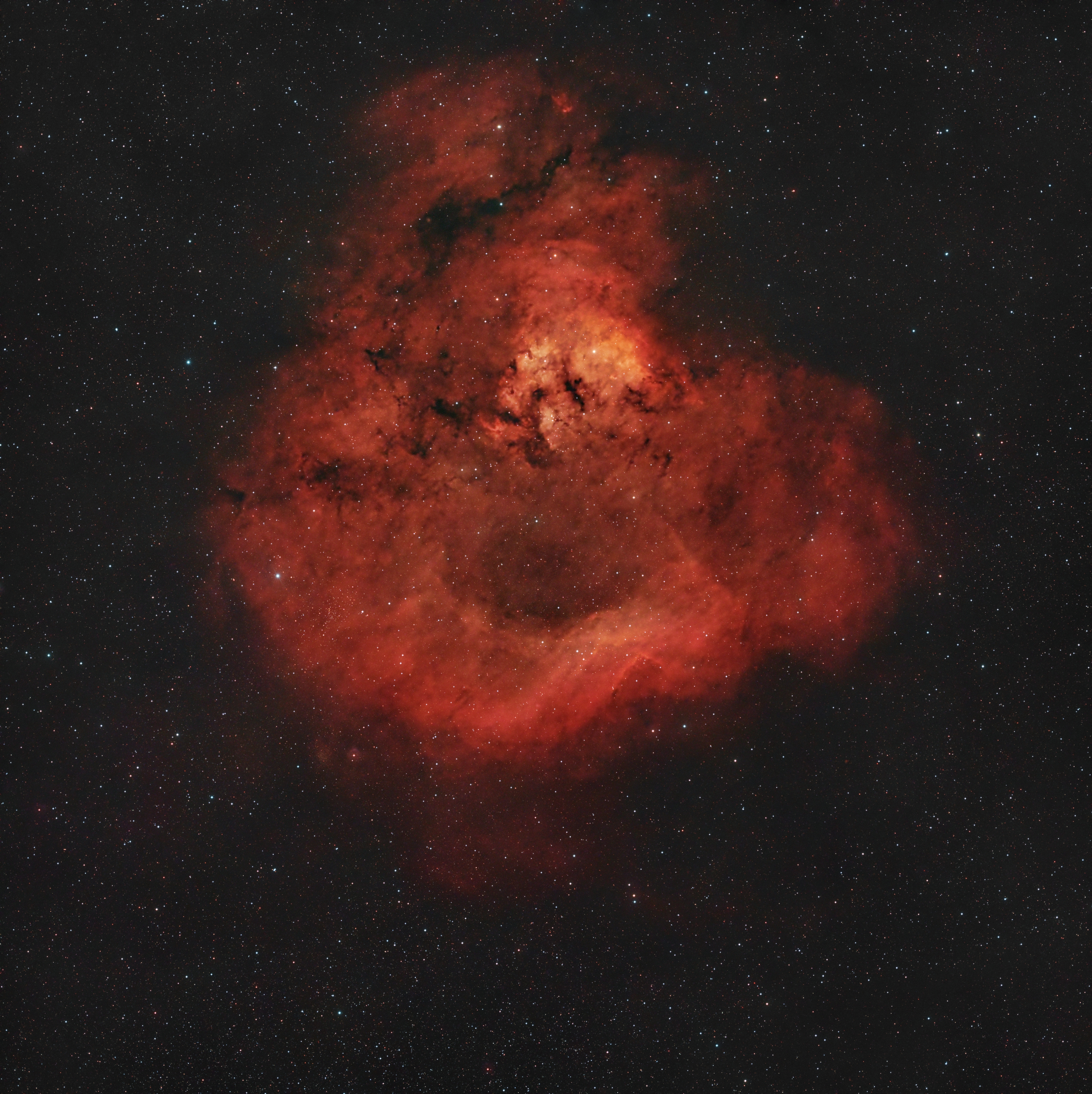

Here it goes:
Processing description to follow (it's lengthy)...
EricGagne 3.82
Nice job Andrea.  I see you too did a good job at removing moonlight
Thanks Eric.

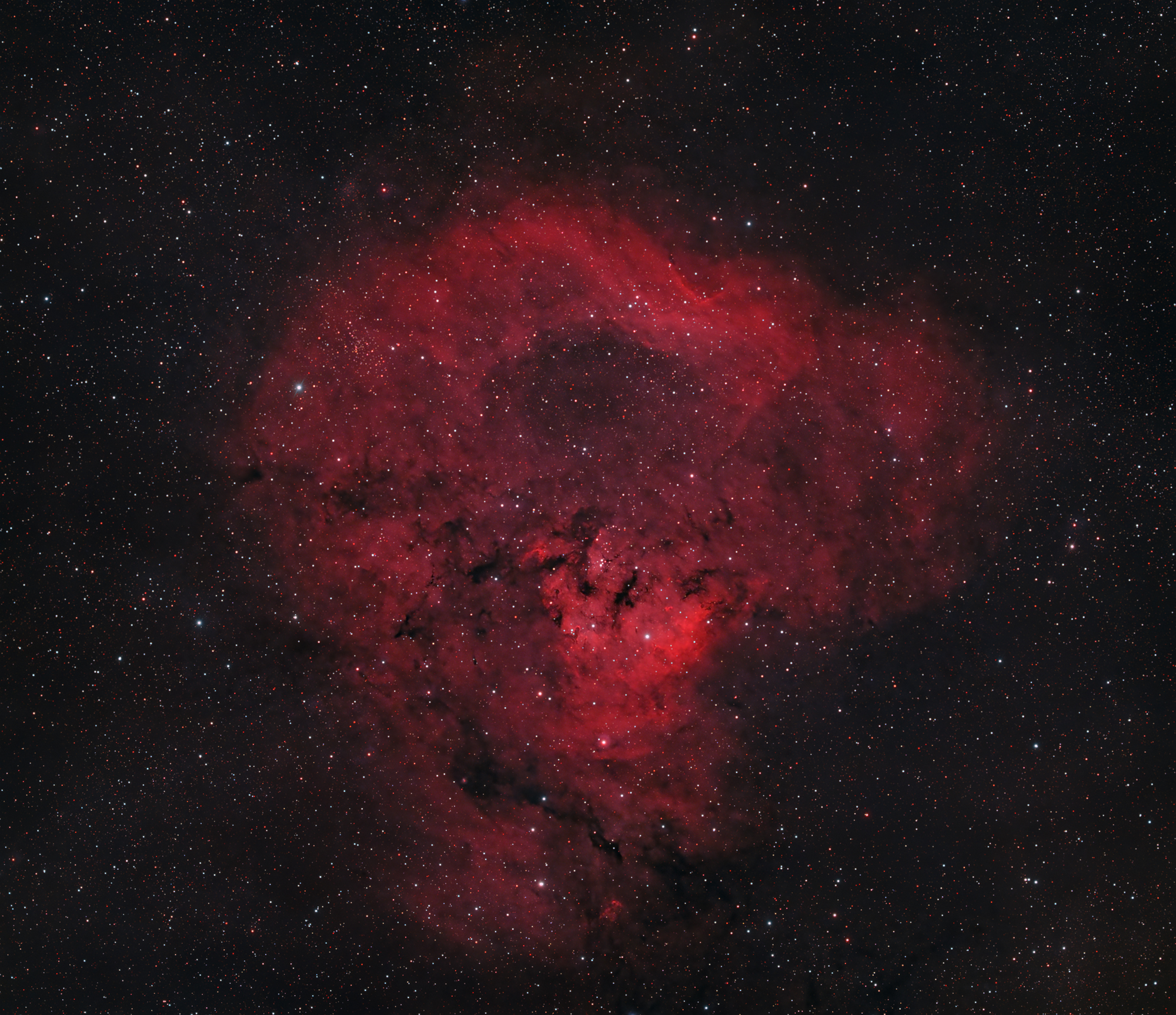

AstroDan500 7.19
I downloaded the files and stacked them in APP. All of them , I did not sort at all. I could not load the Masterdark , it was greyed out for some reason but loaded all the flats and dark flats and lights.
It was so weird colored, like it had no calibration, I tried to remove the color gradients but to no avail and I just trashed the files.
I have a 533MC, I do no calibration at all with that camera and have good results.
I have used it with the 135mm Rokinon which I also own and did not like the results with a Radian triad filter but they were not as weird as these files.
I should have kept and posted but they were green and red and orange and awful.
Thanks for sharing, maybe for whatever reason they did not stack well in APP.
The stars were sharp and all the details in the Nebula looked good.
The gradients were beyond my Processing skills to fix.

Here it goes:
*Description of Pre-Processing Steps*
1. ImageCalibration (with supplied Master Dark and generated Master Flat)
2. CosmeticCorrection (using supplied Master Dark with sigma=3 and Auto Detect on for both hot and cold pixels)
3. DeBayer
4. SubFrameSelector to reject low quality weight and low star count frame (threshold at 60 for quality weight and 2000 for stars) resulting retaining 156 frames
5. StarAlignment (with drizzle files generation on)
6. LocalNormalization (using frame 45)
7. ImageIntegration (with Local Normalization on both stacking and pixel rejection and weights from step 4 above)
8. DrizzleIntegration with 1x CFA drizzle and Local Normalization
*Description of Processing Steps*
1. Removal of linear gradient (Moon glow) by ABE with linear option (degree of interpolating function = 1 and correction by subtraction)
2. Image flattening with DBE, 55 samples per row, sample weight at 0.6 (in hindsight I should probably done it twice)
3. ImageSolver script
4. Color calibration with CC (did not use SPCC because with undersampled stars and NB filter yields red-skewed results)
5. Star removal with SXT
----------------- end of linear stage --------------------
6. Stretching with MaskedStretch
7. Further stretching with ArcsinhStretch
8. Trimming image range with HistogramTransformation
9. Denoising with NXT (50/20) on whole image
10. CurveTransformation to further reduce background but slight increase of the middle tones (RGB/K curve)
11. Mask creation to include all of nebula
12. Applied mask to deselect background
13. Applied B/G enhancement curve (CurveTransformation process) to highlight the OIII regions at the core of the nebula, twice
14. Further lowering of background with inverted mask and CurveTransformation followed by removal of mask and running BXT again (same parameters as before)
15. Stretching of stars image with HistogramTransformation followed by ArcsinhStretch (84)

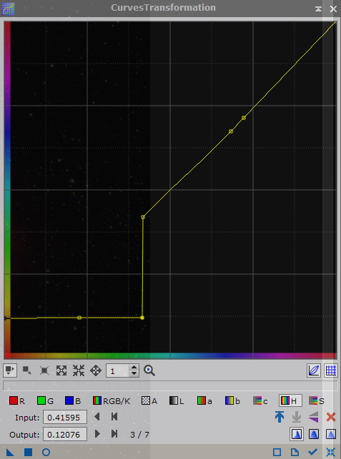

16. Star color correction by hue transformation (CurveTransformation process):
17. Blend stars with nebula image (PixelMath)

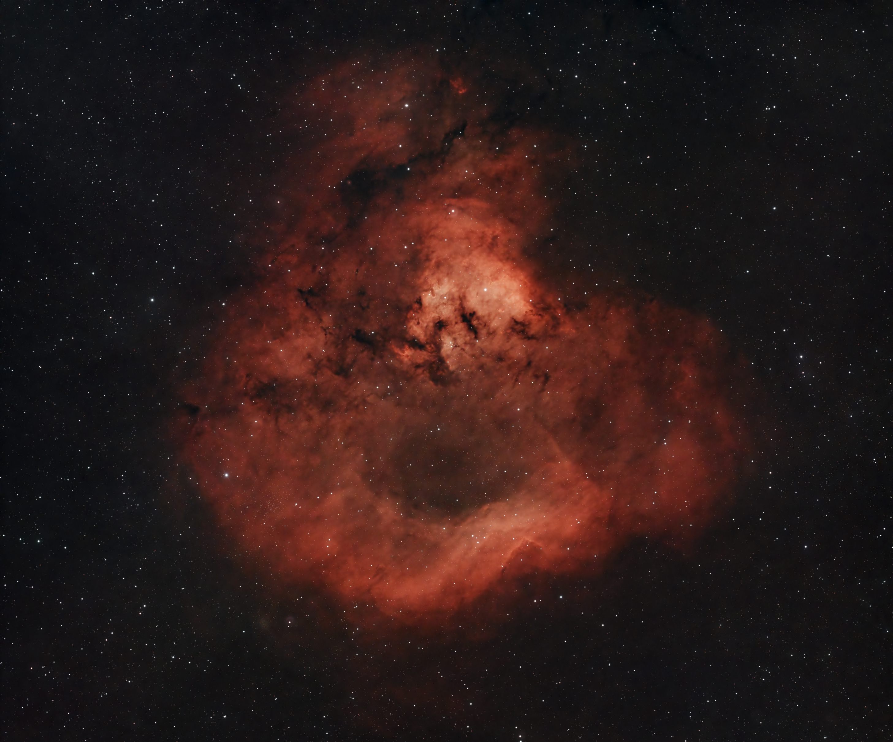

@Eric Gagne thank you for the data. This is my attempt on processing it.
So, as other stated, drizzle is the key for removing that hot pixels easily. Even so, Cosmetic Correction did help me to remove them in WBPP.
About the work flow, it is the one I use for my images. It consists on:
- Background extraction. I use DBE, ABE or GraXpert. Last one in this case.
- SPCC.
- BEX.
- NEX.
- SCNR.
- GHS.
- Remove stars.
- Range mask for the nebula.
- LHE on the nebula.
- Invert the mask so I can adjust the background brightness.
- Rescreen stars.
I did remove about 30 frames due to eccentricity or clouds.
I enjoyed processing it so, if it is OK to you, I would like to upload it to my gallery, referencing your gallery.
P.D. I see my version is rotated 180º compared to yours. It was not my intention. That was the original rotation after WBPP with plate solving.
CS,
Guiem.
