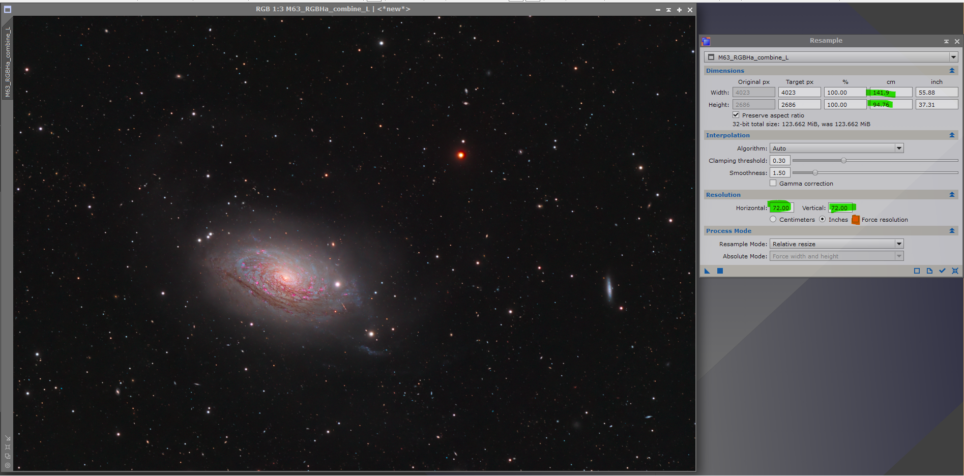

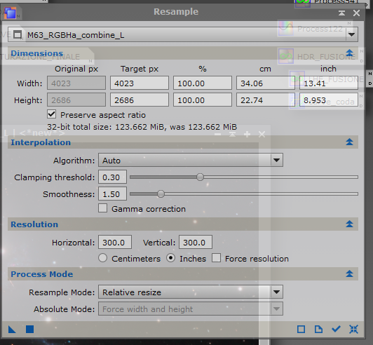

so, in a few word:
I have my image on the left measuring 4023 pixels x 2686 pixels.
With the current default resolution (72 DPI), it would be a photocanvas of approximately 142 cm x 95 cm, but I want to print it with a resolution of 300 DPI and a size of 45 x 30 cm.
so is it correct to change the 2 resolution boxes and the 2 size boxes marked in green?
should I change anything else?
Can you tell me what the box highlighted in orange is for? I don't understand the pop up
thanks
Riccardo

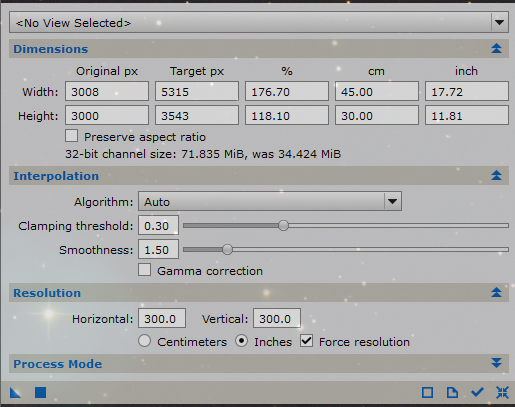

No, you got to change the target pixel resolution to match the 45x30cm print @ 300 dpi. See example below:
AstroReghe 1.20
ok but is the same thing because all are linked
thank you Andrea smile
