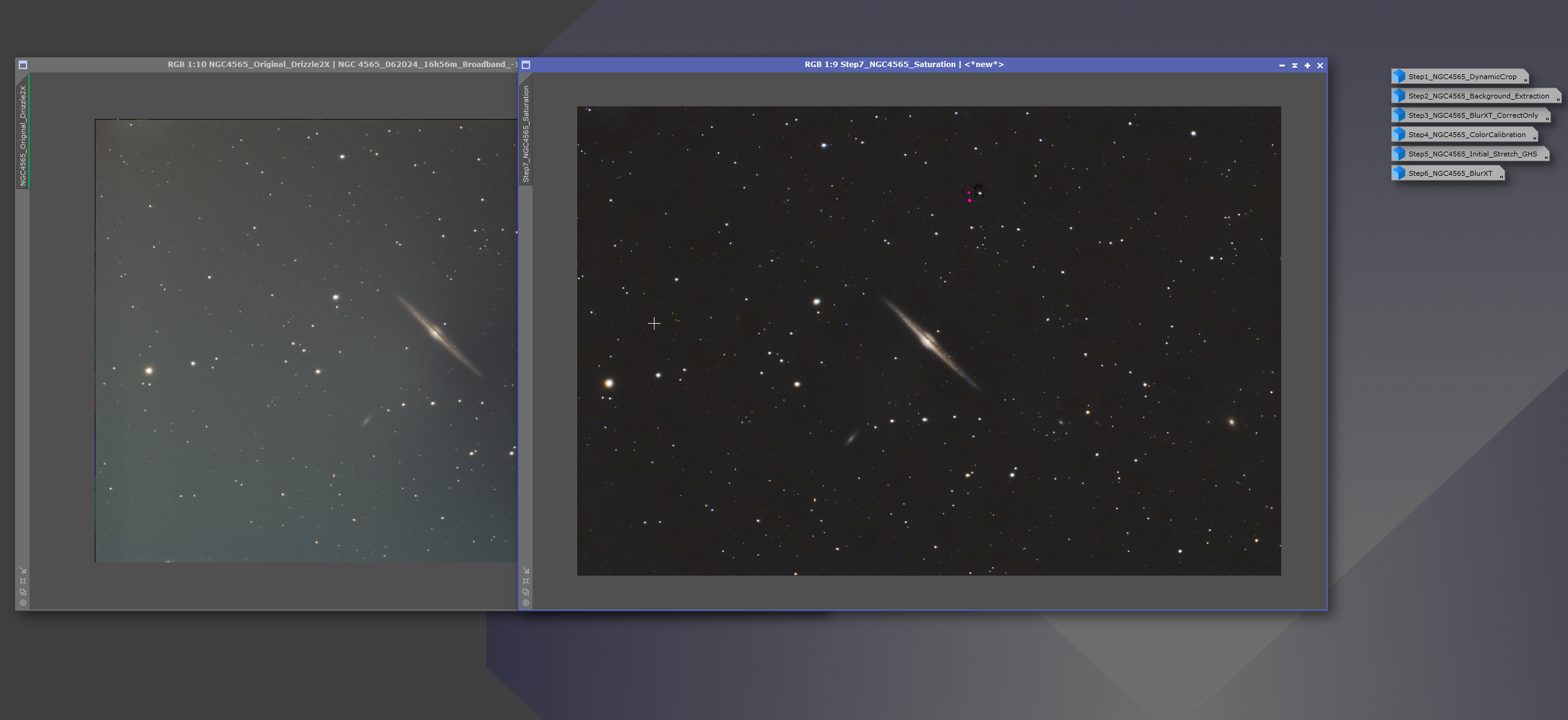

I used 2X drizzle when stacking in Deep Sky Stacker to improve the final resolution a tad, this caused some confusion in PixInsight as I had to remember to halve my pixel resolution in the Image Solver wizard or else it would not plate solve correctly.
Here is a screenshot of my processing workflow:
