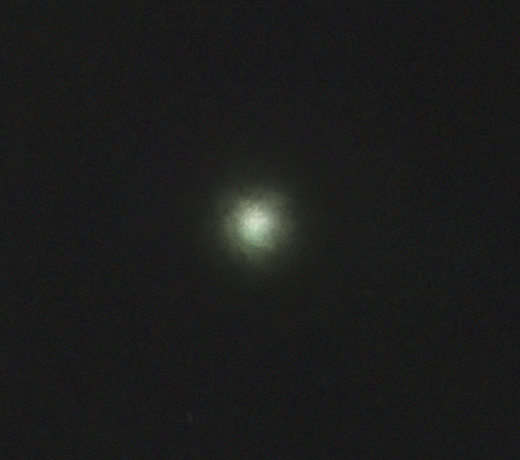

Here is the OSC data https://filebin.net/ip21jp9nbja4v91b
It's full spectrum (no UV-IR cut), so UV/IR is overpowering the image (so star colors are lacking), and it was taken with no coma corrector, on a Newt, and there is no calibration frames, and it's a stack of 90x10 second subs (15 minutes integration).
Since now that I have a UV-IR cut (and a coma corrector), this M3 file is useless for me.
Will be gone from FileBin automatically in 6 days.
And M3 is not really a favorite target for me, so I don't mind anyone making a better image than my own.
I wanna see what others can do, especially Pixinsight and BXT users.
This is my version: https://www.astrobin.com/0qa87m/B/?nc=collection&nce=32422 Just Siril, Astrosharp, and some Photoshop.

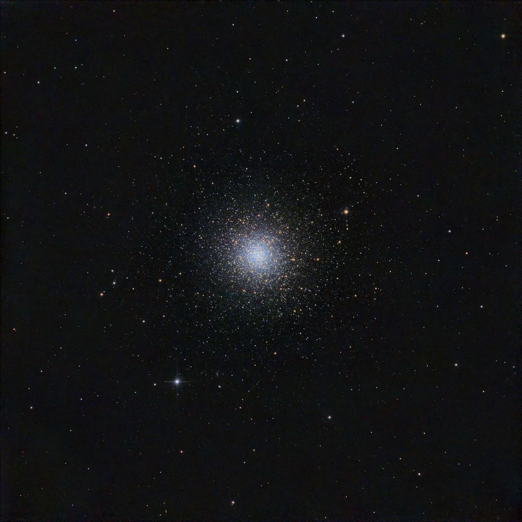

Here is what I came up with:
I brought the tif file into APP then used that to neutralize the background, then used the light pollution removal tool to even things out which took me a few iterations, then I used the star color calibration tool, then I cropped it a little. After that I pulled it into PI so I could perform deconvolution and get those star shapes better. I then took it into Photoshop and finished things up with some selective sharpening, the camera raw filter, the hue and saturation adjustments, and photo filter adjustments using selections of shadows and highlights to mess with colors there, plus some curves and levels at times too.

I'm the king of speed processing! Seriously, that took me only about 15 minutes tops. I think the most time I've actually spent processing something was still under an hour.

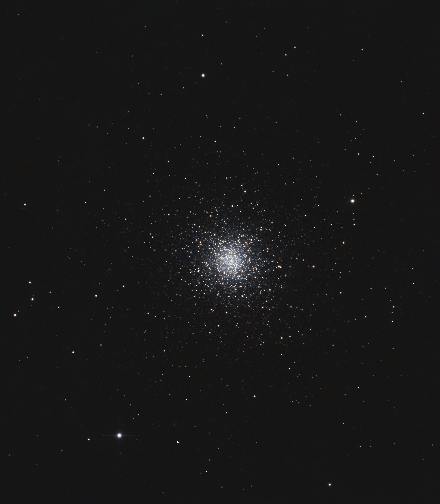

Here is my take:
https://www.astrobin.com/vdpygx/
Graxpert, SPCC, BlurX, MaskedStretch, (watered down) NoiseX, Curves for saturation and that "enhance brilliance" script which I am not so sure did much. Also, I resampled it at 75%.

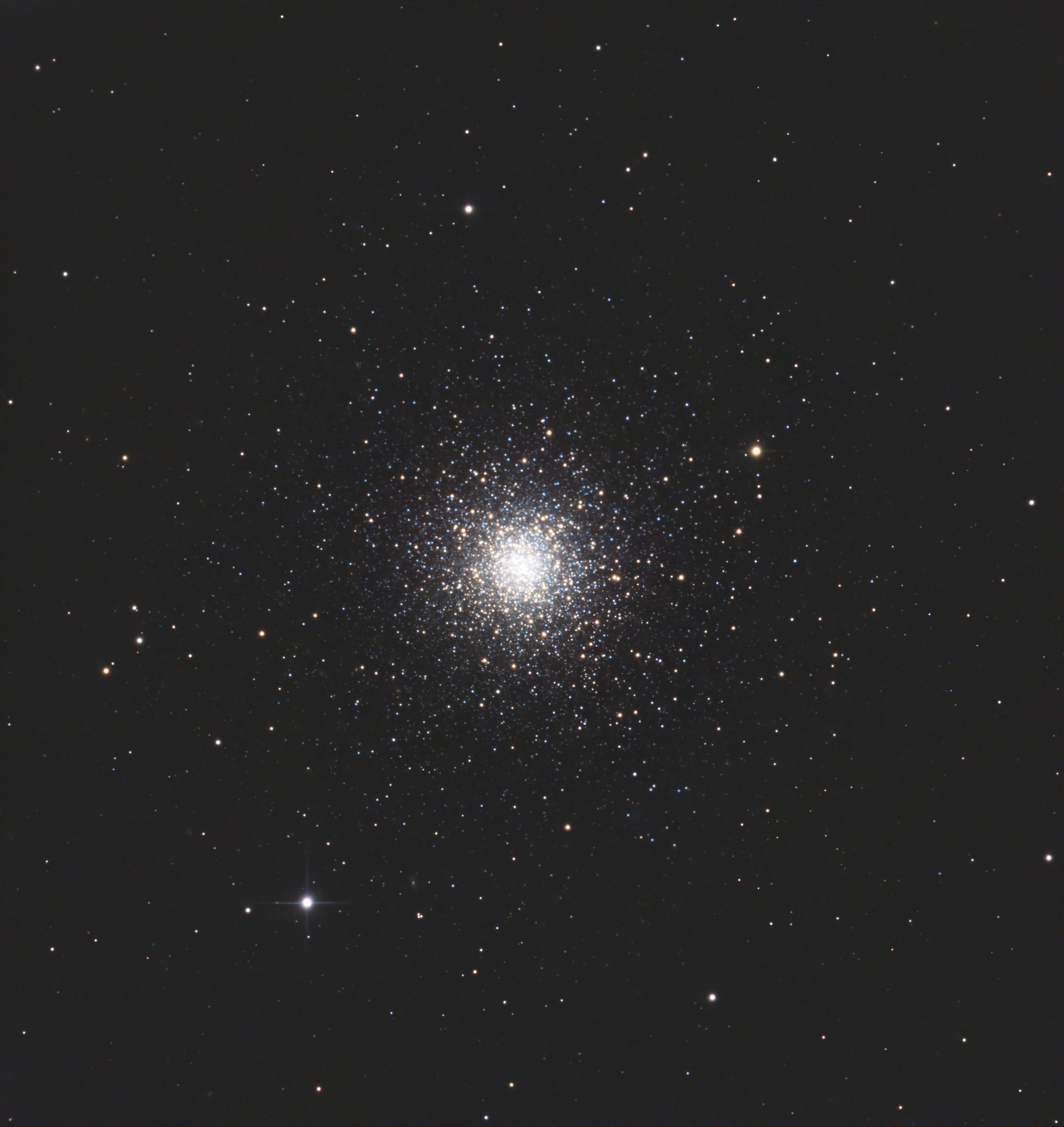

Hi, this is my take on your M3. I used Graxpert, StarTools and Gimp. My goal was to resolve the stars in the core and preserve color.

Yours, I think, has the best color. Very nice edit!

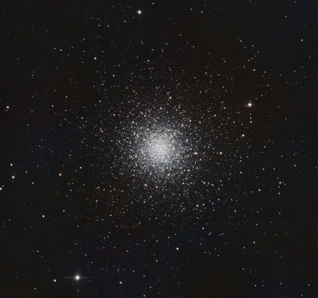

Here is my aggresive processing effort!
Everything in PI. My standard workflow. Still learning and still have long way to pefection.

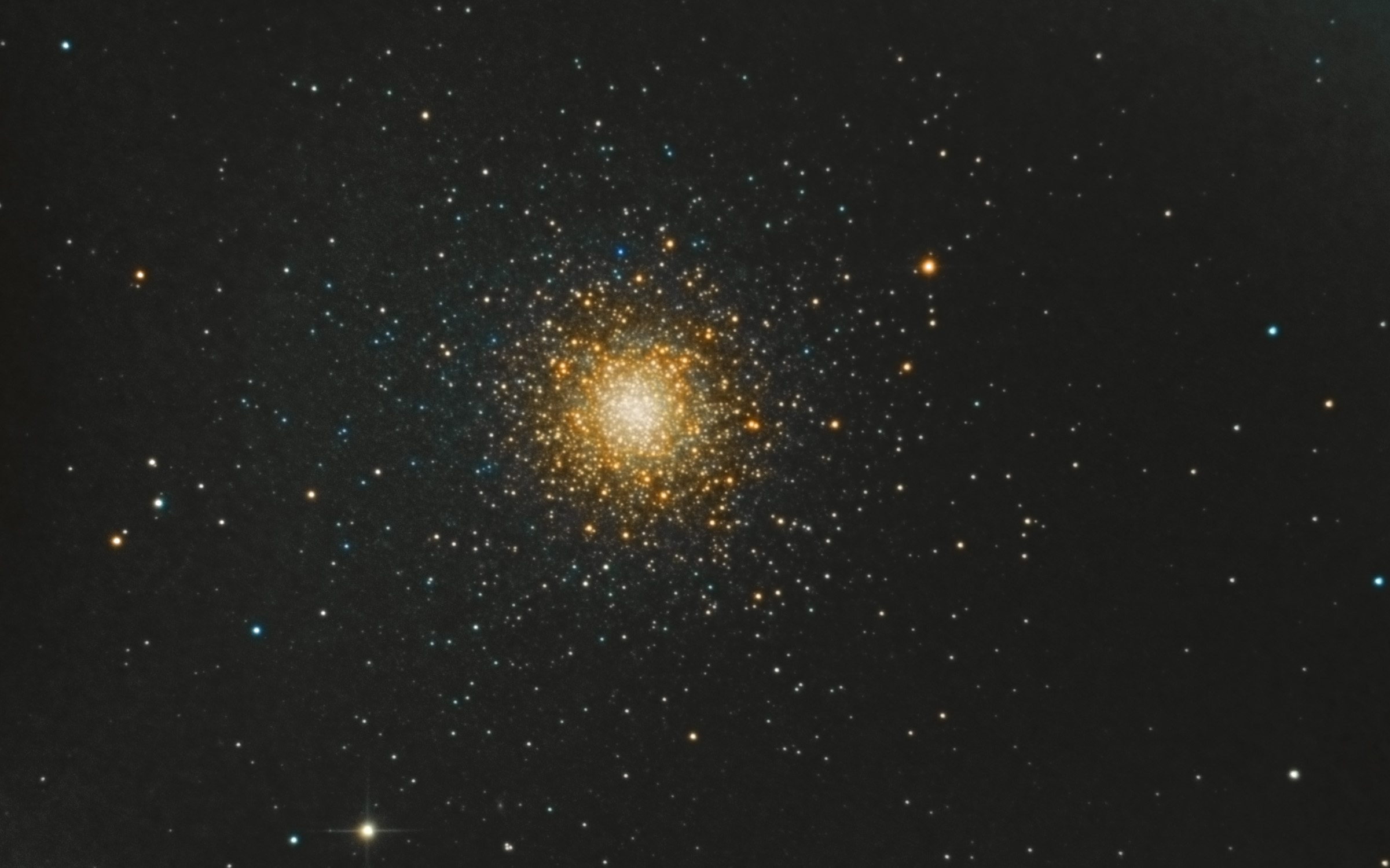

I gave it a whirl as well. There were some pretty nasty gradients and what seemed like an OAG obstruction at one side, so perhaps it could do with a bit more cropping. All in all it cleaned up somewhat well so I didn't see any need for crushing the black point any more than necessary.
Pretty simple, quick and straight forward processing:
1. Crop
2. BXT Correct only
3. GraXpert (due to the gradients)
4.GHS (Initial stretch)
5. HT stretch (four passes)
6. Nxt
7. BXT (very very small amount of star sharpening, 0.09). Opted against using this, but changed my mind after stretching.
8. SXT
9. NXT (small amount on the starless image)
10. ColorSaturation on stars image
11. Screening stars back with Pixelmath.
EDIT: Added another edit where I moved the black point slightly as there are still some color noise left from the aggressive gradient removal.
