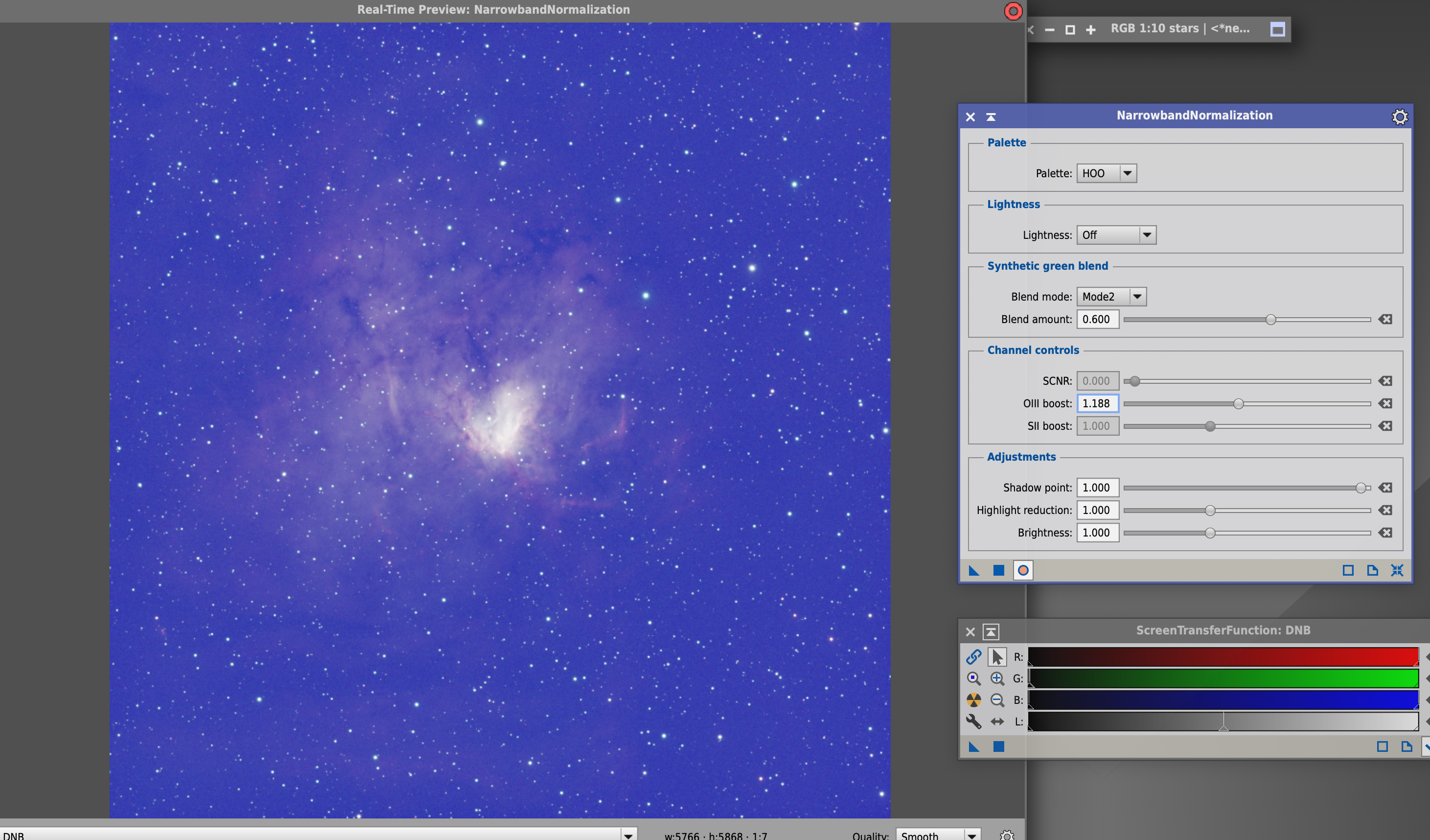

I have 24 hours of data at f5.3 on the Fossil Footprint Nebula (NGC 1491) with an ASI533MC Pro and Optolong L-enhance but I'm struggling to get any Oiii data when creating a HOO image.
Processing so far:
Gradient Correction
BlurX
SPCC (If I don't run any colour calibration, I get very funky results from narrowband normalisation)
Histogram stretch from STF (I normally use GHS but for the purposes of this issues, wen't for the quick option)
Attached is a a screenshot showing what I'm getting. The SHO option is even worse.
Other OSC  images on astrobin are showing a lot of blue Oiii signal in the core:
https://www.astrobin.com/vnvoys/
https://www.astrobin.com/7v6ko1/

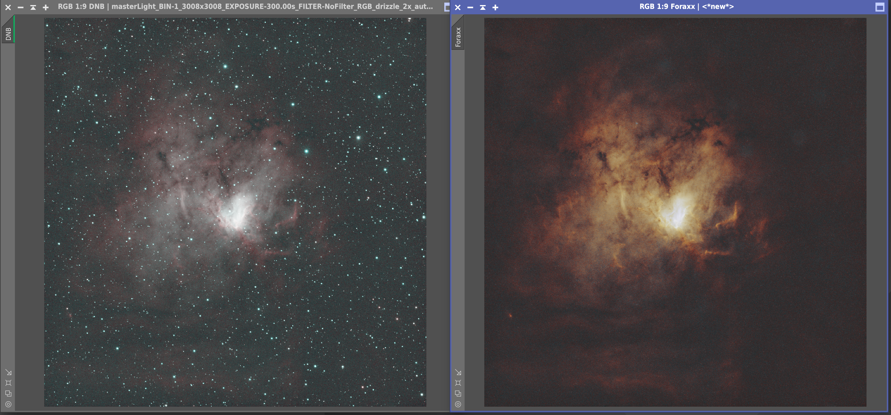

I don't normally colour calibrate narrowband or DNB images either but this is what I get in narrowband normalisation if I don't colour calibrate. Extracting Ha and Oiii manually is something I'm happy to try, just wasn't sure how. Thanks for the link, I'll read through it all now.Screenshot 2024-11-09 at 19.46.41.png

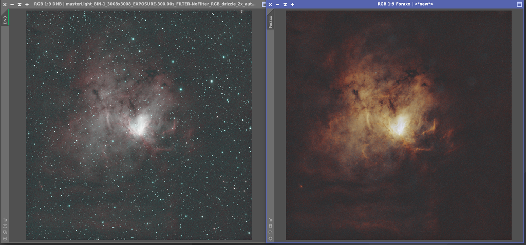

I've spent quite a bit of time trying to figure this out but this is as good as I can get. The image on the left is the result of the narrowband normalisation tool in PI and the image on the right is a Foray palette creating manually by following a Paulyman Astro tutorial. I've also tried extracting the Ha and Oiii manually and then combining but I get very similar results to the narrowband normalisation process. I think I have to conclude that getting a strong Oiii signal is beyond the limits of the relatively wide l-enhance filter that I used.Screenshot 2024-11-23 at 09.57.47.png

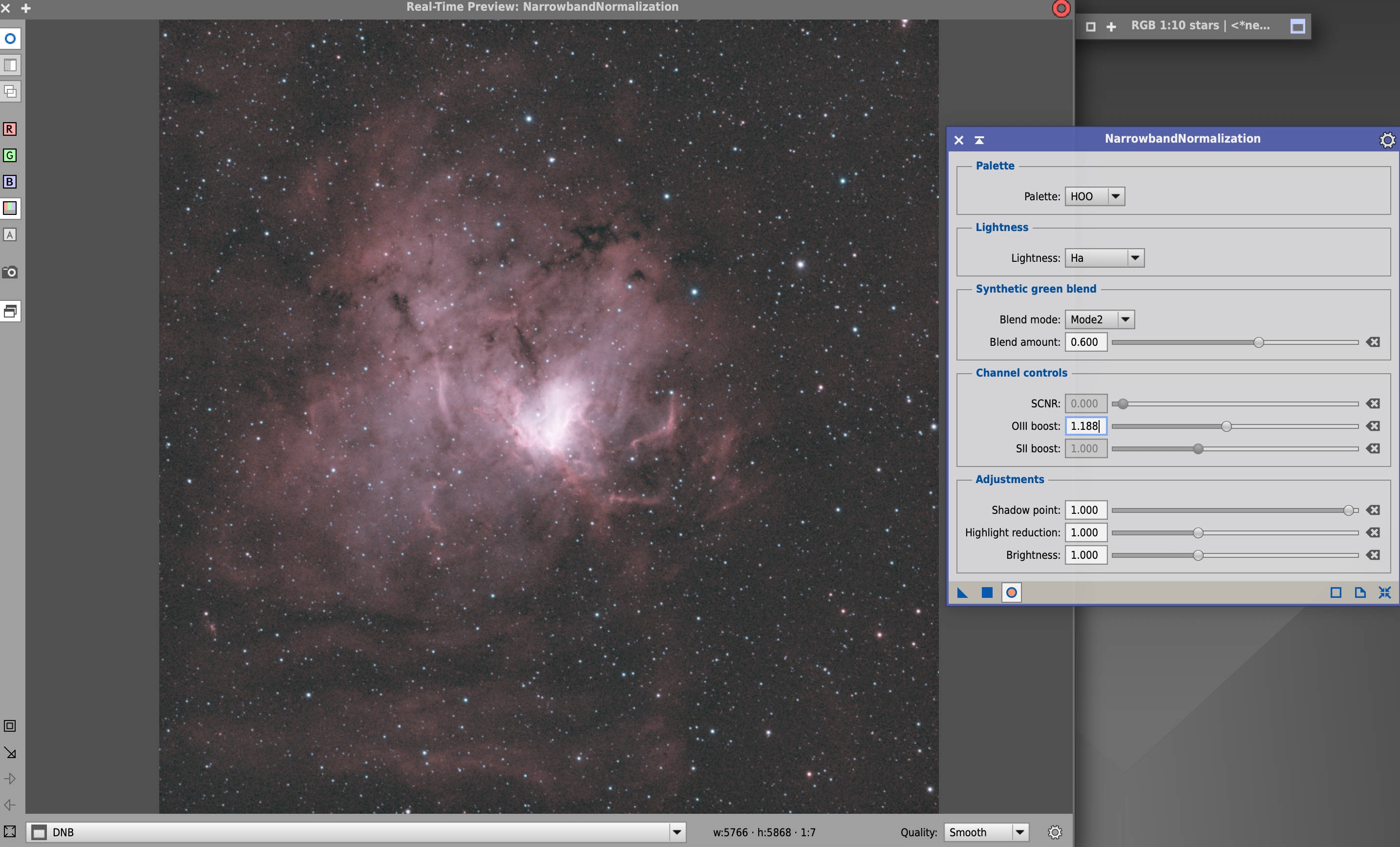

Thanks. I've used narrowband normalisation many times and am pretty familiar with it but I just can't get anything from it in this case. That suggests to me that I'm just asking far too much of the data.
This is the kind of result I usually get from a l-enhance image using narrowband normalisation:

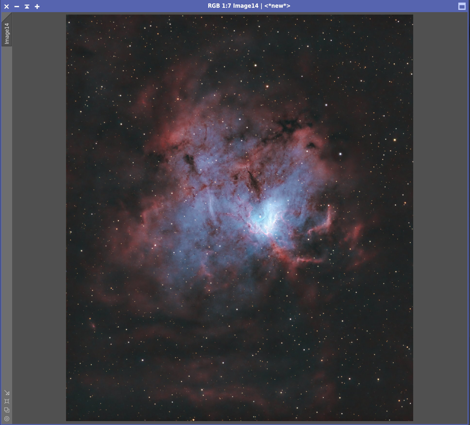

Here's what I've managed to get out of this data so far. I feel like I've taken it as far as I can so am ready to publish it on my astrobin profile but it's always wise to sleep on it and come back to it the next day. As it turns out, there was quite a lot of blue in there. I usually stretch using GHS, which is a linked stretch. I found that if I used an unlinked stretch, I could maintain the blues.Screenshot 2024-11-24 at 20.37.13.png
StewartWilliam 5.21
Craig Dixon:
Can you explain your workflow to get this, ? as it’s miles better then the first version that you posted and from not being able to get the OIII to show, this is superb…👍🏻
craigdixon1986 3.01
AstroShed:
Craig Dixon:
The earlier images were screenshots from very early on in the process so it's not really a fair comparison but here's the workflow that got me to the final image:
Gradient correction
BlurX
StarX
Unlinked stretch by Bill Blanshan
GHS to pull out a bit more
Curves for saturation, colour tweaks, etc using masks
Add in RGB stars
