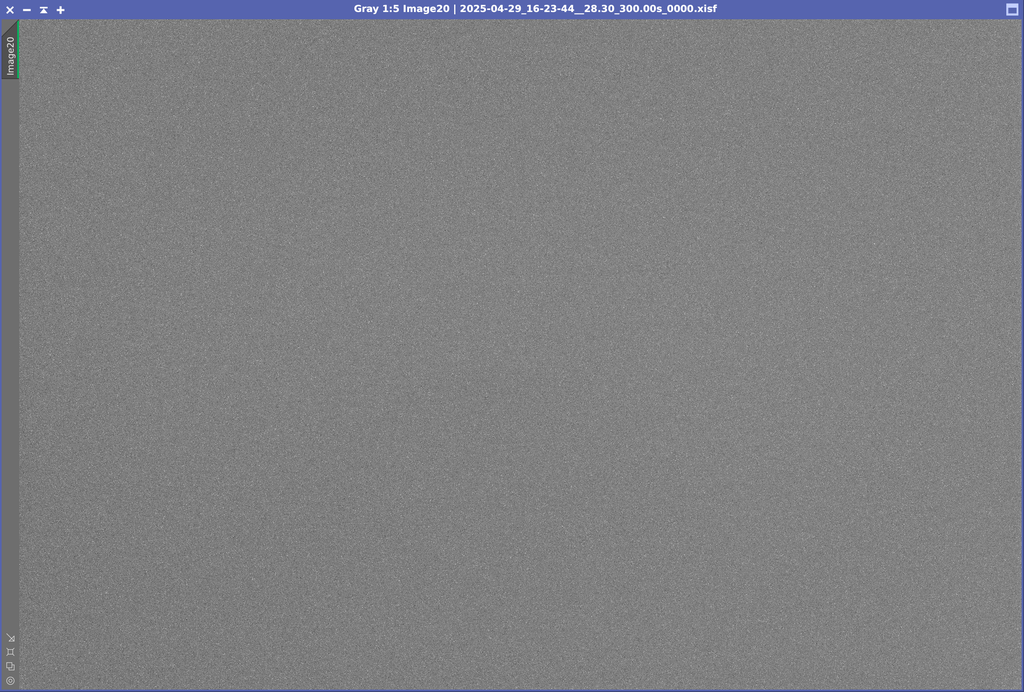

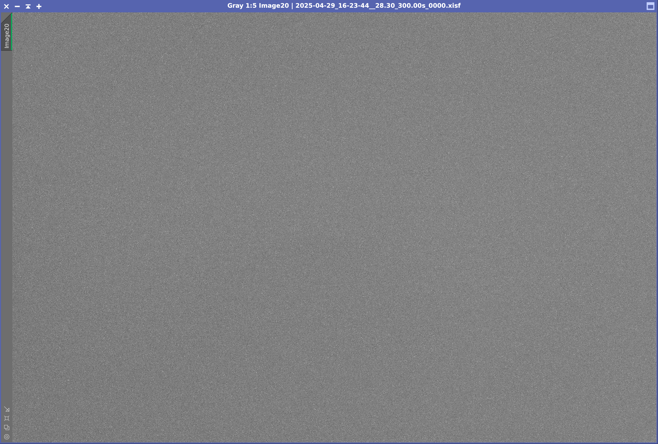

Just did a 5 minute Lightframe in direct sunlight - to "document" that there are no lightleaks in the setup.
Jolly good…

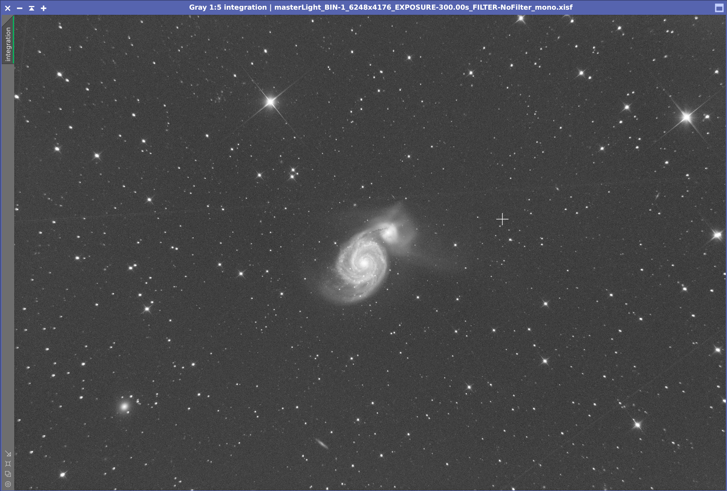

So I tried to move to a different target higher in the sky, to give myself a bit more time to work on it.
Did 5x300 seconds on M51 - and the raw Light frames came out much better. I did some "regular" Flat frames - 40% Histogram mean target.
This is the calibrated and stacked image
Not a hint of the shadow.

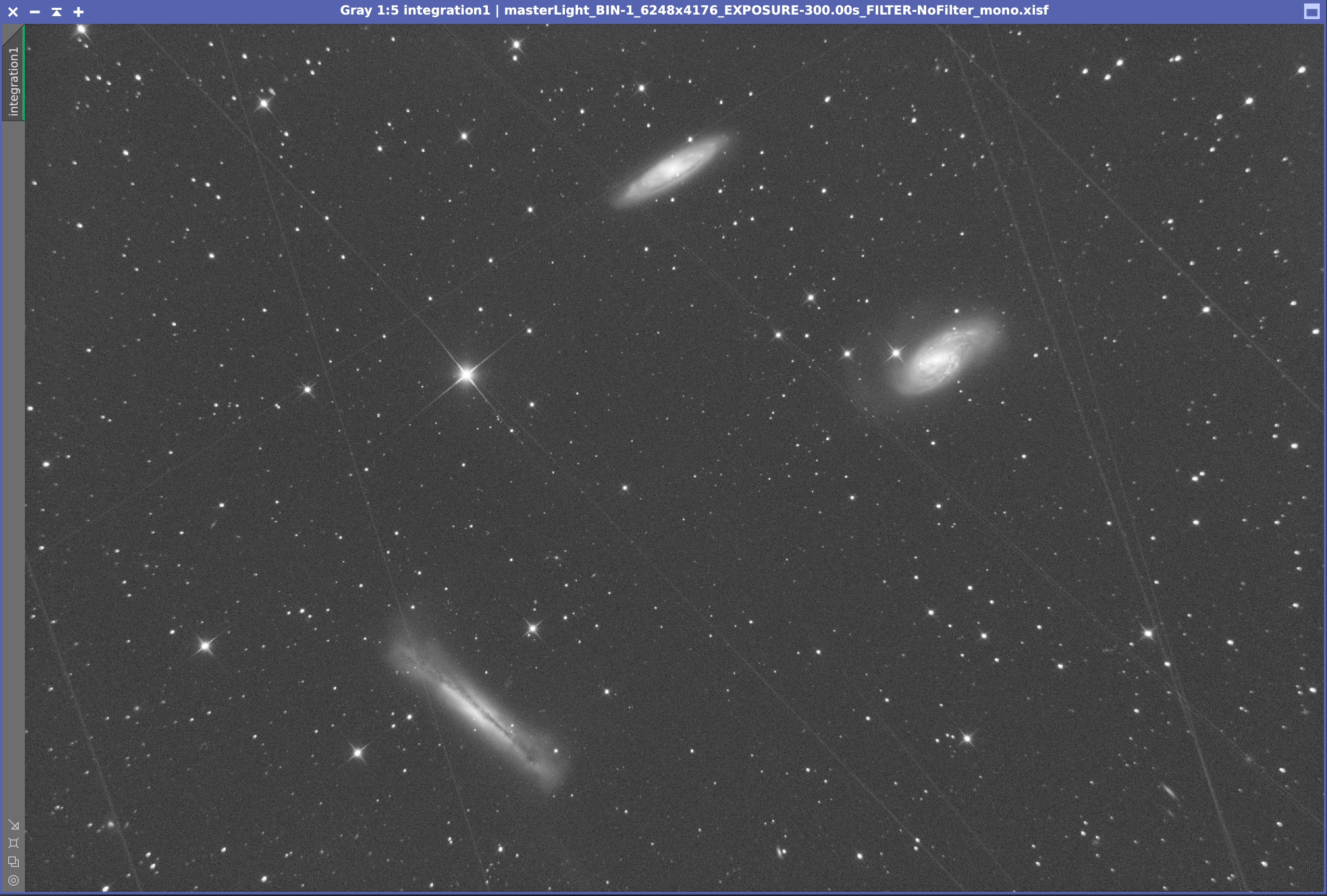

I then moved back to the Leo Triplet, did 5 images, used the same Flats and the result:
The same - not a hint of the shadow at all.
The only thing I changed today - was doing a bit of extra tucking on my "solution" to shade the gaps around my focuser tube.
This leads me to believe that previous issues must be attributed to the tiniest of light coming in along the sides of my diamond steel track 2" focuser.

Great results. I thought you had the "sock" on your focuser but apparently not enough of it.
