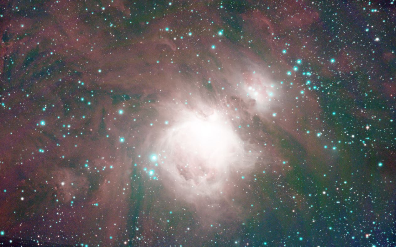

I struggled with some color artifacts in my images, thinking it was my flats that are done incorrectly.
I've done some tests with no flats and the Color artifacts are still present.
After some more testing I've realized that the Dynamic Background extraction actually adds those artifacts in. Before DBE they are not present.
Does anyone know what this could be and how to eliminate it? looks like a wrong bit depth somewhere.
I've used DBE with my own way and also with the default settings, both generate those artifacts but both a little different.

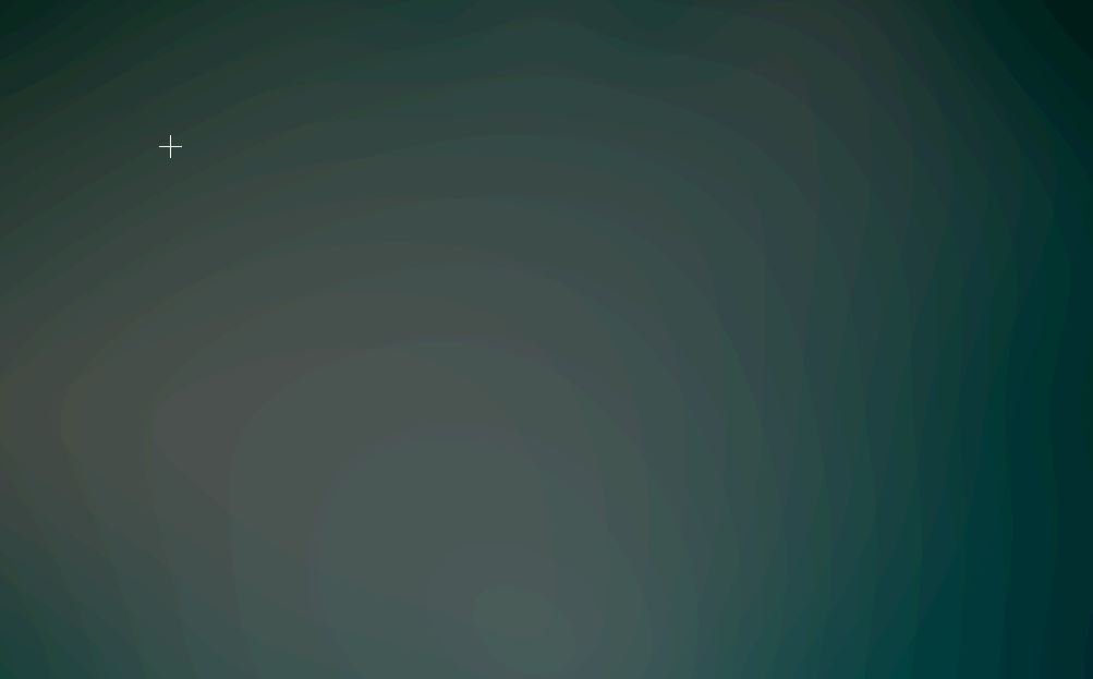

what I get after DBE (of course streched to oblivion)
What DBE gives me

I think you have other issues at play.  Look at those two images - the color artifacts in the first image are at an angle at the bottom of the image.  But, in the DBE image you posted, the lines are straight up and down (more or less).  It does not look like they line up.
I agree with what is said above - it's very hard to impossible to a good background model on an image that is all nebula.  Most just skip this step.
Is the DBE image you posted linear or an STF stretch?  If it's STF, you can choose 'use 24bit' and it should look much better.  If it's linear, you can increase the smoothing factor, which should help.
Another possible issue is:  if the thing that needs to be extracted is from a flat-based error/artifact then you MUST use division instead of subtraction.  If it's sky gradient, use subtraction.  Your issue looks like a division problem.
