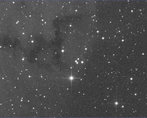

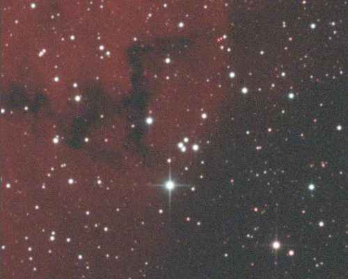

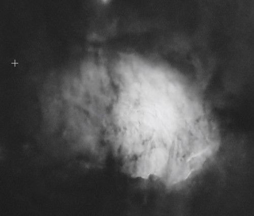

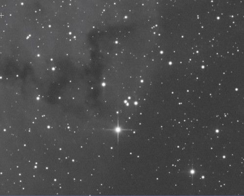

Preview before/after BlurXterminator and NoiseXterminator on RGB and Luminance:

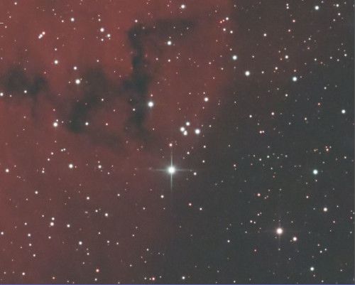

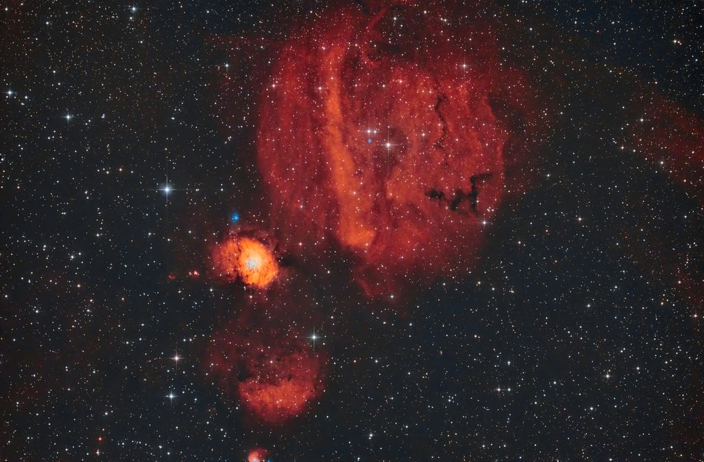

Preview of the RGB Stretched and Denoised Image:

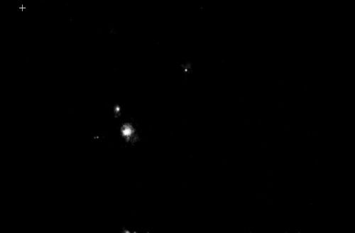

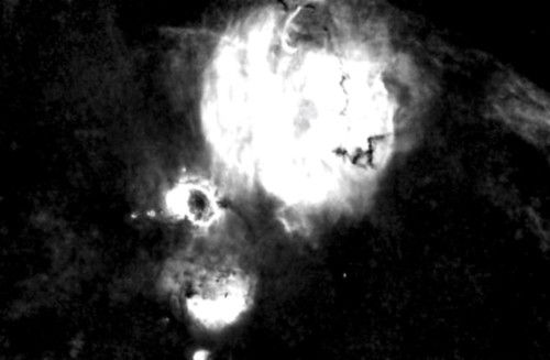

Ha and Oiii Masks:

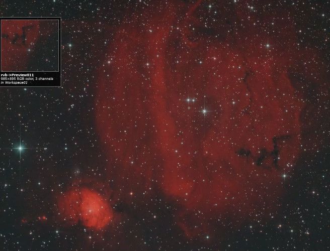

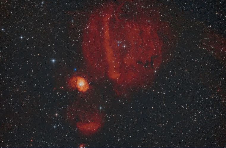

RGB Image after the Curves:

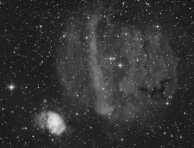

Preview of the Luminance Image Stretched and Denoised:

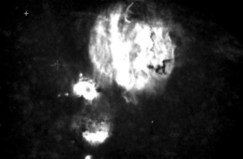

Preview of the Object Mask:

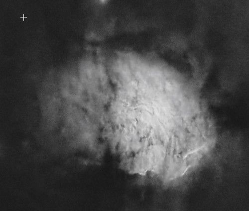

Preview of the Luminance Image before and after detail enhancement processes:

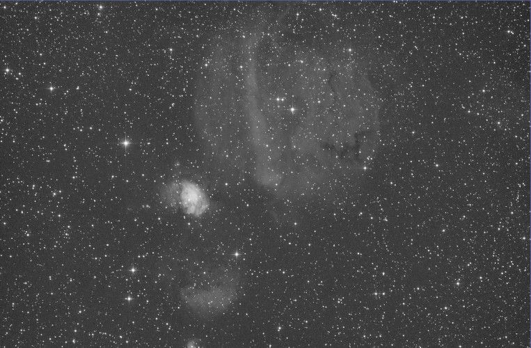

Luminance Image:

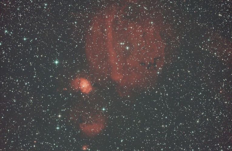

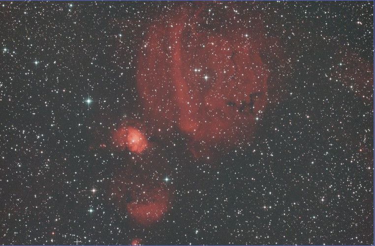

Final Image (Full version available in my gallery):
 I greatly appreciate the attention you will give to this post and hope you will be able to provide me with advice to improve my workflow.Thank you in advance, and I wish you all Clear Skies!!!
