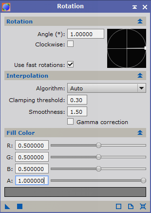

How would I go about rotating the flats please? Does this need to be done before WBPP?
No WBPP please. If you have a mono camera then the following is what you need to use:
This will rotate the flat until you nail the right rotation.
If you have an OSC camera the thing is a bit more complicated . First you need to calibrate your lights without a flat (so just darks and cosmetic correction, if you do it that way), then you debayer them. You also debayer your master flat. Now back to ImageCalibration, you just calibrate using the debayered rotated flat with the debayered lights until you see no longer the embossed shadow. Then proceed with the remainder of the process such as registering, normalization and subframe selection till you integrate that night's lights.
