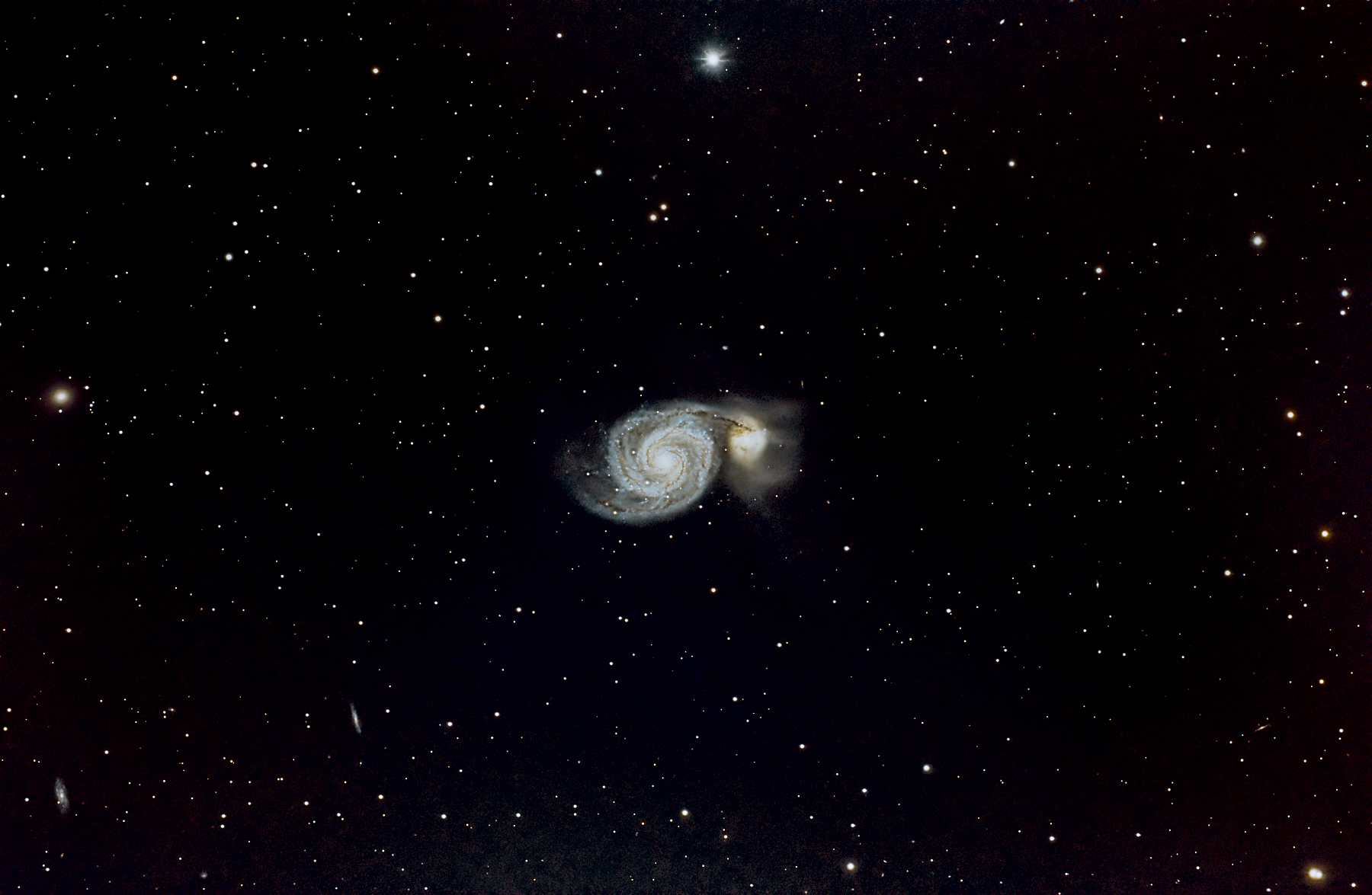

M51 03-2024I was really pleased with how this image turned out for me and would like to see other processing attempts at it. Feel free to give it a go  For reference, my version is  M51 (Whirpool Galaxy) March 2024The stacked .tif is comprised of : - 344 Lights
- 80 Flats
- 210 Darks
The one thing I feel is lacking in this image is sharpness, I'm aware that this is a function of the optics and guiding performance, however maybe someone could try running BlurXterminator on this in PI, as I don't own or use PI. For me achieving natural colours is also challenging, as the blue tones in my images always have a yellow/orange cast to them, so I usually fix this by dragging down the orange saturation in Adobe Camera raw and then masking the parts of a galaxy or nebula I know are supposed to be blueish with an unalterd layer.

For a zoom camera lens, that is a remarkably sharp image of M51.
Ohhh, zoom lens?! I thought this was from something like a 4 inch high quality triplet refractor; this is unbelievable for a zoom lens.
Not in the original, rather soft focus. Besides, isn't really fast at f/6.3.

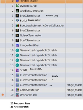

Here's my take on your data using Pixinsight. Then the second picture just has the steps I took.   |

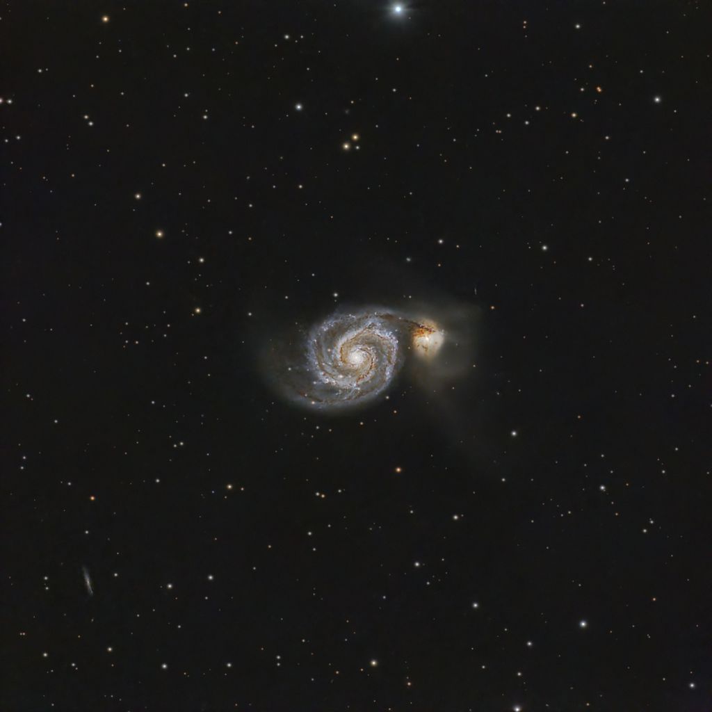

Here is my attempt:  Gotta say i would have never guessed it was a zoom lens based on the data alone. Pretty good stack i would say, the background is a bit strange though. I think you may have to go through your subs and see if there is high cloud or something like a neighbor's porch light on in some of them or something, and then get rid of those before stacking. Judging from the file name you have plenty of data to spare, so you can afford to ditch the bad subs for sure. My processing workflow was as follows: In Pixinsight: Crop, DBE, BlurXterminator in correct only, Image solver, SPCC with IMX183 settings, SCNR green at 0.5, BlurXterminator again with stars at 0.15 and nonstellar at 0.8 with correct only unticked. Asinh stretch at 1000, slight histogram transformation and exported as 16-bit TIFF for Photoshop. In Photoshop: Downsampled the image a little bit, StarXterminator, work on the starless layer and star layer separately finalizing the level of stretch. NoiseXterminator at a few different points. Smart sharpen applied to both layers at slightly different settings. Saturation increased to my taste and exported as the JPEG above. You should consider getting PixInsight for BlurXterminator alone, it really is a match made in heaven for galaxy images.

Quinn Groessl: Here's my take on your data using Pixinsight. Then the second picture just has the steps I took.  I think this one by far is one of my favorite! Thanks for listing all the steps it will be helpful for me to follow the workflow whenever I invest in PixInsight and am on the learning curve. Honestly I'm fully convinced at what @Oskari Nikkinen stated, I would never have thought I had this much potential out of this image. The brown central dust lanes were really difficult for me to achieve in Photoshop. Great edit! thanks for sharing.

Oskari Nikkinen: Here is my attempt:
You should consider getting PixInsight for BlurXterminator alone, it really is a match made in heaven for galaxy images. Thank you! With enough careful focusing and low enough HFR values across my subs I was able to get some pretty clean data. To your comment regarding bad subs, I will admit I'm one of those integration addicts that probably hoards onto bad subs when I could still stand to cull some. While I pulled out all the subs with bad shaped stars from my collection, there are probably a few in there that were taken with high cloud cover. Also my sky towards the north is generally more light polluted that towards the south. Fun fact, I actually completed work recently on a little side project where I developed a Python script to parse my sub file names and sort by starcount and hfr, then rename the subs with a quality rating based on that and a 4-digit serial number. I really love the blue color you were able to achieve and I feel is the most accurate, I assume this was because of SPCC in PI? Photometric Color Correction? Glad to see that some people still use Photoshop as a compliment to the processing workflow and not exclusively PI. I'm one of those people who have always had the lingering thought "can't I execute the same basic processing functions in photoshop, so what's the point of ever venturing into PI?" however I know PI has vastly more functions that are tailored specifically towards an astrophotography workflow. Thanks for processing and sharing! Fabian
Fabian Butkovich: I think this one by far is one of my favorite! Thanks for listing all the steps it will be helpful for me to follow the workflow whenever I invest in PixInsight and am on the learning curve. Honestly I'm fully convinced at what @Oskari Nikkinen stated, I would never have thought I had this much potential out of this image. The brown central dust lanes were really difficult for me to achieve in Photoshop.
Great edit! thanks for sharing. Thanks, I appreciate that. Pixinsight was a game changer for me. I started using DSS and GIMP and really struggled. The complexity of Pixinsight scares people off, but once you get a workflow down, it's really fun to use. RC Astro's tools certainly make things simpler, but there are free alternatives to them. That's not to say Pixinsight is magic though, I still struggle sometimes with some datasets. Then another thing I think I could really improve upon is the background in a lot of my images. I'm good at not clipping blacks like a lot of people struggle with, but I find it difficult sometimes to get a nice even background. Then other times I want to get that red Ha background you see a lot in IOTD images, but I've never quite figured that out. I think part of it is my process. Then I'm not sure, but I think using ZWO's filters make that a bit more difficult to do as well.
